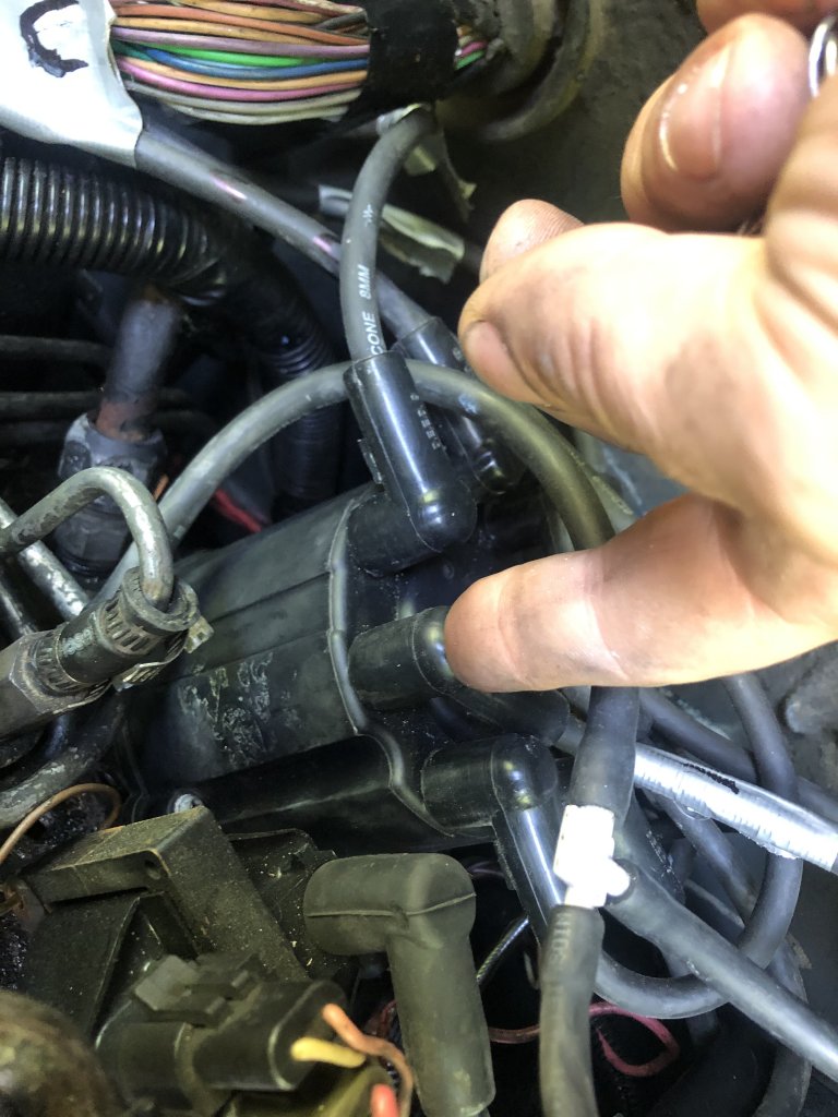

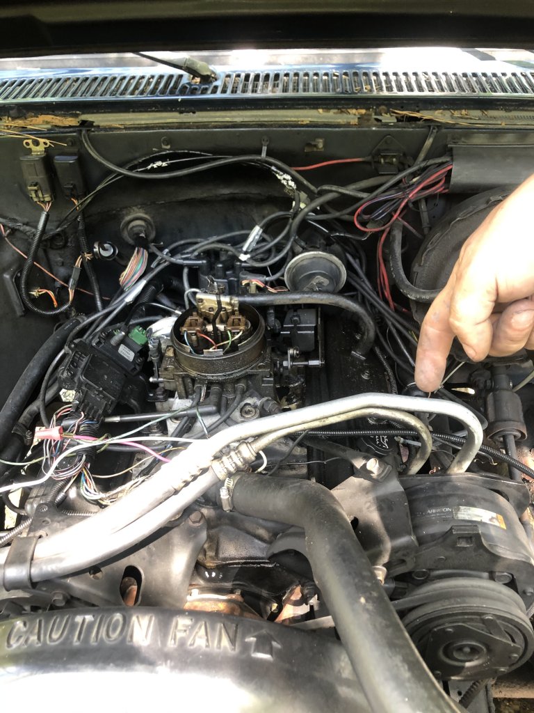

Whereabouts do I look for spark?
For clarity this is the number one spark plug correct? It goes to the first place on right on the engine closet to the fan on second pic

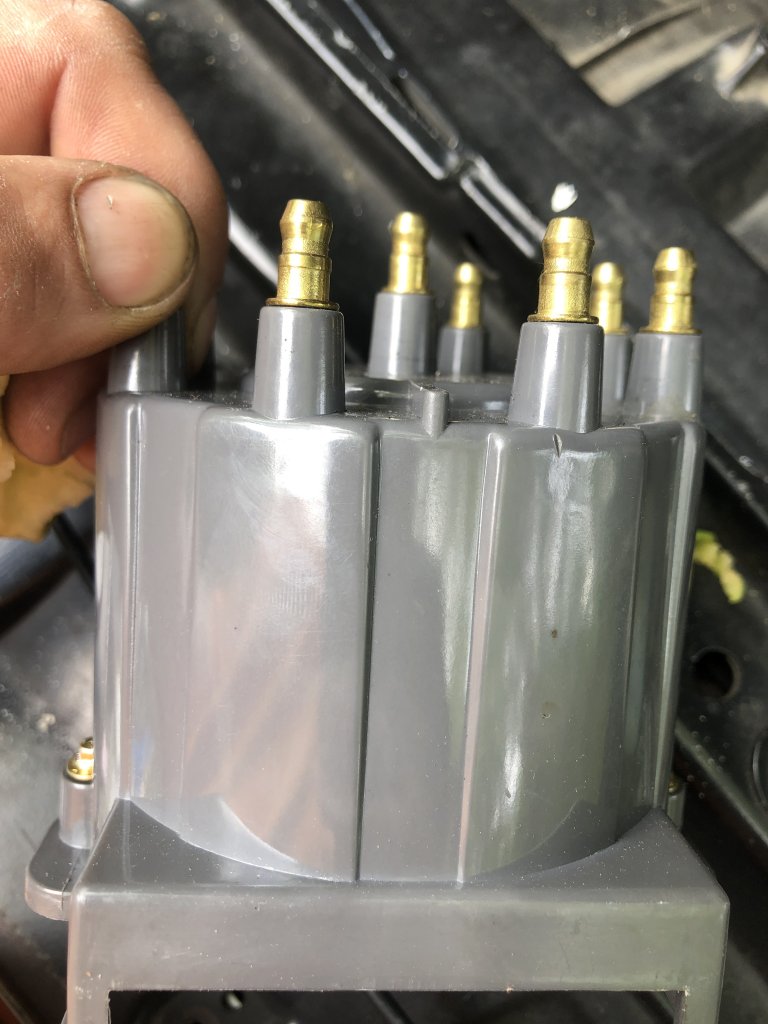

Maybe I just need a new cap I had a new one lying around
