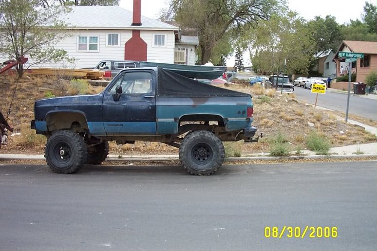

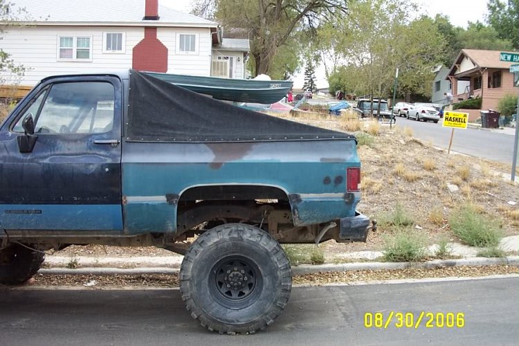

6'' suspension 3'' body lift 38x12.50 tires
I had to twist it pretty hard to get the tires to rub they were only 12.50's on 9.75 wide wheels so not real wide
for a pavement pounder I think you could clear 38.s
