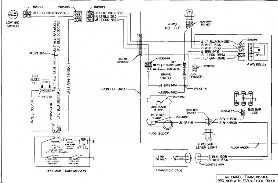

here is the wiring diagram with EGR bleed since I am betting that is what you have.

Based on that picture what I am calling the EGR module would actually be the solenoid, because it lines up with that diagram.

Unplug the connector at the low vac switch. See if shudder goes away.
