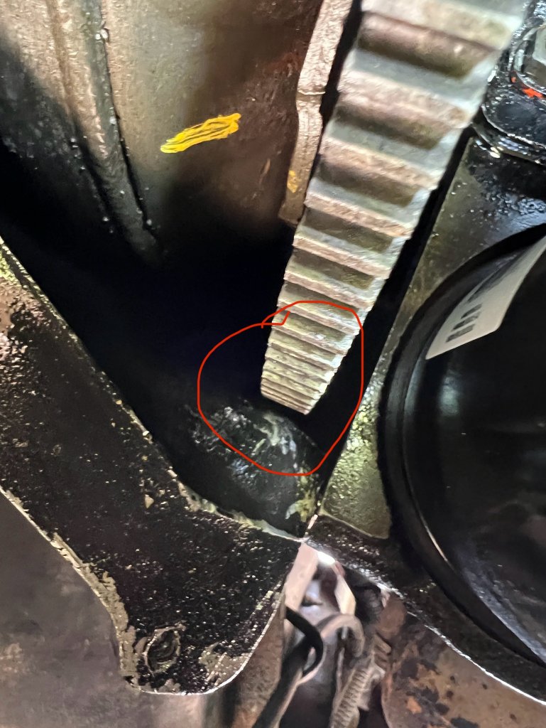

It’s had a pretty good intermittent rattle when under decent acceleration that I have assumed might be broken blades in the torque converter. at least that is where the sound seems to be coming from. I Finally got around to looking at it yesterday and unbolted the converter from the flex plate to see if I could isolate if it was coming from either the flex plate or the torque converter.
Flex plate is not cracked, but it is definitely warped and I will be replacing that. but I noticed that there is less than 1/16 of an inch clearance between the flex plate and the bell housing.
what is normal for this?
The wobble on the flex plate with that small amount of clearance could give some grinding I guess. There’s a bit of paint missing on the housing, but it doesn’t look horrible and the teeth look OK. Can anyone tell me what that clearance should be?
or another possibility is the wobbling flex plate is making contact with the starter at higher RPM. Picture of that attached.

If you know the flexplate is warped, questioning clearance to t/c or anything else, would be moot for me.

Does the gap change with the engine barred over in different positions? That could indicate there is a runout problem with the crankshaft.
I don't believe the overall diameter of the flexplates really changed if that is your concern. There was differences with them, with 1 and 2 piece rear seal models along with tooth counts.
Are you going to install new mounting screws with the new flexplate?
Looks like you still have a pretty good leak back there.

yeah, it’s still leaking. It’s better than it was when i got it by far but I’m gonna have to address it again.
I’m getting very different suggestions from Summit, rock auto and O’Reilly on the flexplate size. based on the block information and the transmission, summit is saying a 153 tooth and everywhere else a 168 tooth. 168 tooth is what is on there now.
Probably won’t get to look at it until next weekend, but I’ll turn it over and see what it looks like
