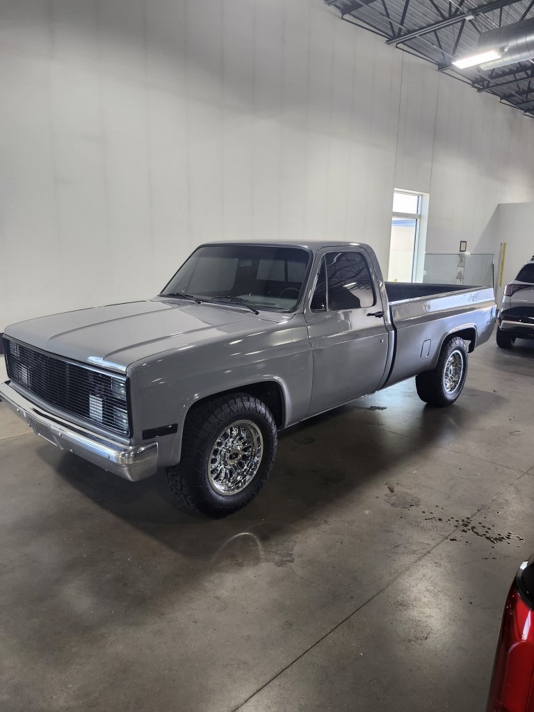

Thank y'all so much for the input and advice. After talking with some local old school race track from the 80s guys im going to go with rebuilding the 350 and rebuilding the rear end. It will take me all winter, but didn't plan on driving it in the snow and mad chloride roads of Colorado anyway. I will keep updating post and photos.
Also to add, the color is " Nardo Grey" its an Audi color

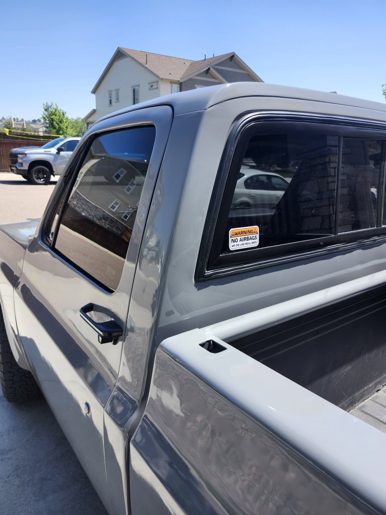

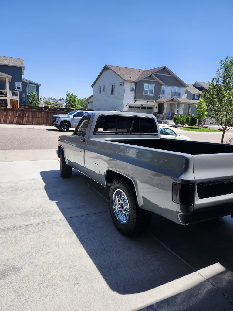

Got the windows tinted today. Just a few more weeks of enjoying the summer drives and then ill start the motor rebuild
