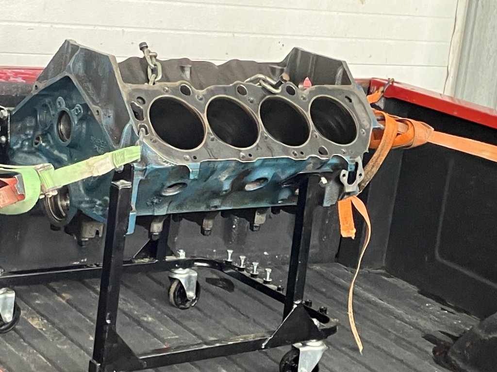

I swapped my broke 350 for my circle track 350. I to am a farmer/rancher, and hauled hay to customers. The 350 did ok, but I found a Mark lV 454, and never looked back. The 454 get slightly less mileage than the 350, but the torque and power, I’m hooked, and if you tow, no comparison between the two.

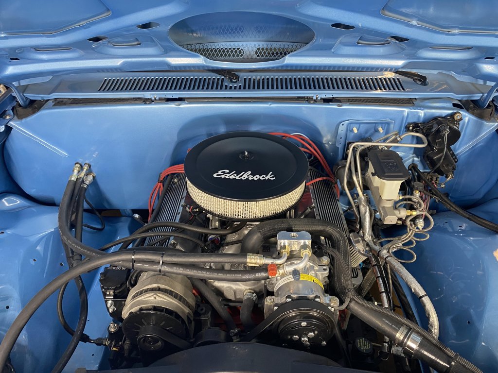

I just finished putting a Gen VI 454 in mine. There's plenty of room in the engine bay, firewall clearance, steering, etc. I used Chevelle headers but had to modify one tube on the driver's side to clear the frame. BBC stock manifolds would probably be better. Summit BBC oil pan did not clear my 4x4 front crossmember. Maybe a stock pan would clear, but I did a bolt-in high clearance crossmember from Offroad Design. Not sure what you want to use for a trans, but a 4L80e is longer so the trans crossmember needs to move back a bit. Water pump and fan sit further forward so the smallblock fan shroud may not work. Aside from those couple things it was pretty easy and works well.

Man that’s clean good install brother
