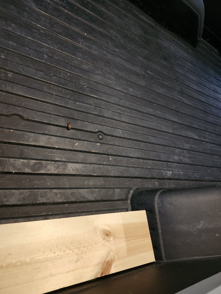

I have a turbo 400 transmission.
I was hoping for some opinions on doing a wood bed? I know its not an 80s thing. Just wanted to add something different. Rhino the sides with black and then walnut stained southern yellow pine on the bed with stainless steel in the seems

The wood floor beds are awesome. In my opinion, I would use a hardwood like white Oak. I've owned a few and the hardwood held up fine. Had an old Ford step side with a pine floor and it rotted rather quickly. Use boiled linseed oil to help preserve.

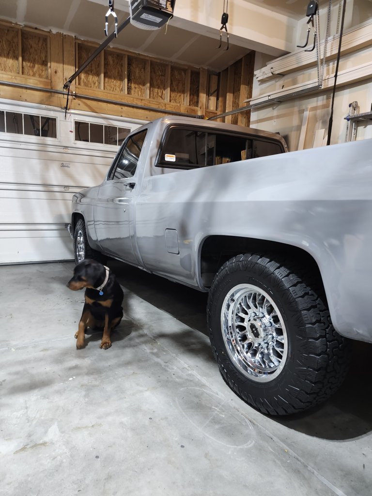

Parking it for winter and start the motor rebuild next week

Keep us updated!
