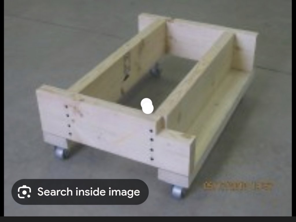

I'm tired,been up ALL night not going to the shop to take pictures for you. So look at this Pic from the internet. I built some of these,similiar not identical. By the front and rear boards being wider than the other two boards,it keeps the long boards from being able to tip side to side. Where he has boards with wheels running the length of the engine,I ran my boards (2×6s) width wise so it was more of a square less of a rectangle and about the same width as the valve covers for more stability. Put the 2x6s so they screw to the end board and the side boards so they hold the corners square. Build some similiar to the pic with the mods I mentioned. Screw it to a pallet or piece of plywood and put 4 tie down d rings on the plywoid or pallet. Tie engine at each corner and it's going nowhere. When you are done take the cradle off the plywood and put casters on the 2x6s for a rolling engine cradle. That's why I built them,so I can roll all my engines around without getting the cherry picker.

Thanks guys I’m bad about over thinking things. Ricko thanks that’s a lot better idea than what I had in my mind. I’ve got a lot of scrap 4x4,2x6 and 2x8 so I should be able to make that no problem. Better than my thinking of making a couple rails for the motor mounts to bolt to.
