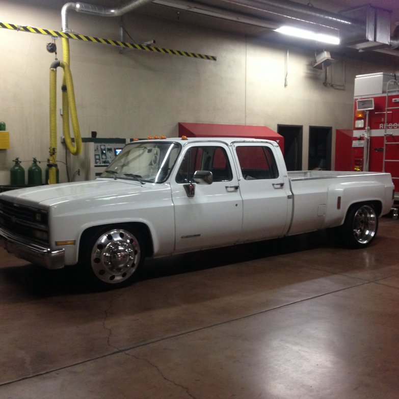

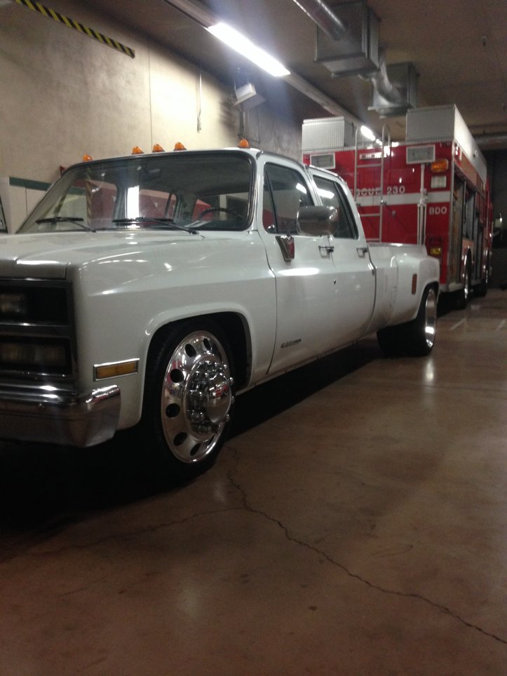

5/6 static dropped dually, complete.... sorta
johnnydefacto
Feb 4, 2016
62
1989
C30 Dually 3+3
Front:
3" Bell tech spindles
2" springs (looks like i only got about 1.5" from them, I am guessing my stock springs were tired)
Nitro 2 drop shocks
Rear:
4" Hangers, 4" shackles from Western Chassis
Drop shocks from Western Chassis
Overload spring removed, 4 leafs removed from pack
Got about 6"
Tennessee Wheel and Tire TowNasty's 22.5, 235/40R22.5 tires, Running stock inner dually wheel and tire set up 215/85R16.
Rear Gear swap now has Yukon 3.54's instead of the 4.10's
Sanderson Headers, dual Magnaflow 24" mufflers (up and over the axle)
She is far from complete, but she is very close.
Still need window tint, paint, figure out the rear helper bag situation, front grill and lights, and figure out a few little electrical issues.
Thanks for all your help on this forum, I could not have done it without you guys holding my hand all the way.

looks good @johnnydefacto :waytogo: Do you have a build thread on here?
31,892
32,695
So you can actually get low-profile light truck tires in a 22.5 now? In the past, didn't you have to get the rims turned down to fit 22's?

100% bitchin!!!

Badazz for sure..

Freakin Cool!!:cheers:

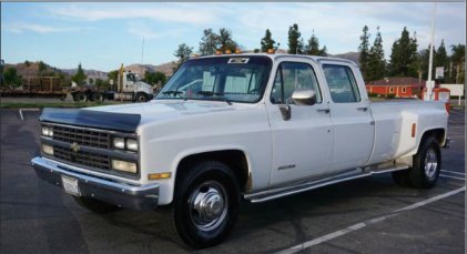

So... I gotta be that guy. I honestly hate the look. I recognize the quality of work, and I think you did a good job. But to me this is like donking a Caprice. The first picture is a beautiful truck. The others... wow I honestly cannot describe the blah factor. There's a guy in town with a newer dually just like that. Driving down the road it just looks silly.
But hey. To each his own. It looks like you did a good job so kudos there.
All that aside, wanna sell the old running boards? lol

Looks fantastic! Low, mean and s-w-e-e-t...!!
(But then again...I am a fellow belly scraper...lol)

Looks awesome, it's perfect.. IMO...:waytogo::cheers:
