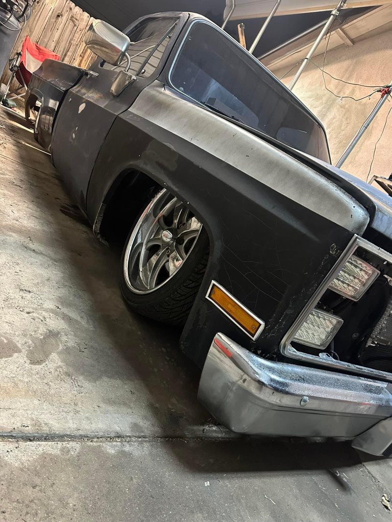

I finally got it “running” I’m able to drive it but my transmission isn’t shifting.
When I drive It does high revs the rpm gauge goes high and no sign of shifting

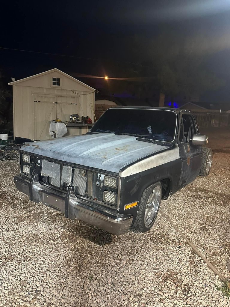

Another picture
