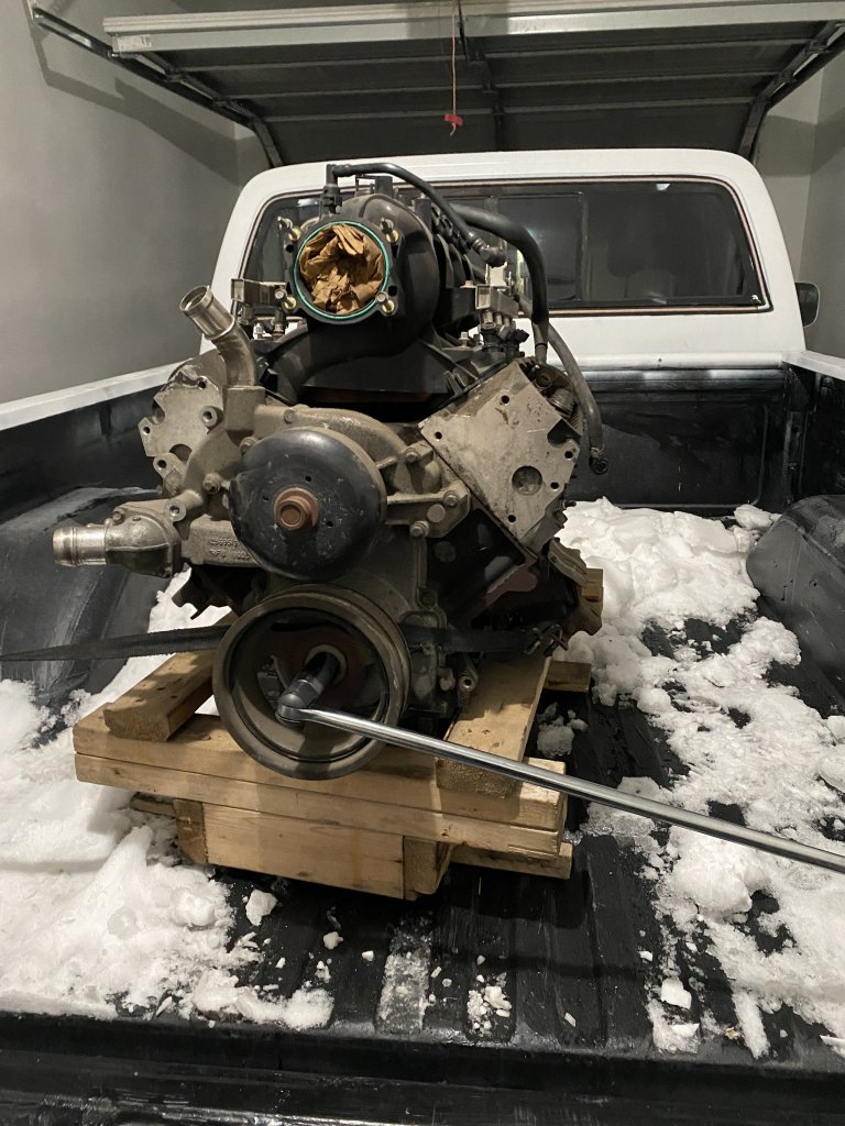

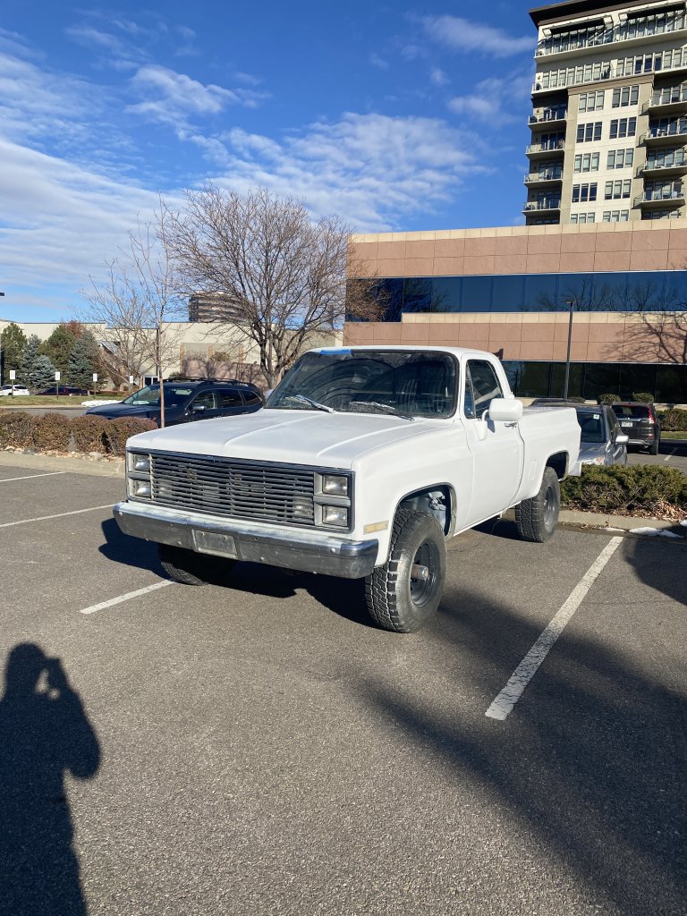

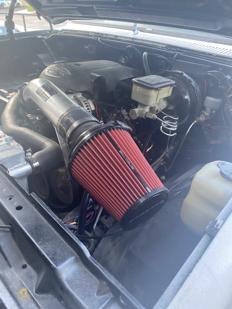

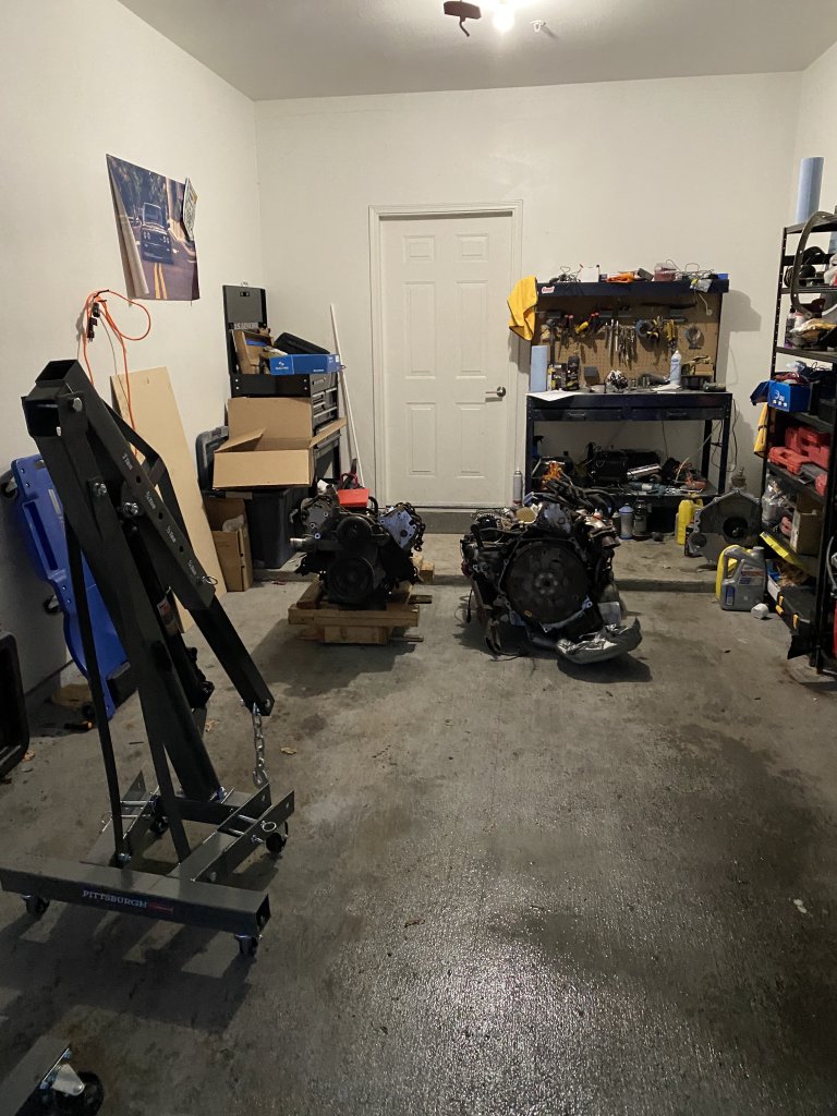

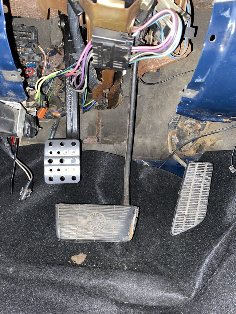

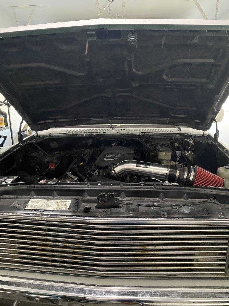

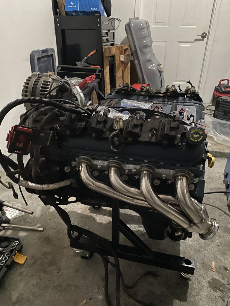

Installing a 2005 5.3L and 94’ NV4500 into my K10.

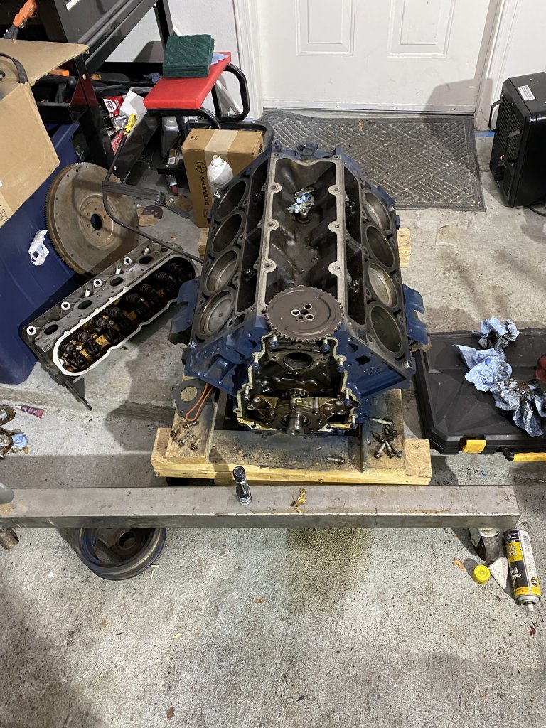

Bought a good long block for $100, a rusty locked up 99 with everything to swap over for $400.
Sold the rusty block for $350 and the spare heads for $150.
$500 NV4500 from a 94’ part out. Sold the bell housing for $350.
Into the swap for almost nothing so far. However all the new parts will definitely add up.

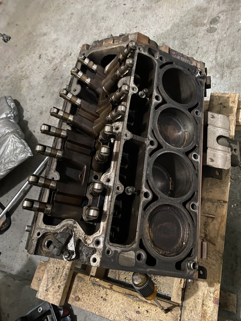

Cam and one lifter was bad on the 05, going with a BTR stage 2 and new lifters, pushrods and camshaft bearings.

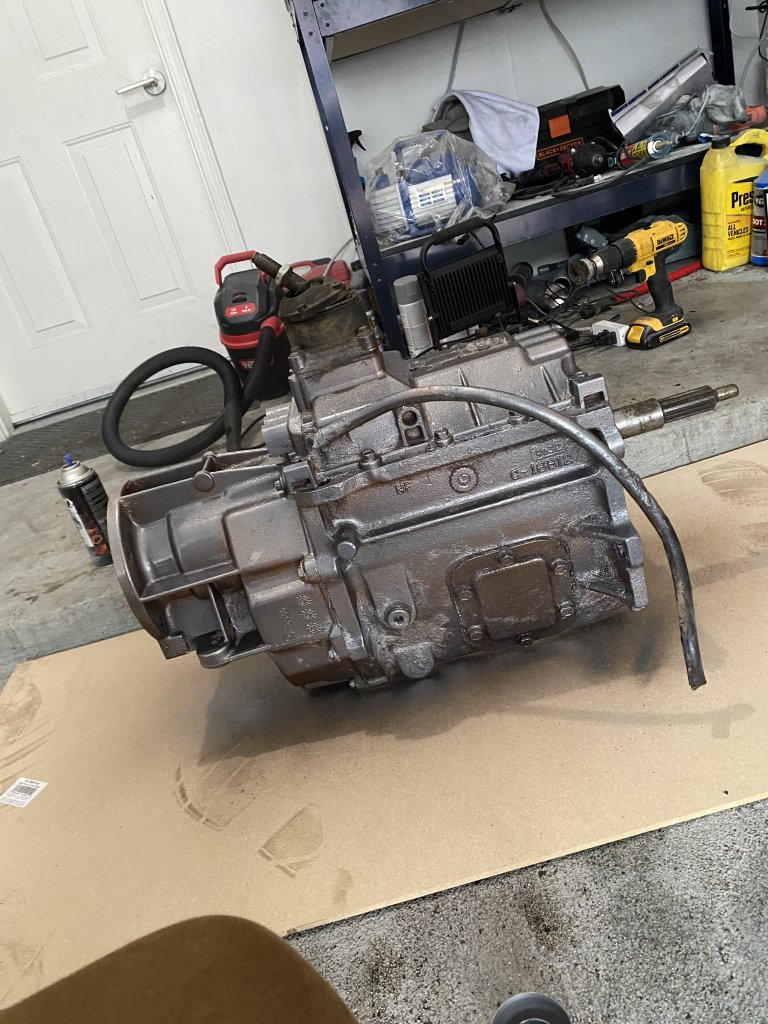

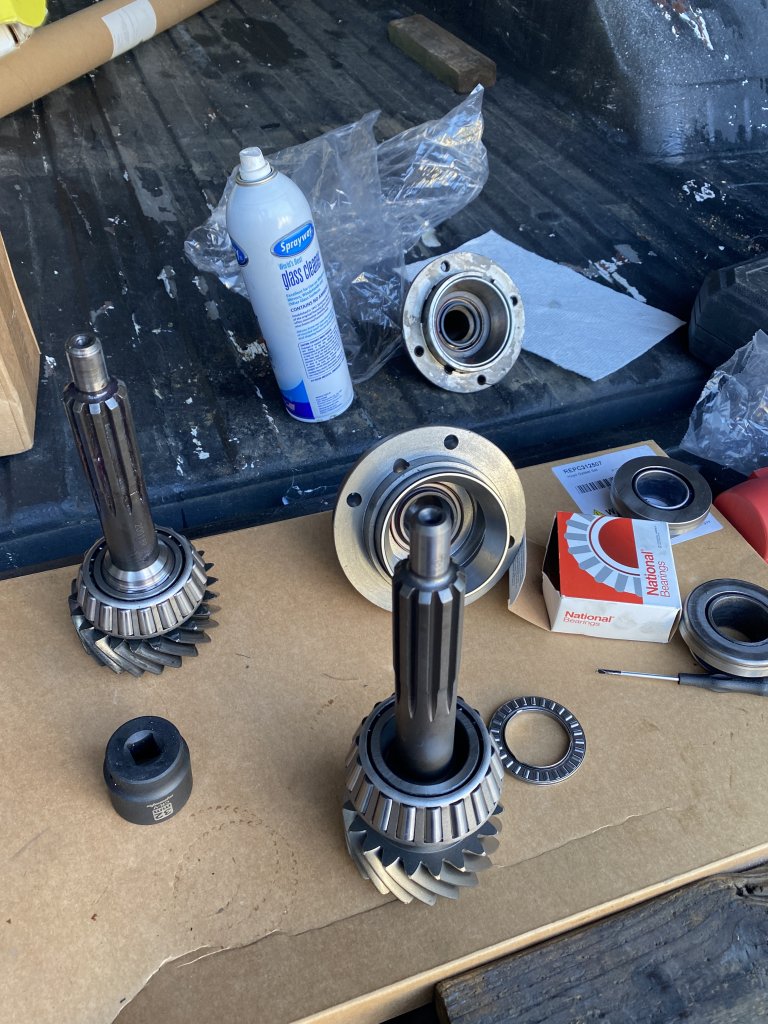

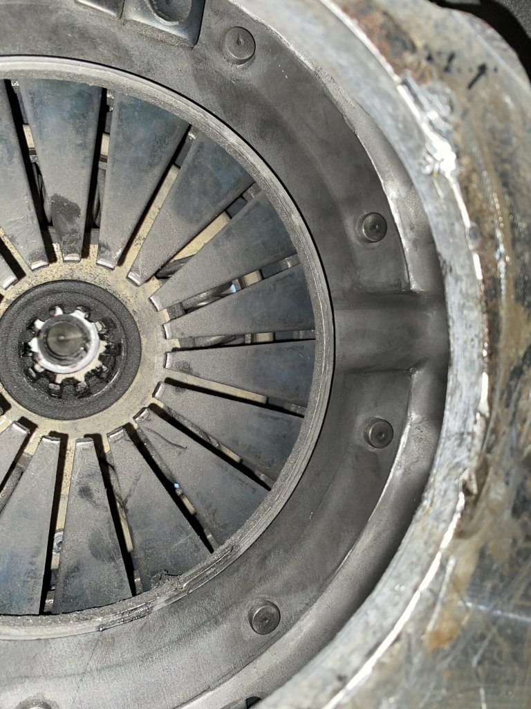

NV4500 got the AA adapter, waiting on fluid atm and havnt inspected the internals. The OO said it shifted perfectly fine and tbh I trust the fella.
My NP208 needs the splines swapped out, or I need to find a 32 spline NP208 that isn’t extremely expensive near Denver.
bought all the 87’ EFI stuff with a corvette fuel pressure regulator and a Walbro 255lph pump. Thinking of going AN but havnt decided what brand.

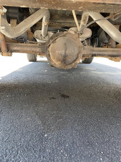

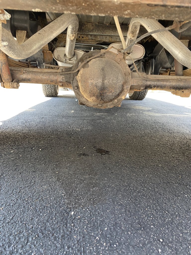

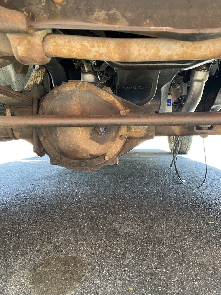

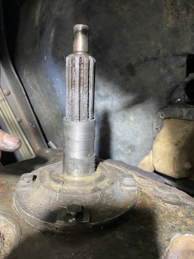

I have 3.08 gears and 31” tires, the NV should be fine moving the truck but I’m thinking I’d want gears closer to 3.4/3.7. I mostly do just city or long highway drives so there’s not a perfect gear it’s going to have to be a middle ground.
I have a local shop that I want to do paint/body work quoting me 3k to do the swap, minus the value of my engine and trans because they’ll buy them off me for other projects. I have a supposedly built 700R4 with a shift kit and a rebuilt low mileage 305/350 (don’t know which). What should I expect? I was thinking I could sell them for $700 minimum.
This is my second LS swap but the first never got finished prior to selling it so I’m looking forward to getting this done right.
