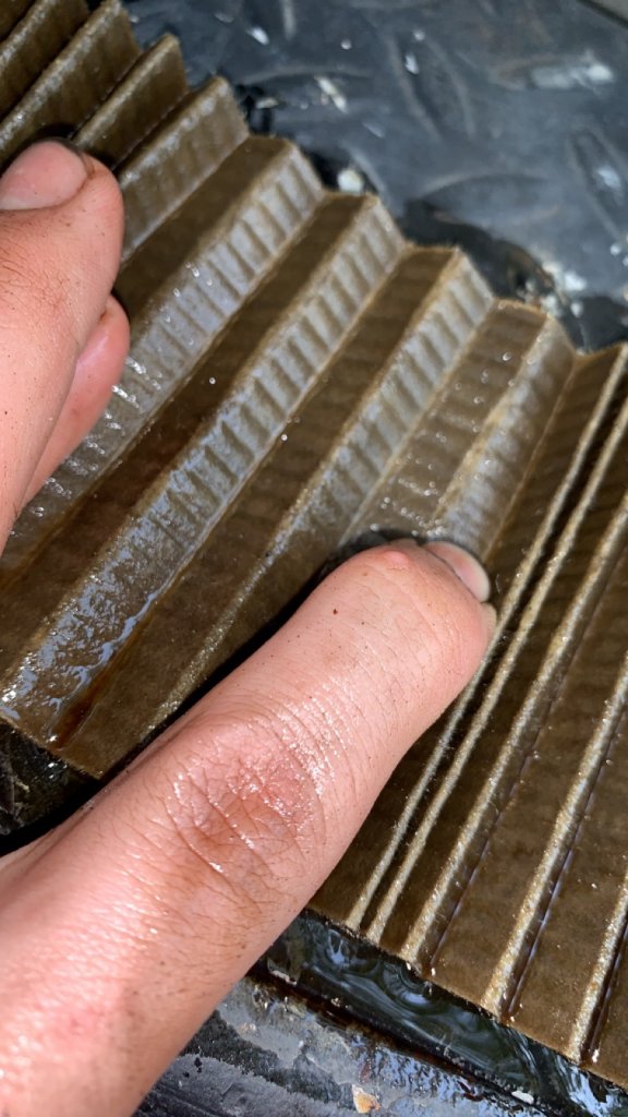

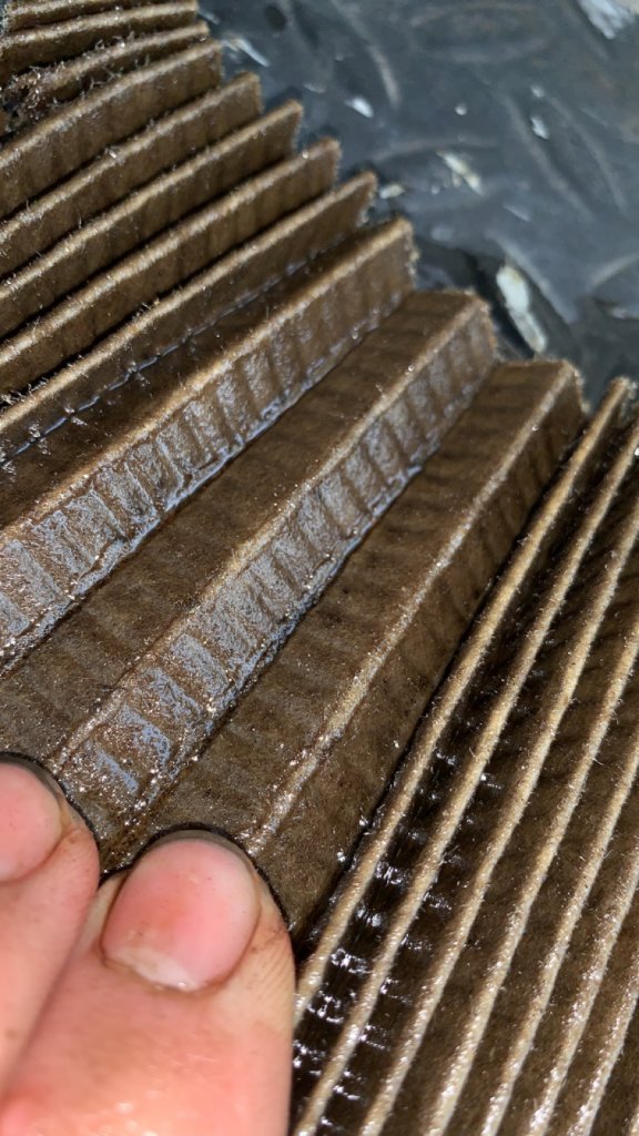

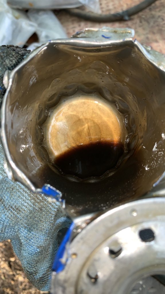

Here’s the filter, I’ve got it all back assembled about to refill with oil. Does the short/tall filter make a difference? I saw somewhere it did and I had the taller filter. I also noticed 08/22/05 on the inside of the oil pan, so the engine must be from 05? Just with an older ecu? I thought it was drive by wire by 05 lol

The filter does not look great to me. What are the particles in it? Paint, aluminum maybe? Normally, you will not find anything with the naked eye, other than what may have been introduced during a sloppy service or oil top up. Possibly mishandling from the previous owner or was the engine pulled from a wreck?
Since you have cleaned everything now, you have established yourself a new base line. If you are internally making debris, a major failure is more than likely imminent.
I normally wouldn't recommend a muffler shop for engine diagnostics, but checking oil pressure with a mechanical gauge is not very technical and a lot of muffler shops have guys capable. You may want to ask them if they have the resources to do so if you do not. The fluctuation in your gauge could be a flag and would be a concern for me.

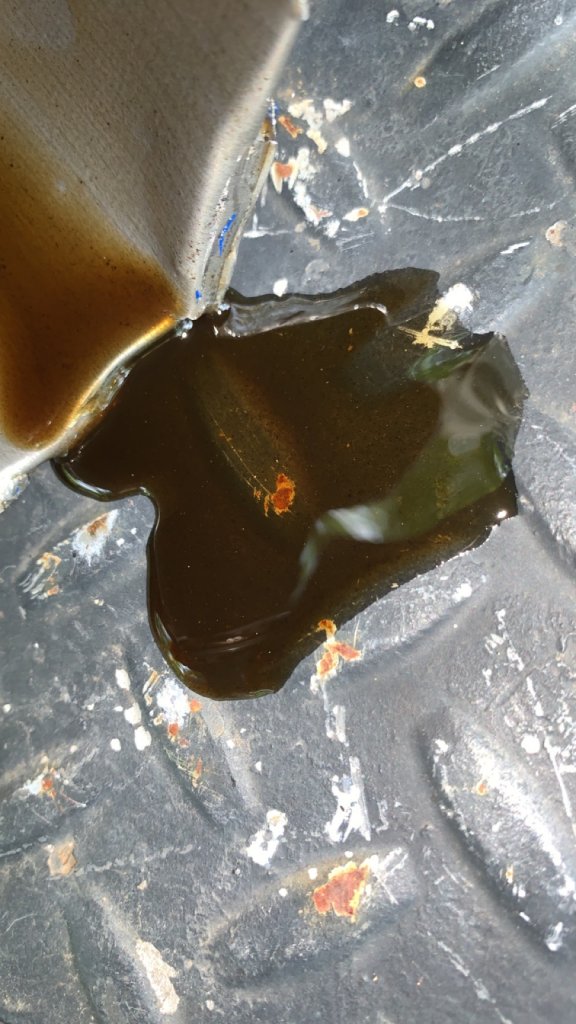

The junk on the filter could be sludge? There was a little bit in the very bottom but other wise the engine was clean. I did get some paint inside of it from cutting the filter open. The oil was very black despise only having 100 miles on it. There was a slight metallic inside the filter but nothing major it didn’t look like glitter or anything just the occasional shiny flake.
Edit: the magnetic tip on the drain plug did have a small amount of buildup on it, I cleaned it before reinstallation

With unknown hours on past service intervals, a bit of sludge would not be a big concern. It's the particles and fluctuating gauge that would for me.
As mentioned the pressure is not great but within spec. Aluminum and other bearing material will not stick to the magnet. The filter catches it before entering the main oil gallery.
Filters are cheep. Cut another open not too far down the road to see if you are making more. If it is clean, spin another on and carry on.
