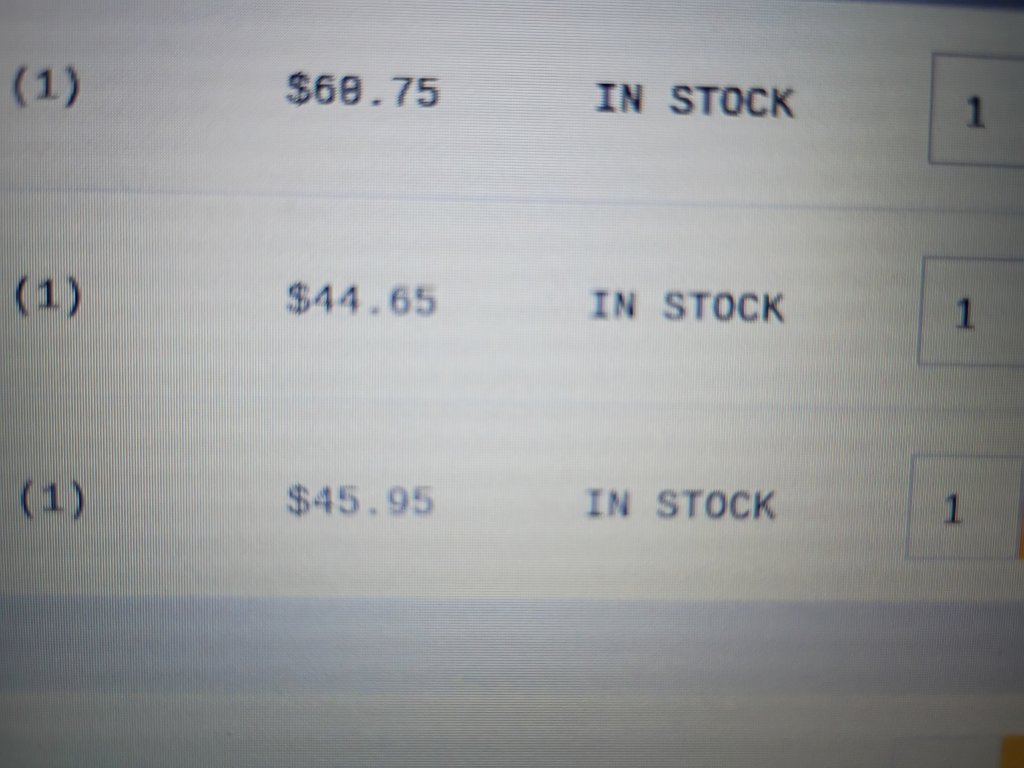

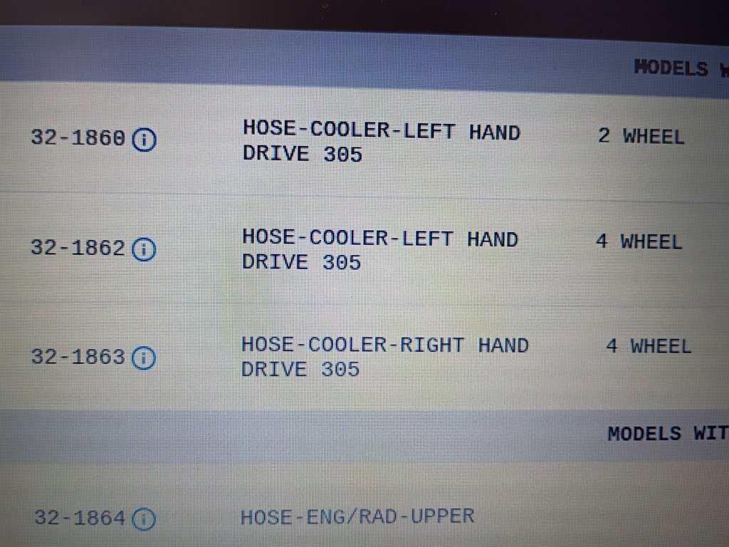

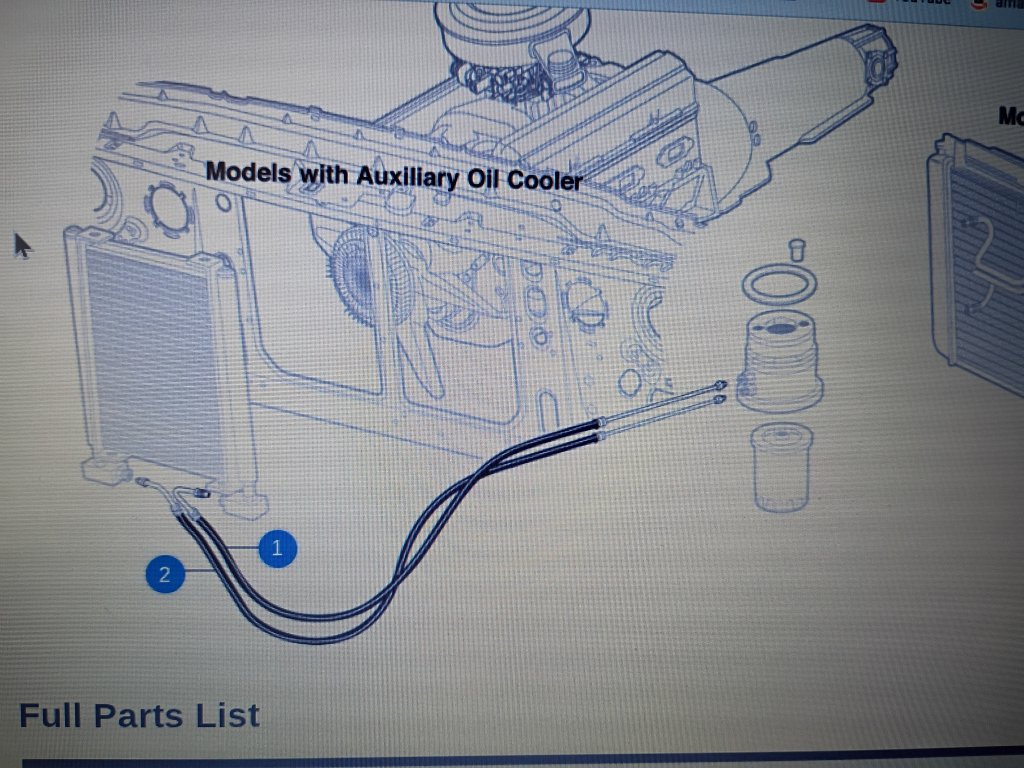

Has anyone used these from LKC? The site says for 4wd, but will it work on a 2wd with factory cooler? Line ends where they connect to the radiator look to be on a different angle than where mine mount
