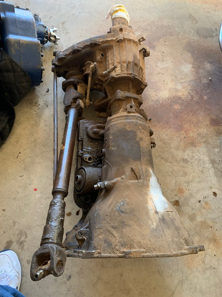

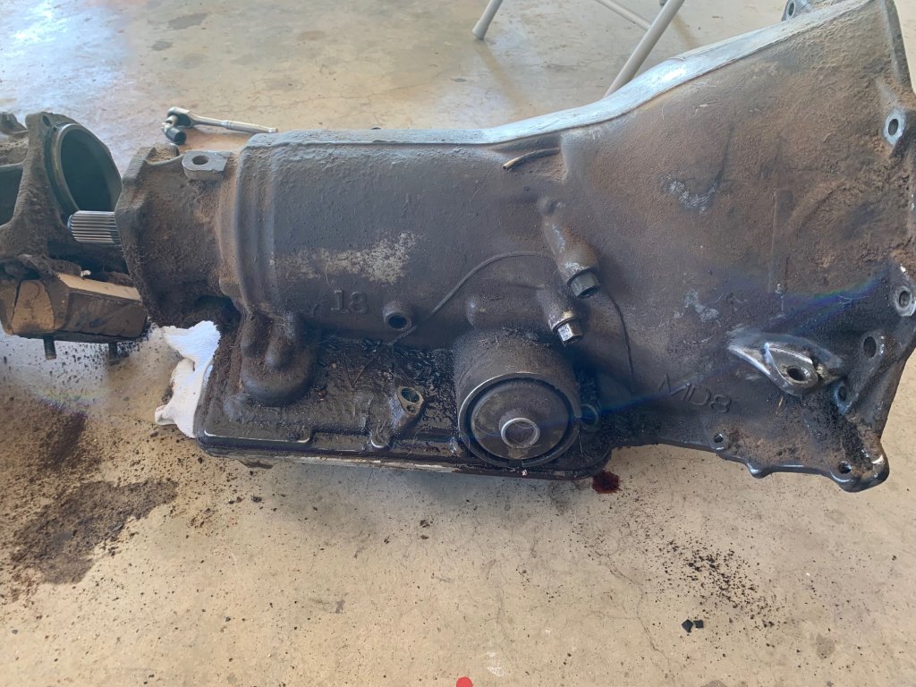

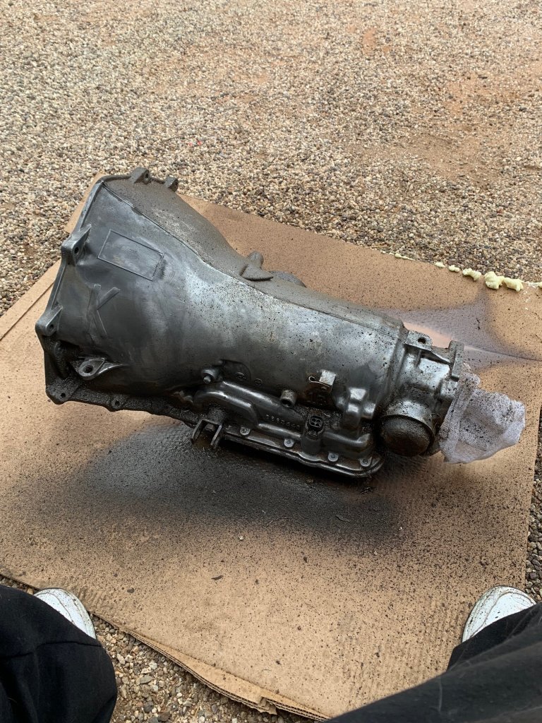

I recently found an NP241 transfer case and tranny off an 89 suburban. I bought both for a good price but now I have a dilemma. I already own a 4L60e from a 97 van. With some minor mods after a rebuild it would be a great tranny...but it requires a controller and other parts to run it which is a much larger cost per build. It also means my 1978 Scottsdale will have a computer which is something I have wanted to avoid. The 700r4 is for a 4x4 and it came attached to the np241 so no adaptors are needed...which saves dollars. The 700r4 is "K" case so its a decent build.
WTF do I do now good Chevy people?? What would you do?
All opinions are very welcome....bring the rain.
