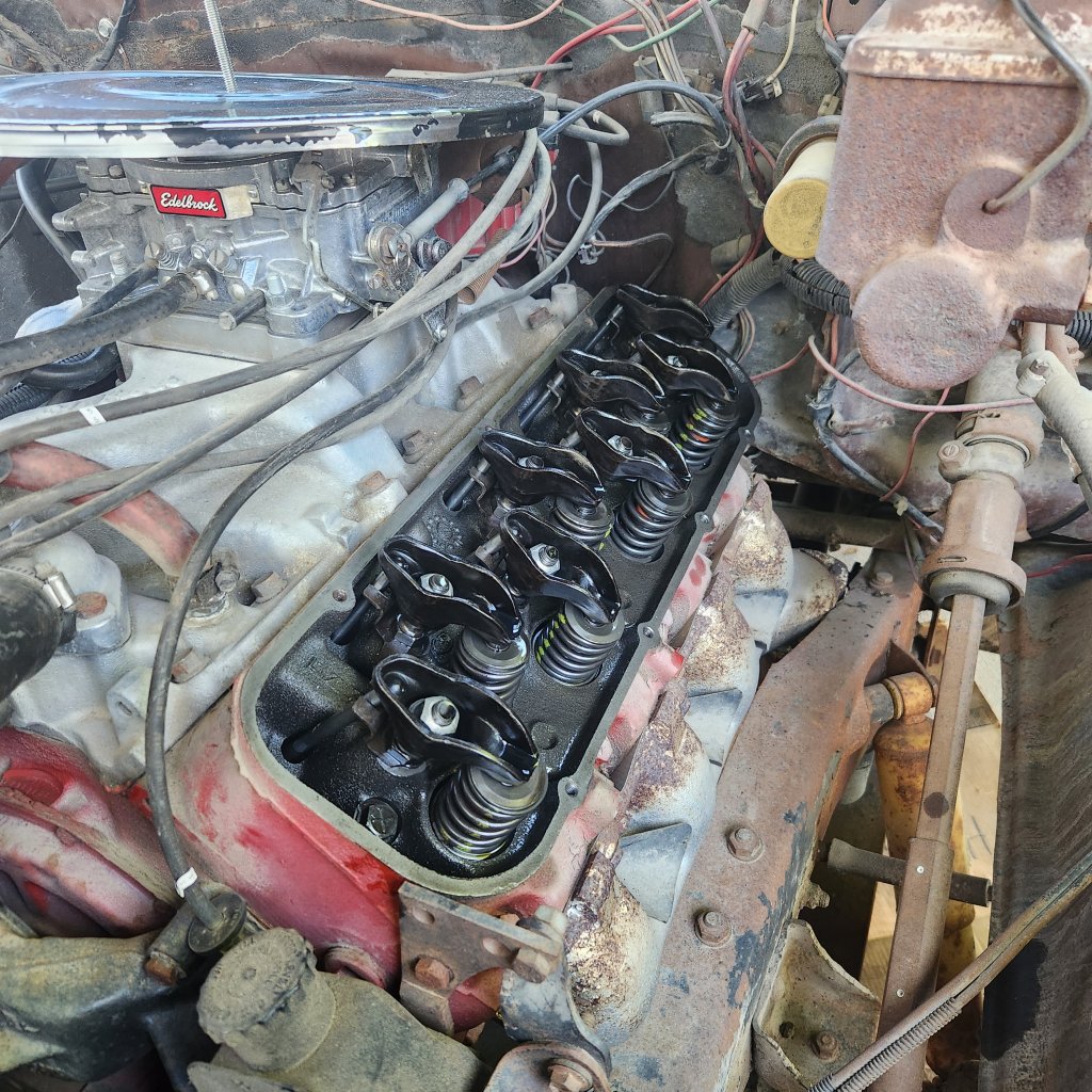

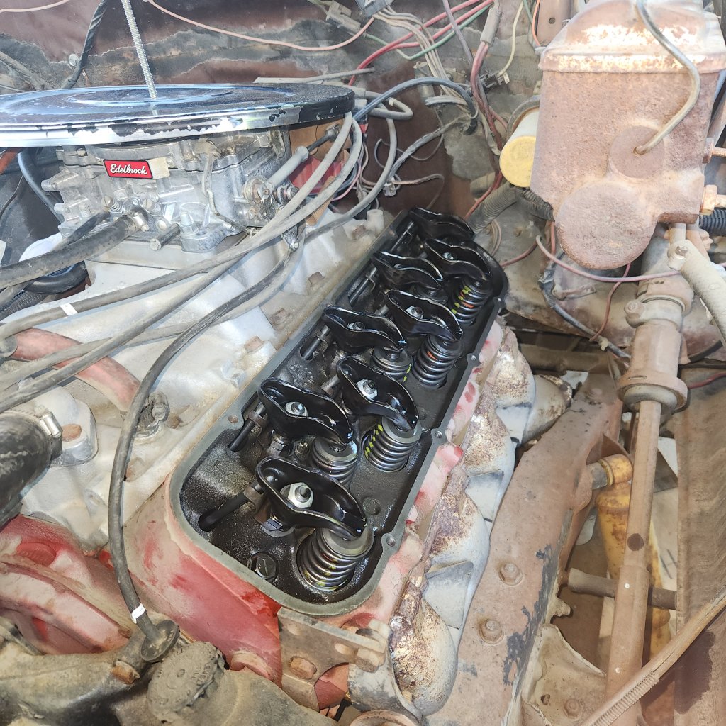

I have this 1978 454 it does not have a lot of miles on this engine since it's been rebuilt but I hear light ticking and clacking coming from the right side, I haven't ran it yet since I pulled the valve covers off but I'm going to do that soon, are these rocker arms adjustable or are they the torque to spec type? There is one or two that feels a little loose compared to the others, what's the best way to go about diagnosing this?

You can't really just guess with valve lash adjustment. But, if you can wiggle a rocker arm up and down, that's too loose.
You can start with a basic valve adjustment.
Are you sure the ticking was not a cracked exhaust manifold, or other exhaust leak?

At this point I'm not real sure what the ticking sound is, I've heard enough valves over the years that it sounds just like a rocker arm, but then as the engine starts warming up there's also the sound of a light metallic scraping noise that comes louder and louder. And not terribly loud just a little noticeable for someone who's listening. Maybe the scraping noises nothing I don't know yet.

Those are adjustable.
Rotate the motor by hand, when the intake starts to close adjust the exhaust, when the exhaust starts to open adjust the intake.
1/2 turn after the play is removed from the pushrod/rocker arm.
Hydraulic lifter cam.

Solid or hydraulic cam?
Scraping noise could be the timing chain, water pump or push rods. About the push rods, those 454's could have one of 3 different diameter push rods. The push rod guide plates need to be the right size. Some of the cast heads may have a smaller hole cast in the head where the push rod goes through. The other issue, if the stamped steel rockers are a higher ratio, the parts may not all play nice together.
Look close where the push rods go through the guide plates and the cast holes in the head. See any scrape marks?
