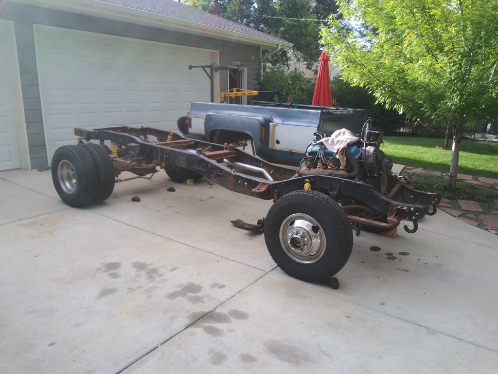

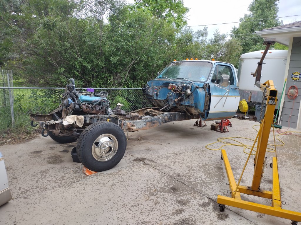

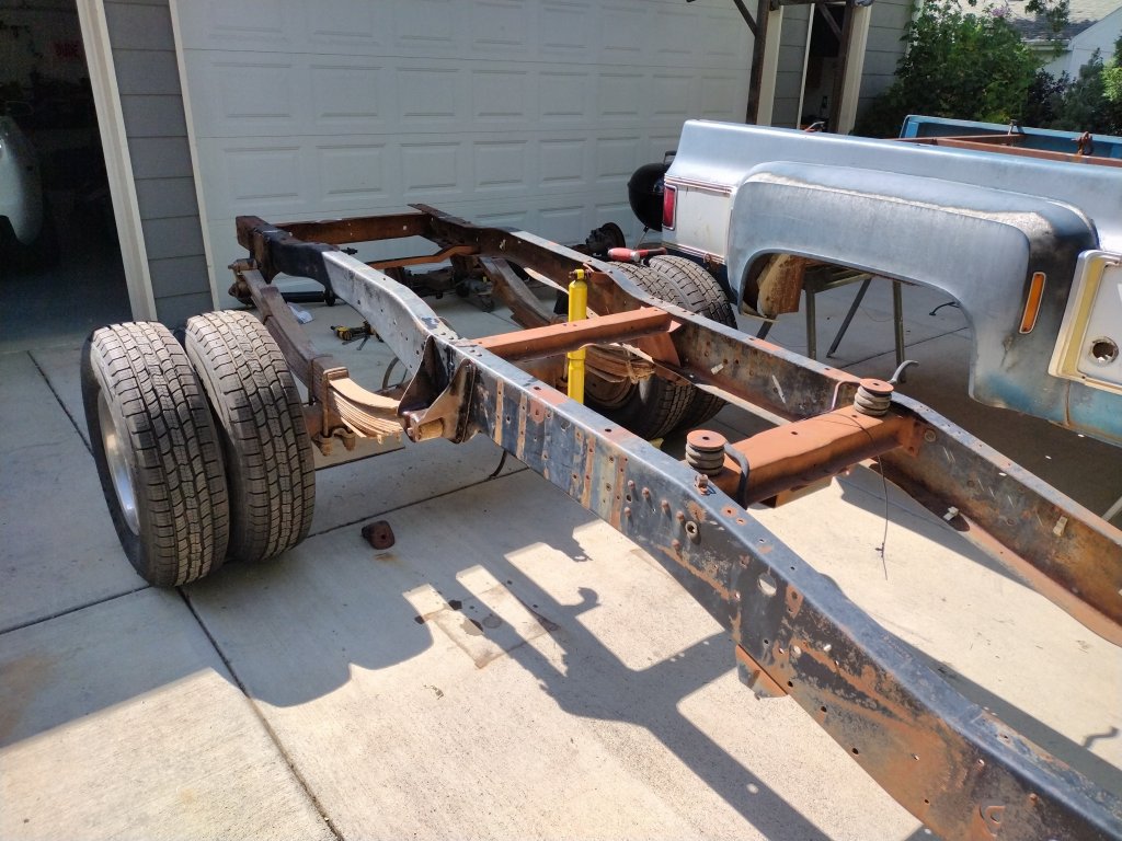

Started frame swap Saturday

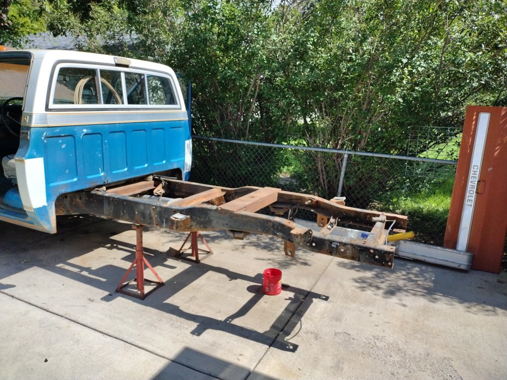

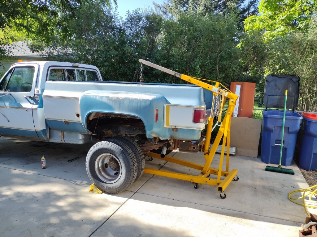

Took all day. It's a ton of work. BTW the K30 SRW rear spring brackets are different.
I think they are the same as a K20??
I believe that's correct, then to go even further the cab and chassis trucks have narrower axles and both rear spring hangers are different. Tucked up closer to the frame.

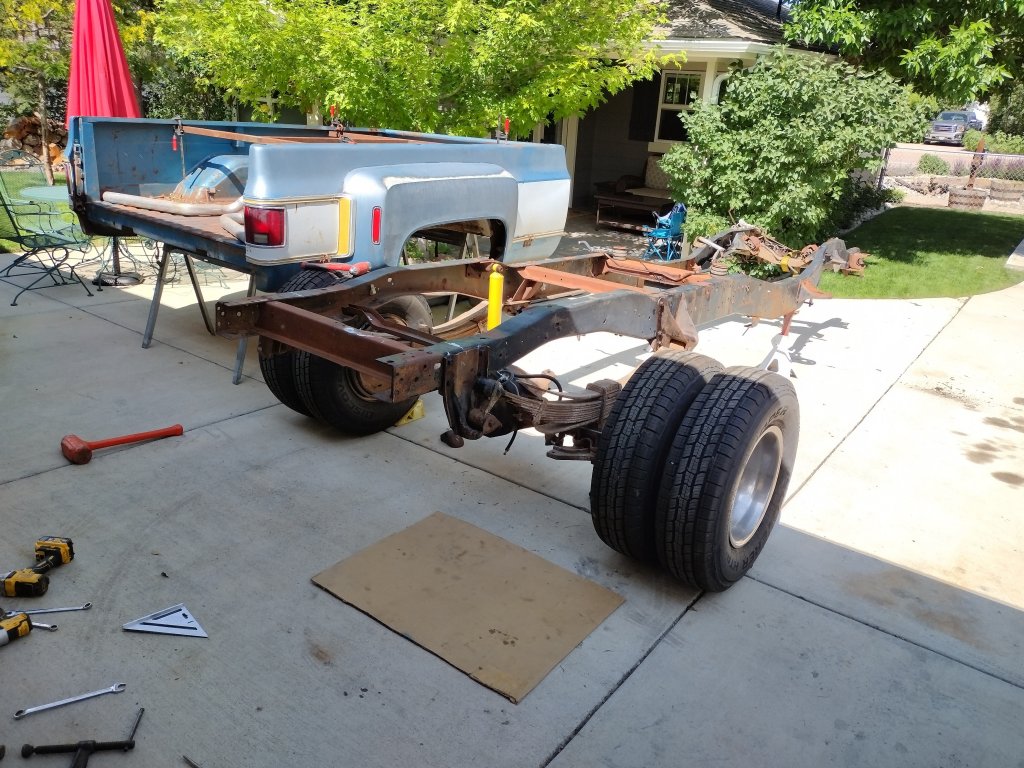

Started Raining on me the next day. But I moved the cab back to start exchanging parts from 1 frame to the other. It should be way easier to swap the engine trans & T-case without a cab in the way. ;)
K30 and K20 spring hanger are totally different. K30 are almost vertical. The K30 is mine. The shocks mount inside the frame due to the location of the spring. Shocks are also reversed from a K10/20.
Second group of pictures is a C20, but the same idea as a K20. K20 is 2" longer and has the spring eye bolt below the frame rail. Shocks sit between the frame and spring, forcing the hangers to sit farther away from the frame.

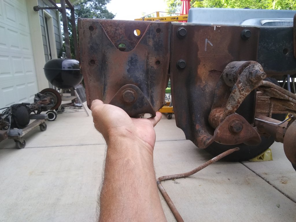

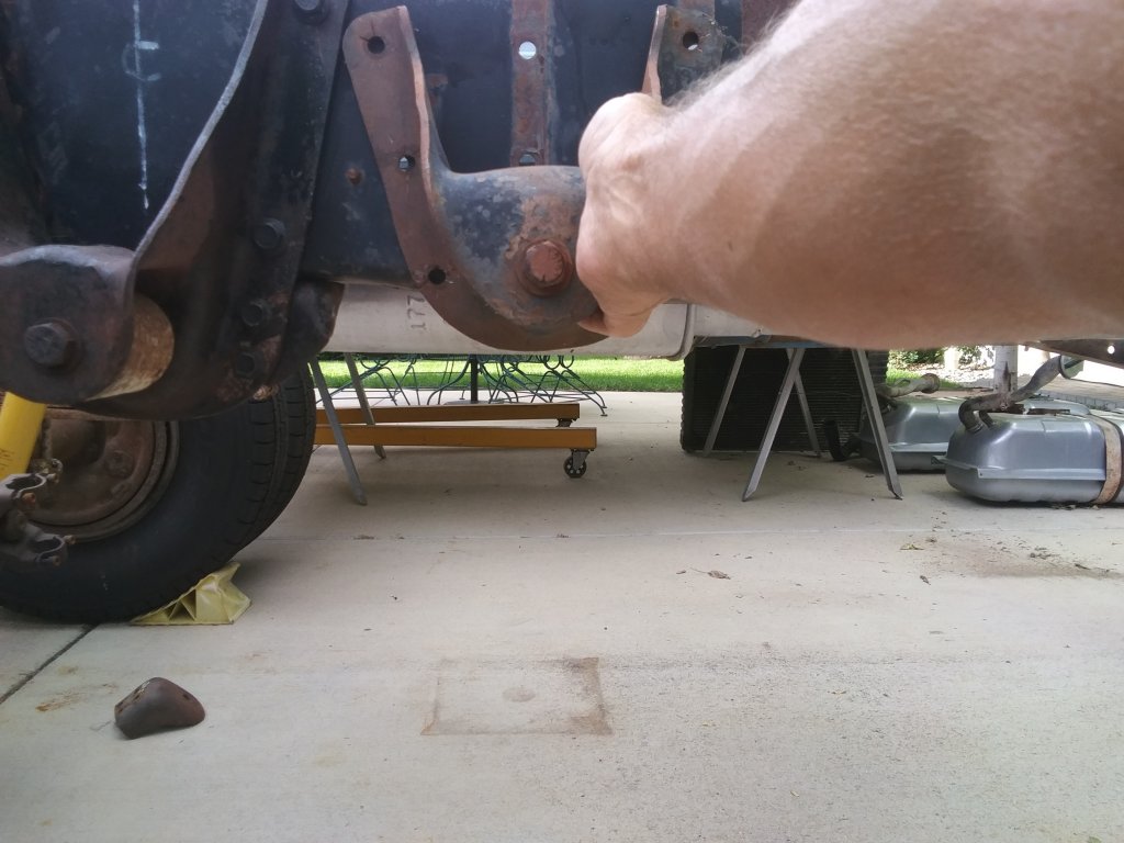

These are definitely different

So those are '77-'78?
My '79 K30 dually most definitely has the same hangers as the two sets I have from M1008 srw trucks.
The ones I'm holding up in the pics are off the 78 K30 frame. The spring perches I put on I got off a early 80's K30 cab & chassis in a junkyard.
