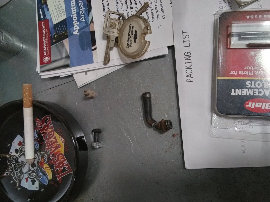

I was happy with my conversion until I went thru a dip and the Front axle made
contact with my fabricated Front crossmember. Luckily it only broke the vent tube
off the font axle.
Was this a normal sort of dip, or an "oh $hit" sort of dip that you knew you shouldn't have hit that hard?
I've hit both and don't raise/lift my vehicles because they've bottomed a time or two. Consider your other options before thinking it was a waste of effort.
Are you running any kind of bump stop?
A solution like that sounds much better.

See broken 90° vent tube
Dug them out of the box, look like they were never installed but a dent or two on the tube. I said 90 degree but they are 45. 1/8 pipe to 3/8 tube. Copper tube sweat to brass pipe.
They are tarnished, they look as old as me. NOS with shelf wear.
GM was all over the map, Both mine are at a 90 degree turn weird
Do you want one? PM me your address if you do and I'll put it in the mail. I will put the other one back in the box of hardware that I'll probably never need.

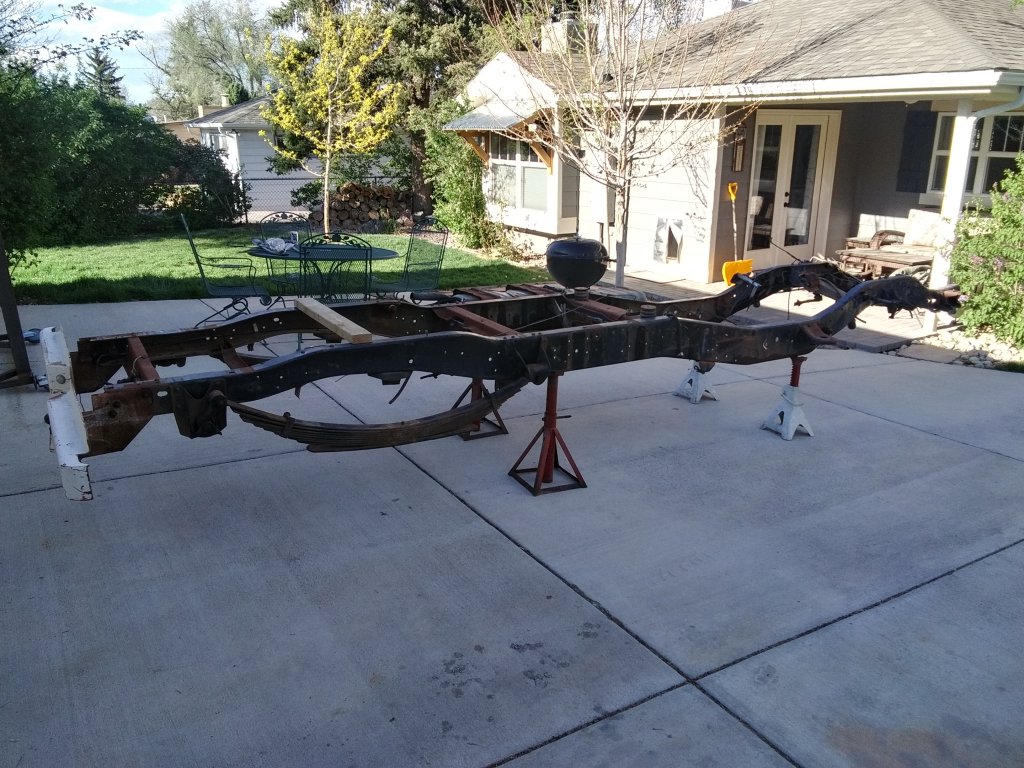

The retreaval of K30 frame is complete. Layin a field down east of Divide Colorado. Usual deal guy bought 1 ton for Diffs. Bare frame $200 I wish I would have found this a year ago.
