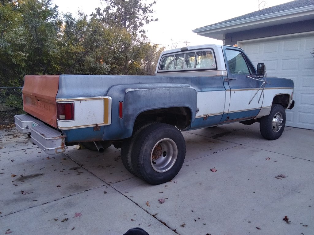

Been driving Ol'blue around.
New factory replica exhaust and a tune up.
After sitting since 1993 I'm finding all the leaks
It's a blast...
