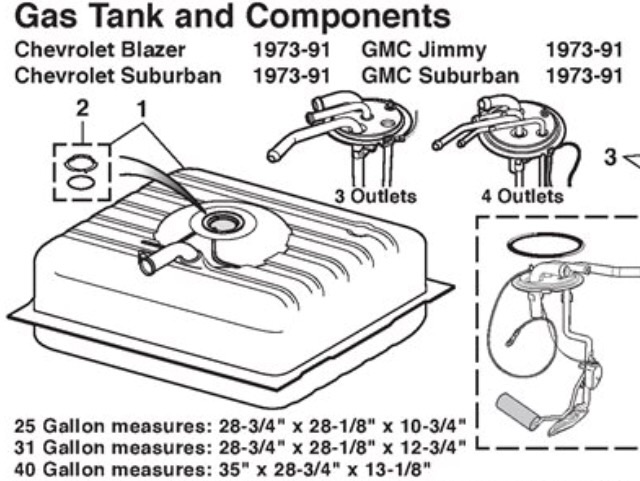

I know this is about wrapped up, but here are the tank dimensions for future reference.
Excellent info. Thanks! That's actually perfect because my fuel pump set up is only good for up to a 10.5" depth.
