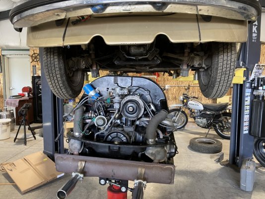

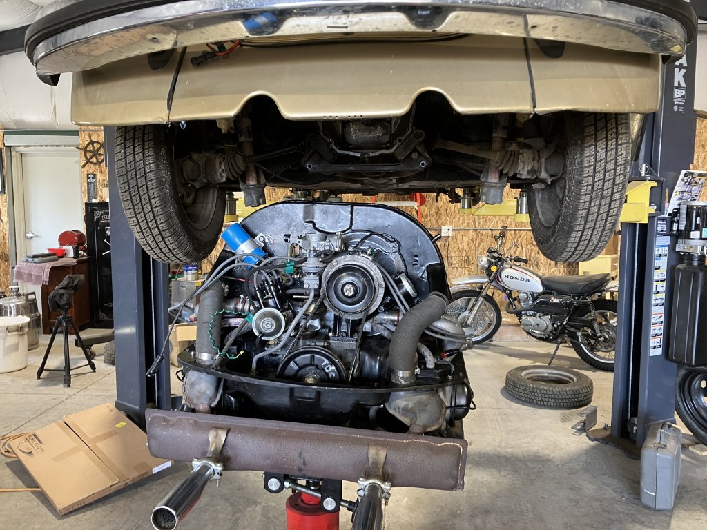

Pictures? What I just finished for my good wife.
