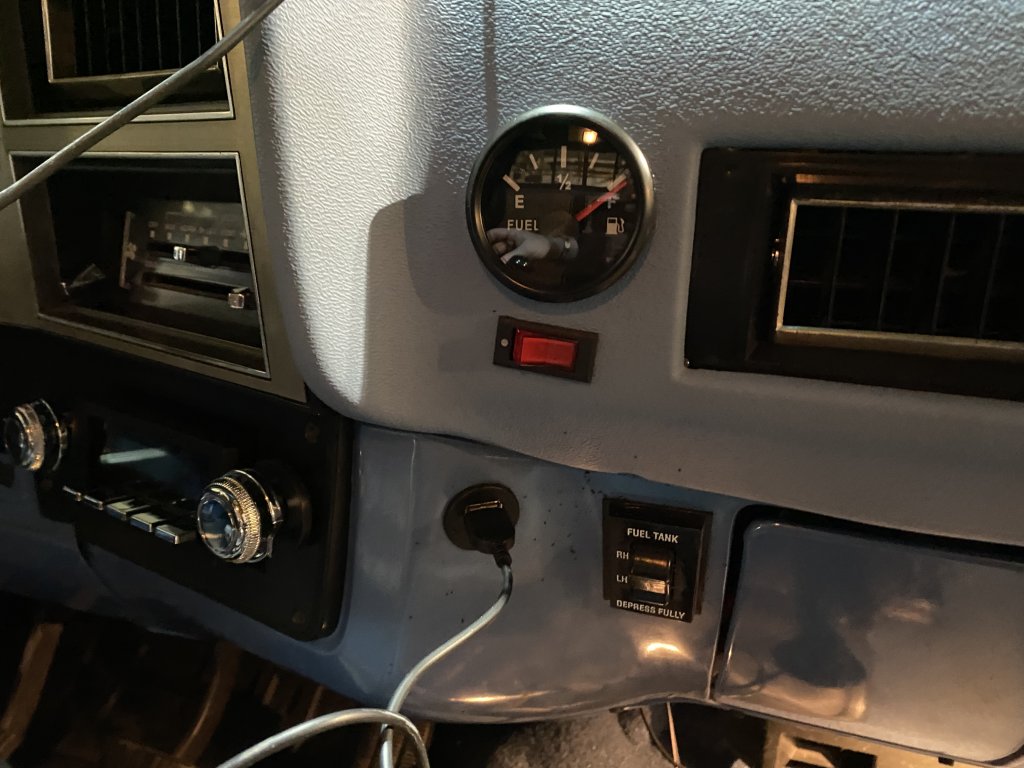

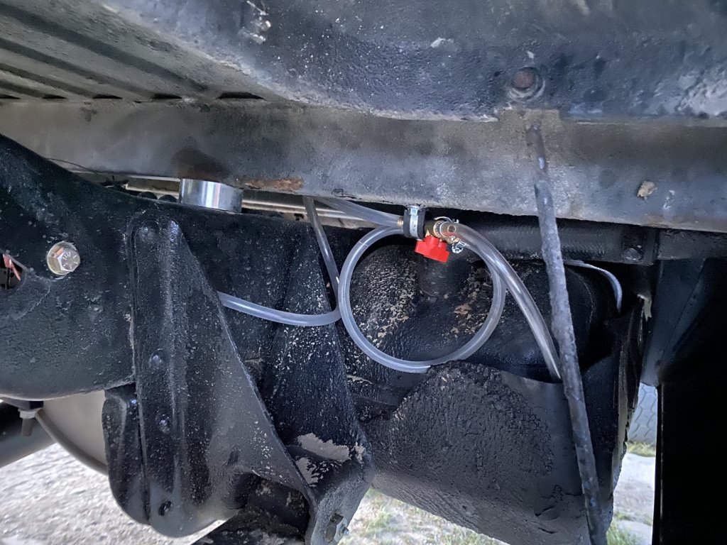

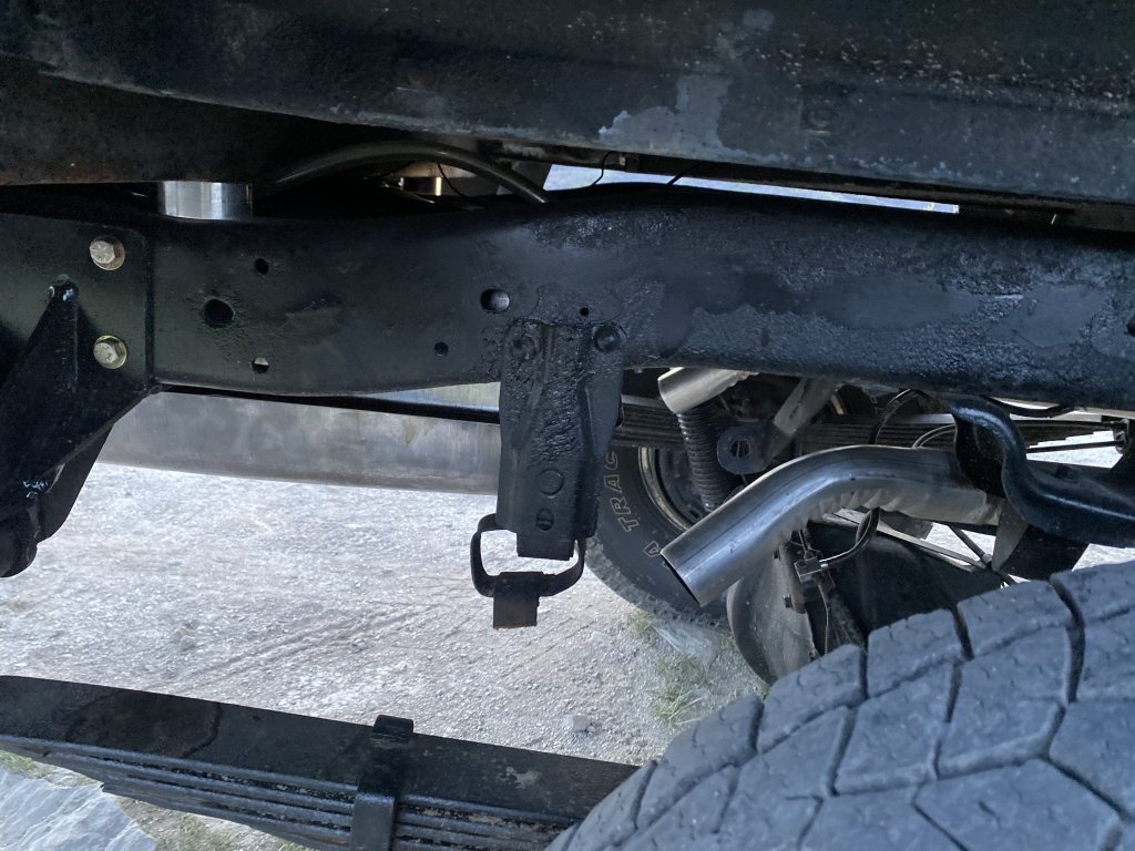

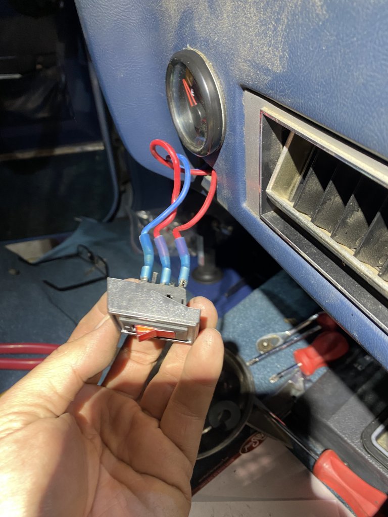

I also wanted to do this to get additional range as I like to explore remote areas. Additionally, I’m setup to fuel dirt bikes or generator or help someone with some gas if needed. I learned a lot and also absolutely love having the additional range. I now have 65 gallons of capacity with the two saddle tanks and a 25 gallon aux tank in the spare tire location. My filler cap is in the bed with a flush mount boat filler cap and I have a transfer set up to transfer fuel from the aux tank to the filler neck of the passenger side tank with a cheap clickity-clack electric fuel pump mounted on the frame rail and a gauge and transfer switch on the dash. A one inch body lift made clearances quite easy. Check it out.
