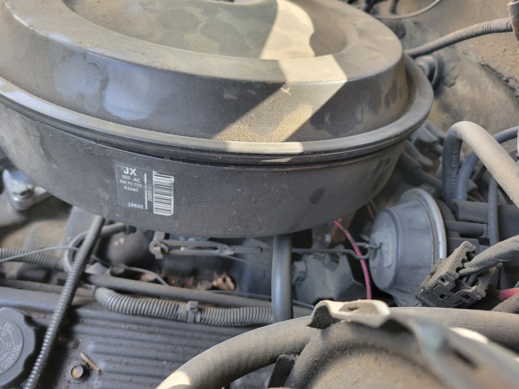

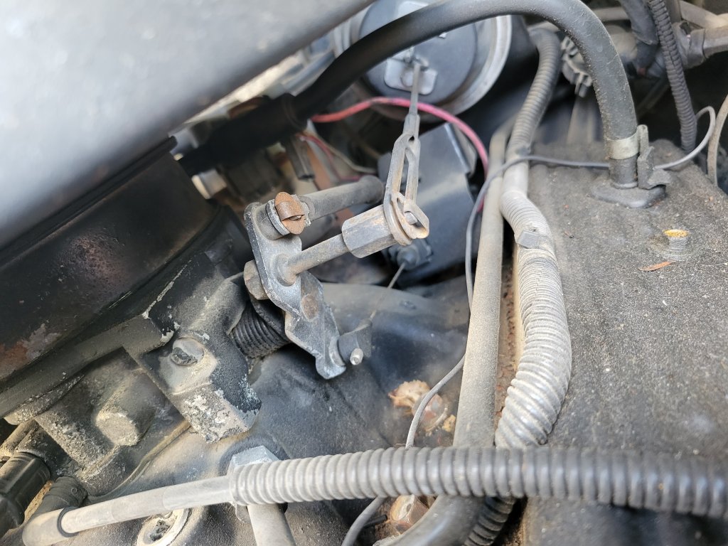

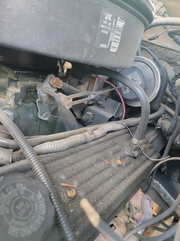

the RPM shouldn't hang when you blip the throttle in neutral i don't think. I'd have somebody rev it while you watch under the hood and see why it isn't immediately idling down after the blip. throttle cable could be hanging up. maybe a spring is missing somewhere?
gmbellew
May 27, 2018
1,583
1,823
Kansas city
glen
suburban 1500
here are some pics I took of the area for another thread for information.

Mine actually used to have extra springs, @AuroraGirl pointed out that there were carb return springs added on and the return spring js built into the tbi. I removed those springs with no change other than pedal is easier to press, still hard at first kinda so when you get it to move it revs higher than you want. I’ll get a video of a blip of the throttle later
gmbellew
May 27, 2018
1,583
1,823
Kansas city
glen
suburban 1500
maybe the return spring on the TBI is weak? could be why somebody added extra springs as a quick fix?
