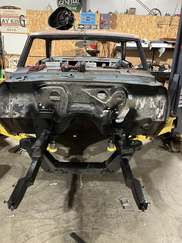

Front end was not a perfect fit, but it fit got it straight and square will put the upright arms on today. They forgot to send bolts and they’re really expensive so I’m going to wait for those as well but at least I can get that started and then move onto the rear end while I’m waiting for the front end bolts feeling pretty good about it

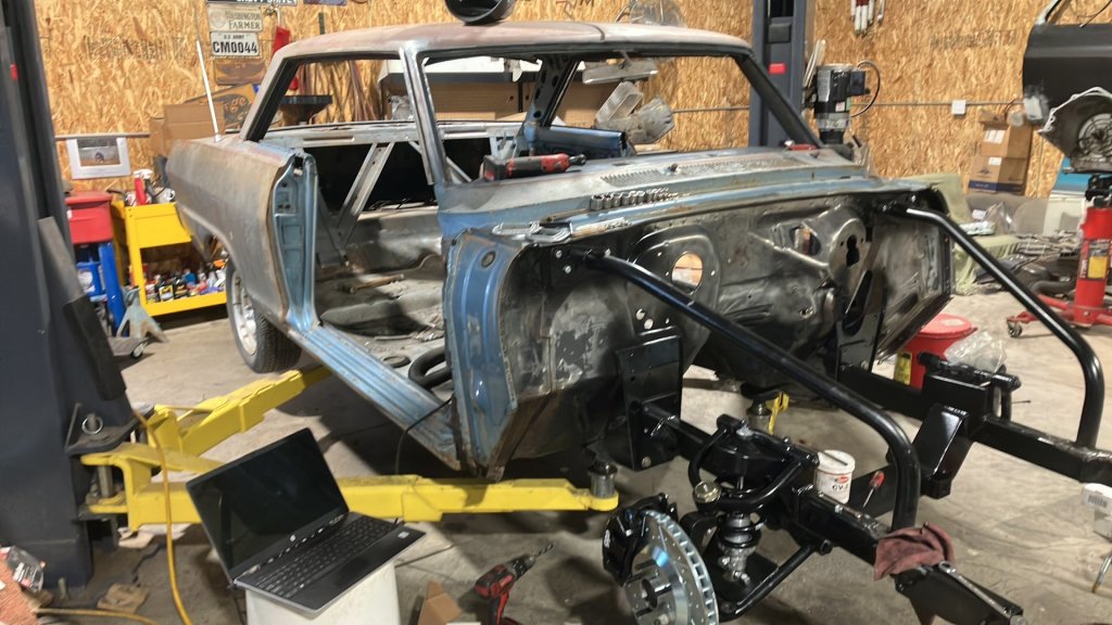

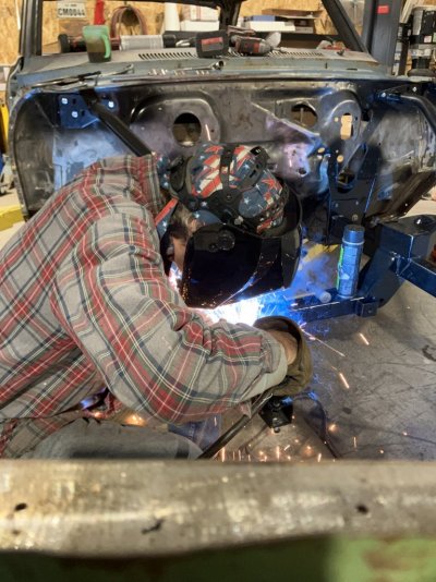

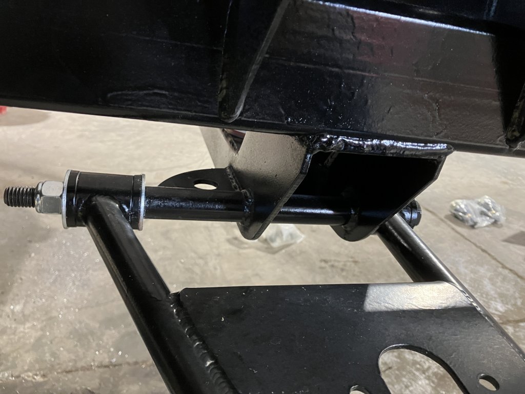

So I bolted the down tubes onto the firewall loosely, positioned them on the clip and then clamp them down. bolted everything tight, and welded in place. I then let them cool in place. so down the road I should be able to pull the whole front end off as a unit and it should line back up if I need to do that.

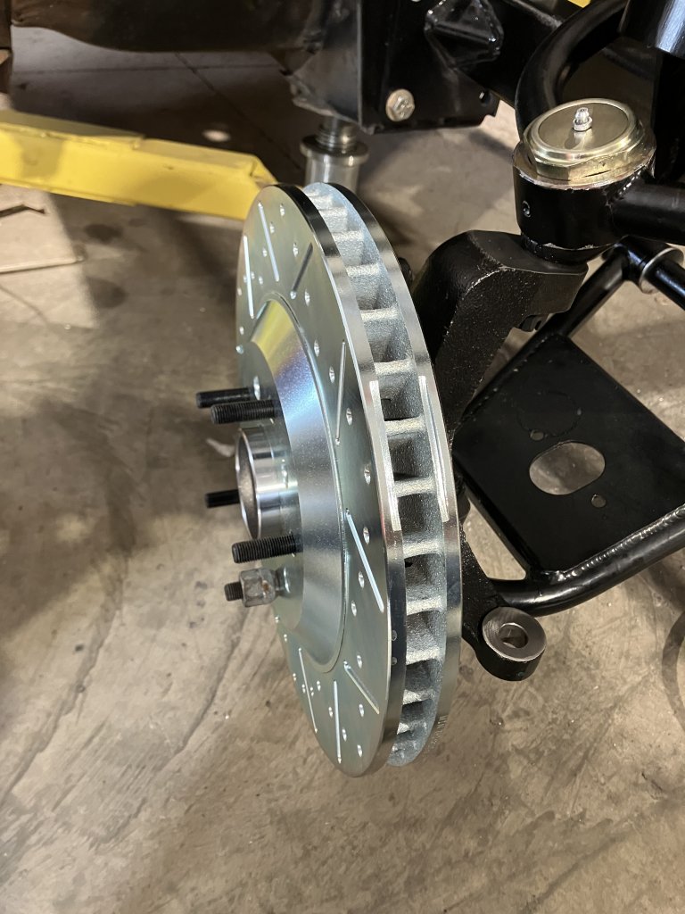

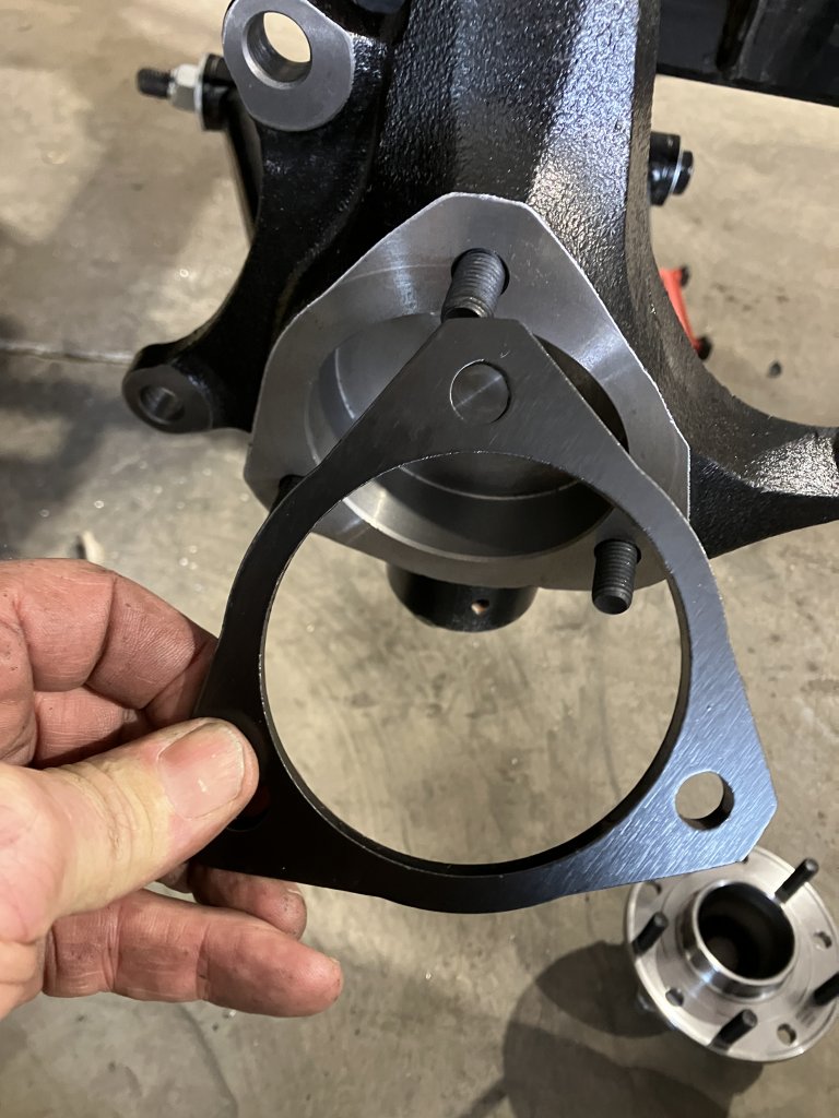

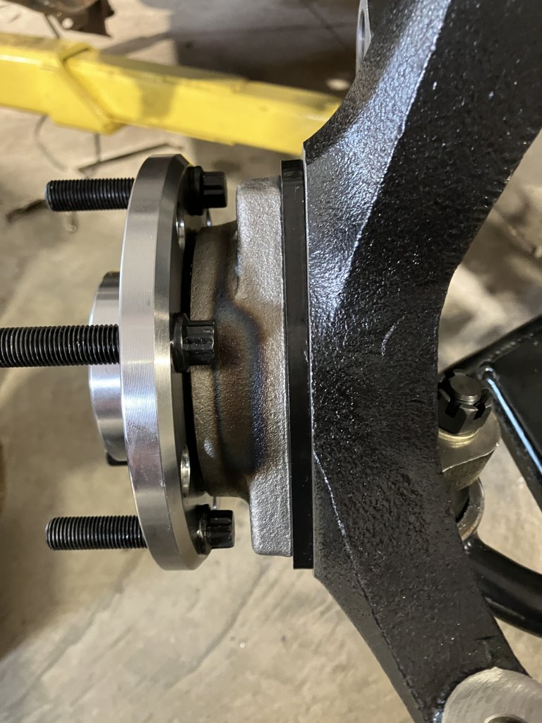

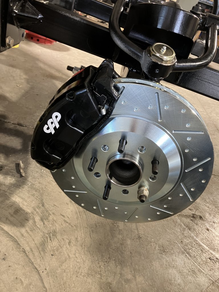

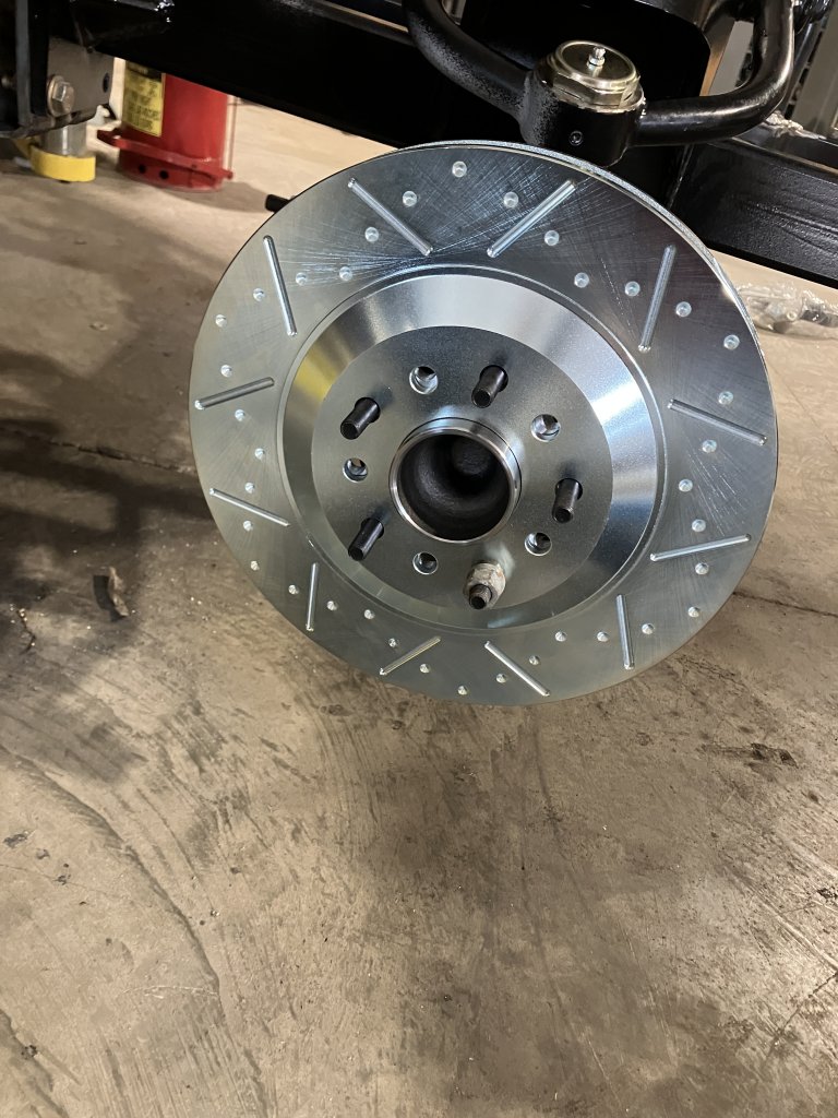

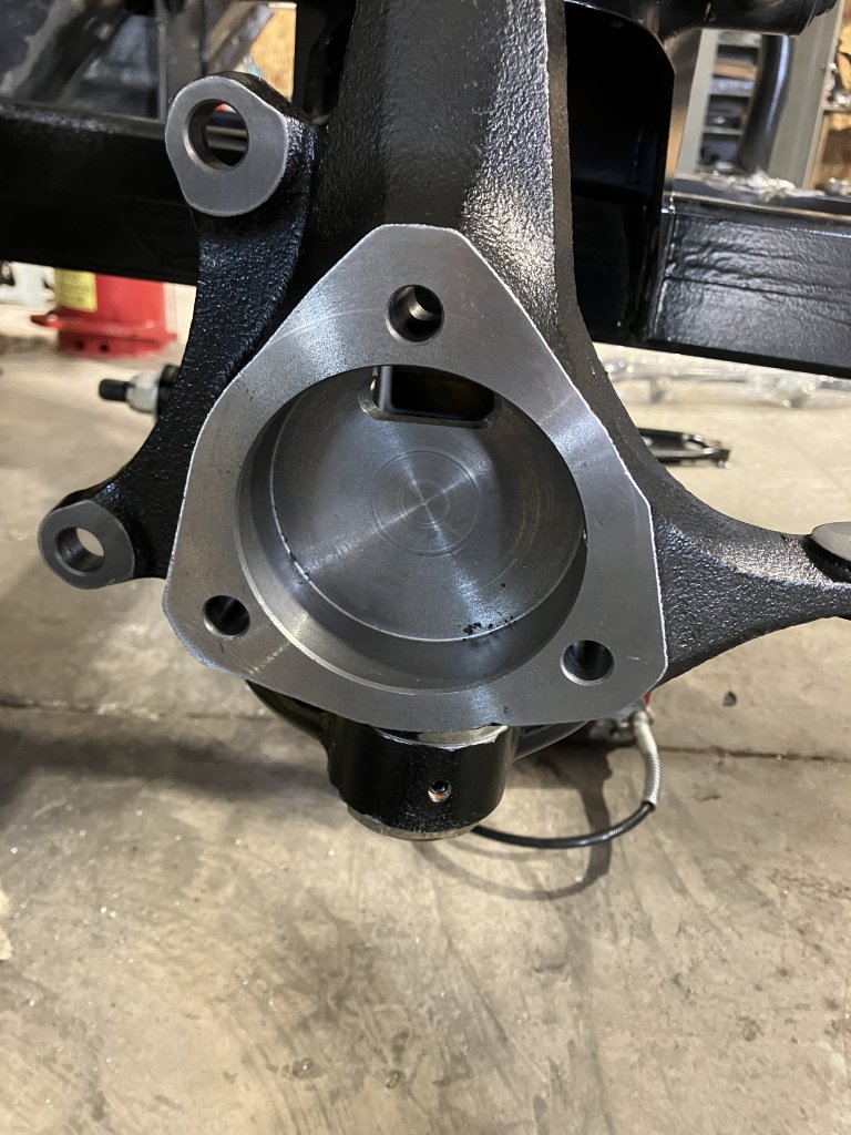

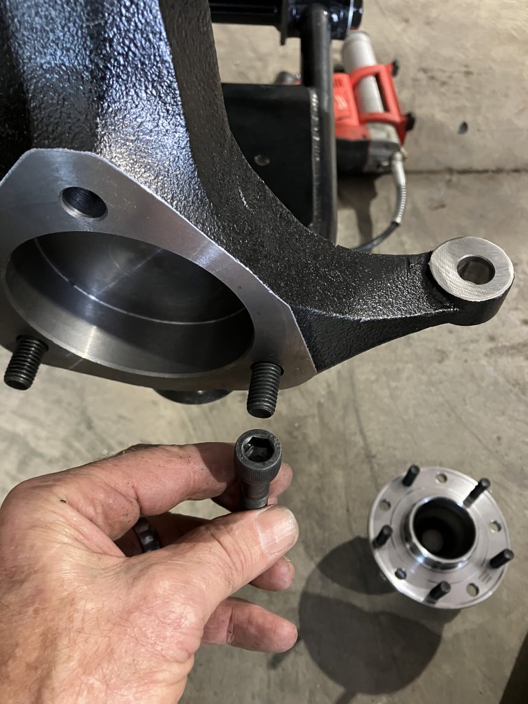

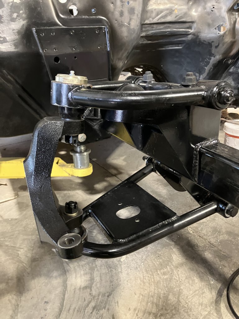

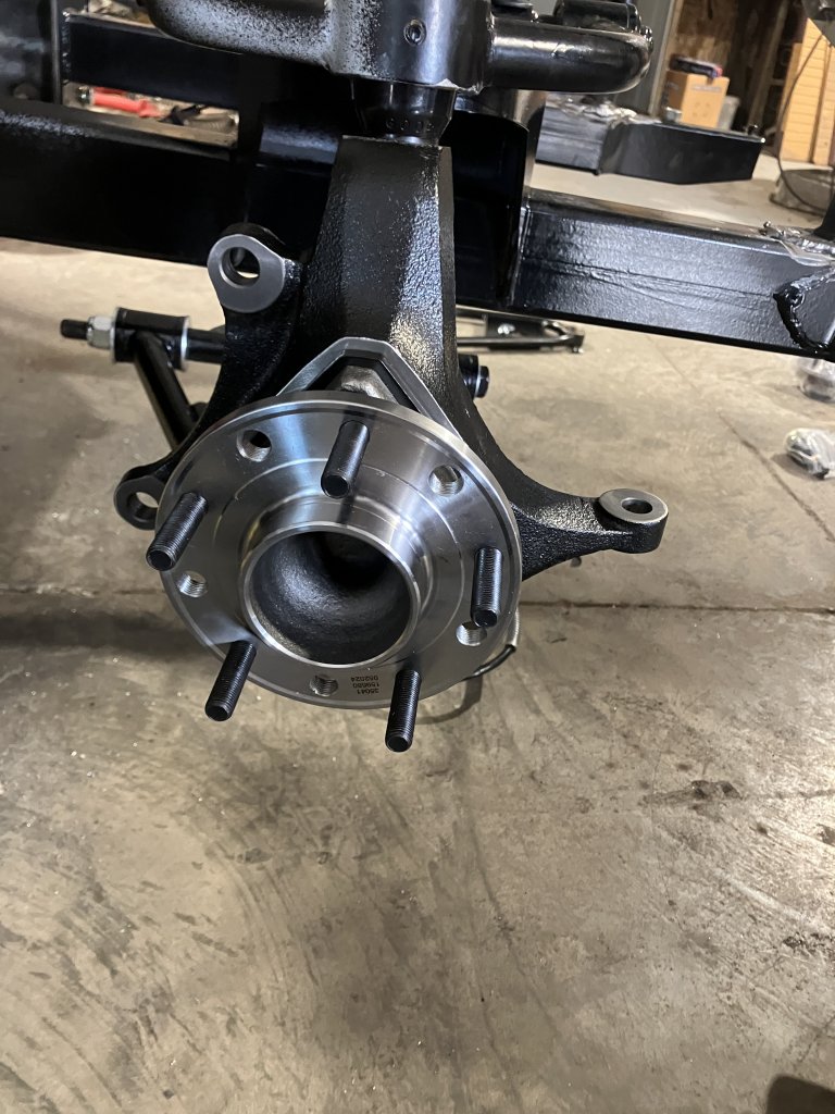

So the spindle, hub, calipers and disc are from CPP Corvette big break kit for Mustang ll. I will have to use at least 17 inch wheels. My buddy Longie, ( he is a Longmire hence the nickname name) has been up and we are having fun building the car. He has some 18 inch wheels that might fit to make it a roller that would be nice to be able to roll it around the shop. This morning I will remove the 7/16 hub bolts, and replace them with the half inch ones. They’re required at Bonneville.

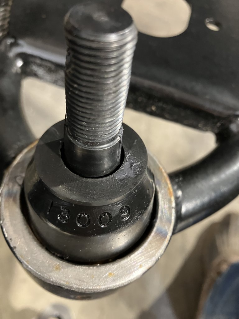

idahovette
Firefighter
Aug 7, 2016
9,750
23,066
Weiser Idaho
Perry
1975-1979
K20-K10

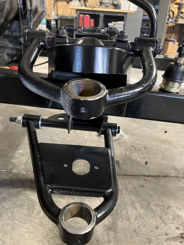

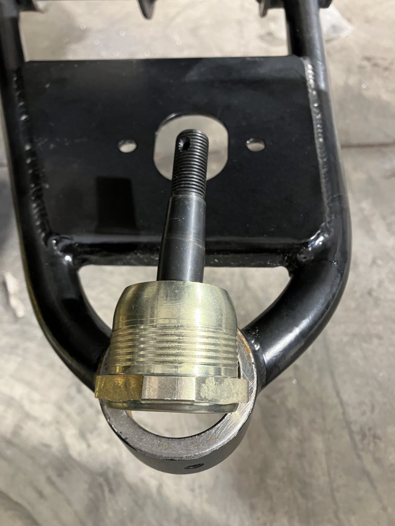

Hey Craig, those look like mopare threaded ball joints . Any specs on them?
That’s part of the front end stuff that I got from Clay at Full Tilt Street Rods I could measure and see if I can find any numbers. The driver side has not been assembled yet brother, I’m doing that this morning. I’ll post photos.
35,426
44,737
The roundy round cars often use the thread-in ball joints as well.
idahovette
Firefighter
Aug 7, 2016
9,750
23,066
Weiser Idaho
Perry
1975-1979
K20-K10
Yeah, just wondered because I have the sockets to install the mopare balljoints......2 different sizes
35,426
44,737
Huh.. you just reminded me... I used to as well. I wonder where the hell they went.
14,029
24,144
You probably bought some recently, just have to find them
35,426
44,737
Lol, it's possible. I doubt it though, since GM never used them, as far as I know.
14,029
24,144
I didn't know the hoard of tools were gm-specific, but that makes sense because it was a gm auction
idahovette
Firefighter
Aug 7, 2016
9,750
23,066
Weiser Idaho
Perry
1975-1979
K20-K10
Only reason I have them.....I worked the line in the business and mopares were ALWAYS needing parts replaced ;) .......I kept them and they make wonderful "pushers" for many things on my press!!!

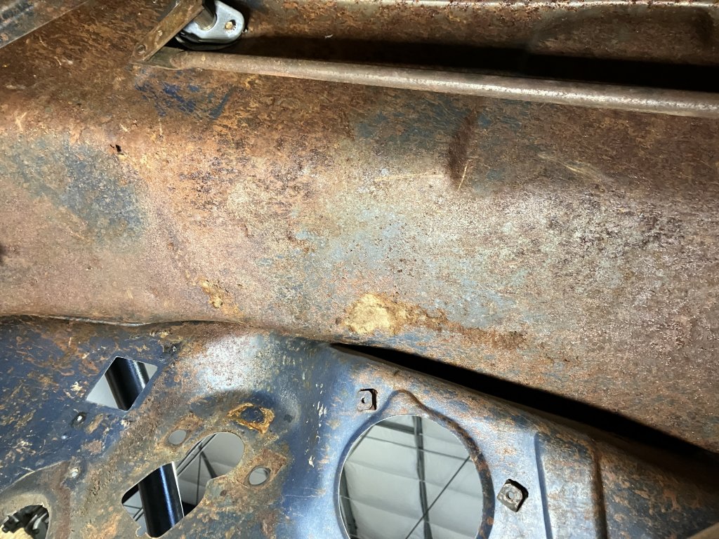

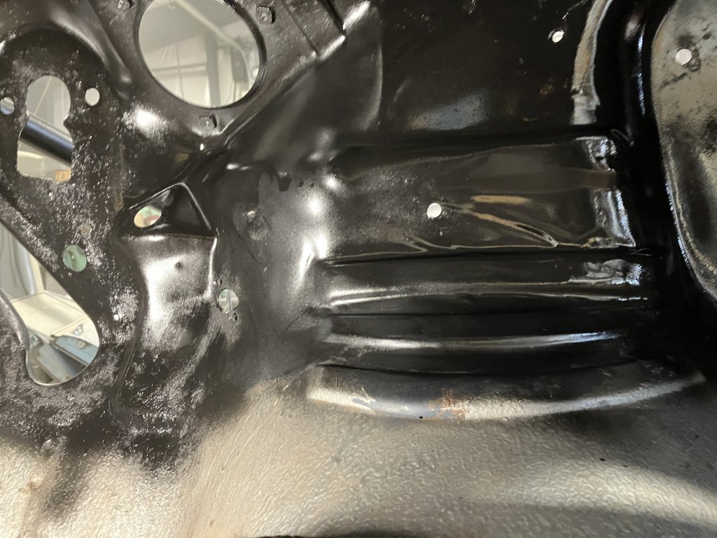

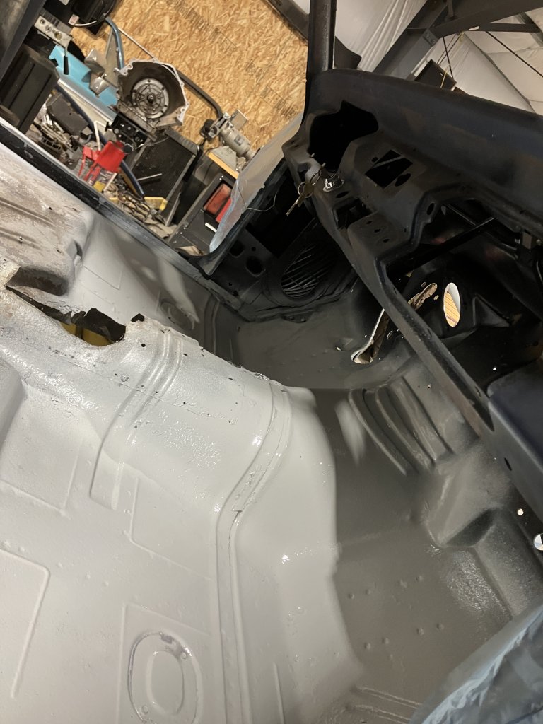

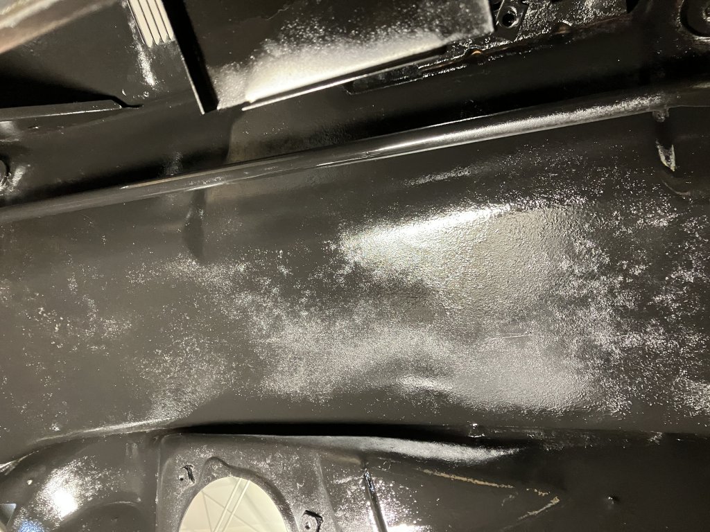

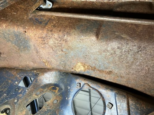

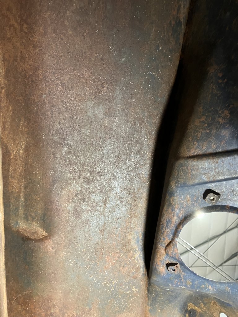

I am just trying to preserve what's left of the Nova. This is under the dash, got a couple coats of black satin on there. Scuffed it with green scotchbrite, wax and grease remover, paint.
