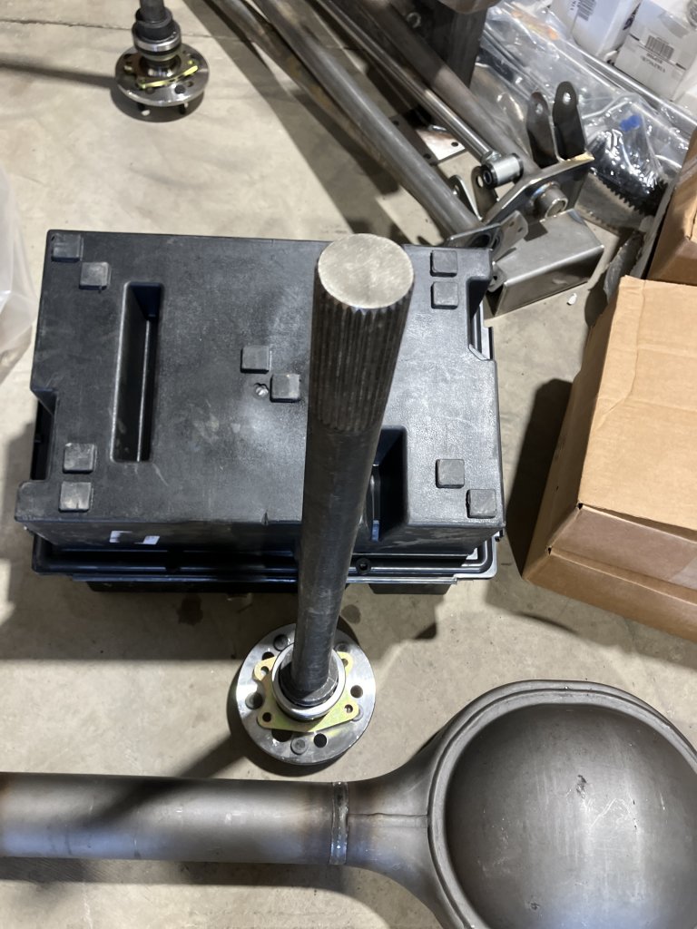

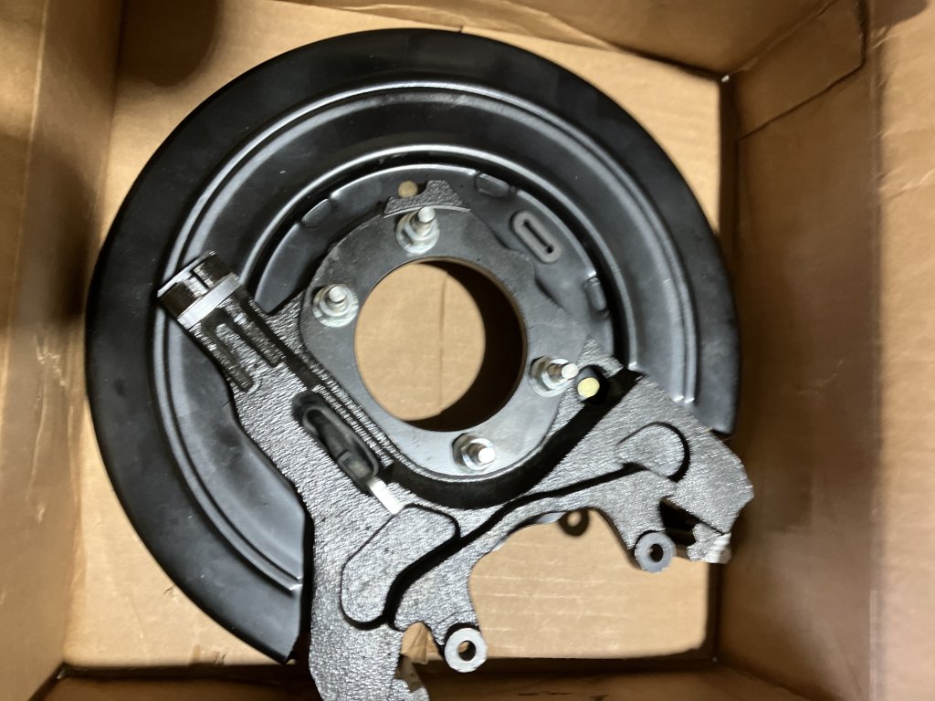

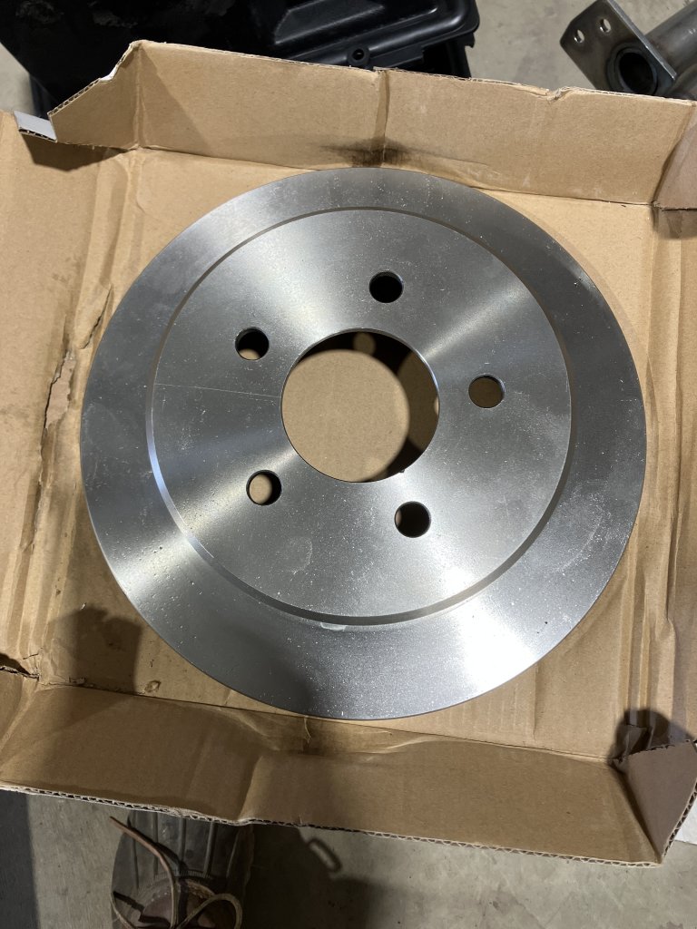

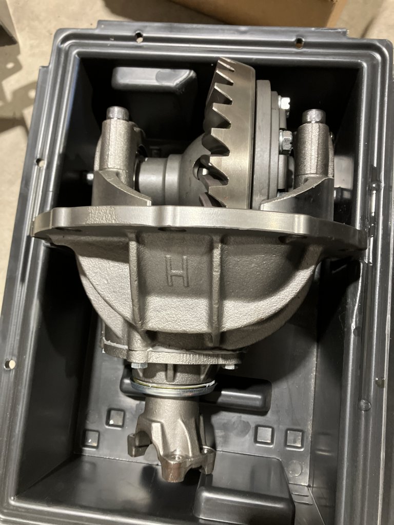

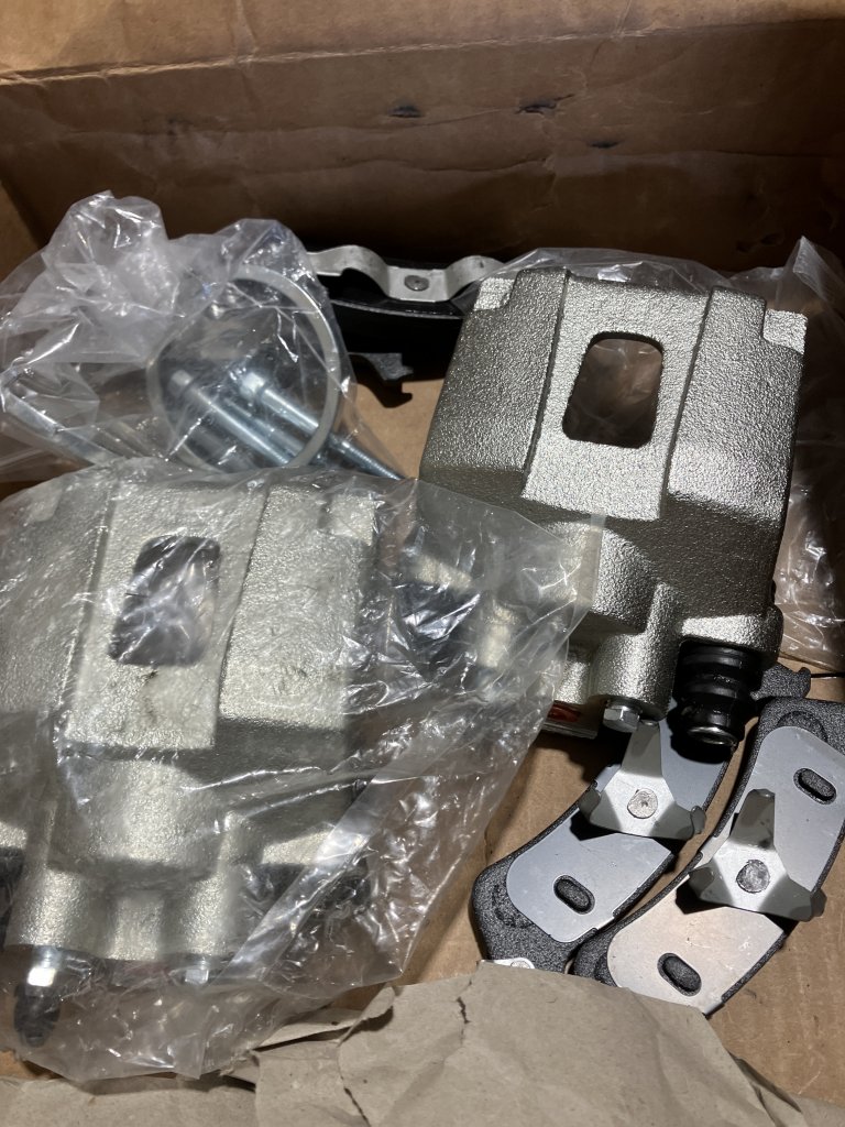

Almost done waiting for all the parts from Full Tilt street rods. These are all for the rearend, so disc brake, backing plate, calipers, ford 9" housing and pumpkin. Gears are 3.88 called 3.90. Axles are 31 spline, flange to flange width is 56 1/4 I believe. Don't want to tub now, but hope to be able to fit a 10 inch tire. Now I just have to paint everything. The axles came with 7/16 studs, probably will replace with 1/2 inch, which is required for some racing venues I am interested in. FYI all the break stuff is Explorer stuff so easy to find replacements.

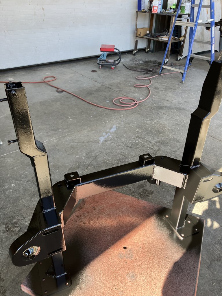

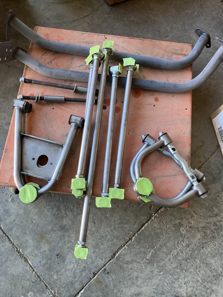

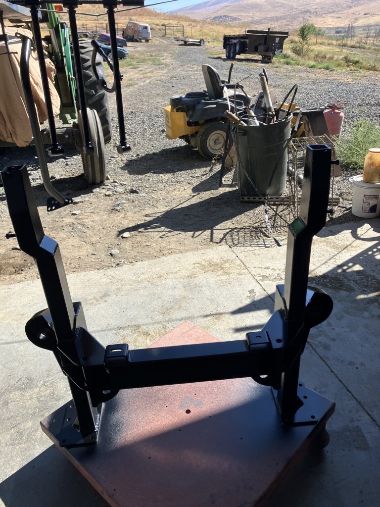

Got out all the parts that I wanted to paint, and began prep, deburr, sand, clean, etc. To windy today, but they are ready to go.

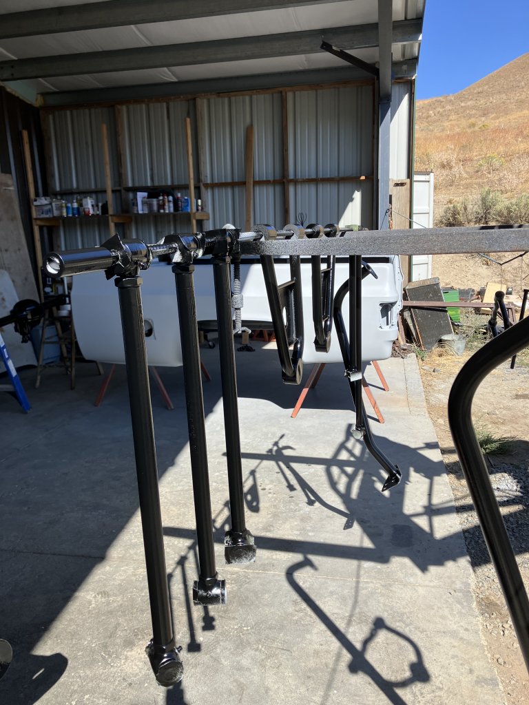

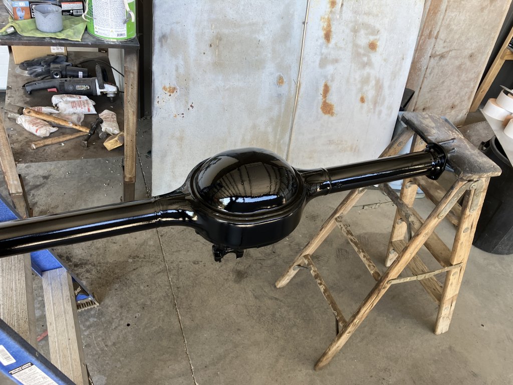

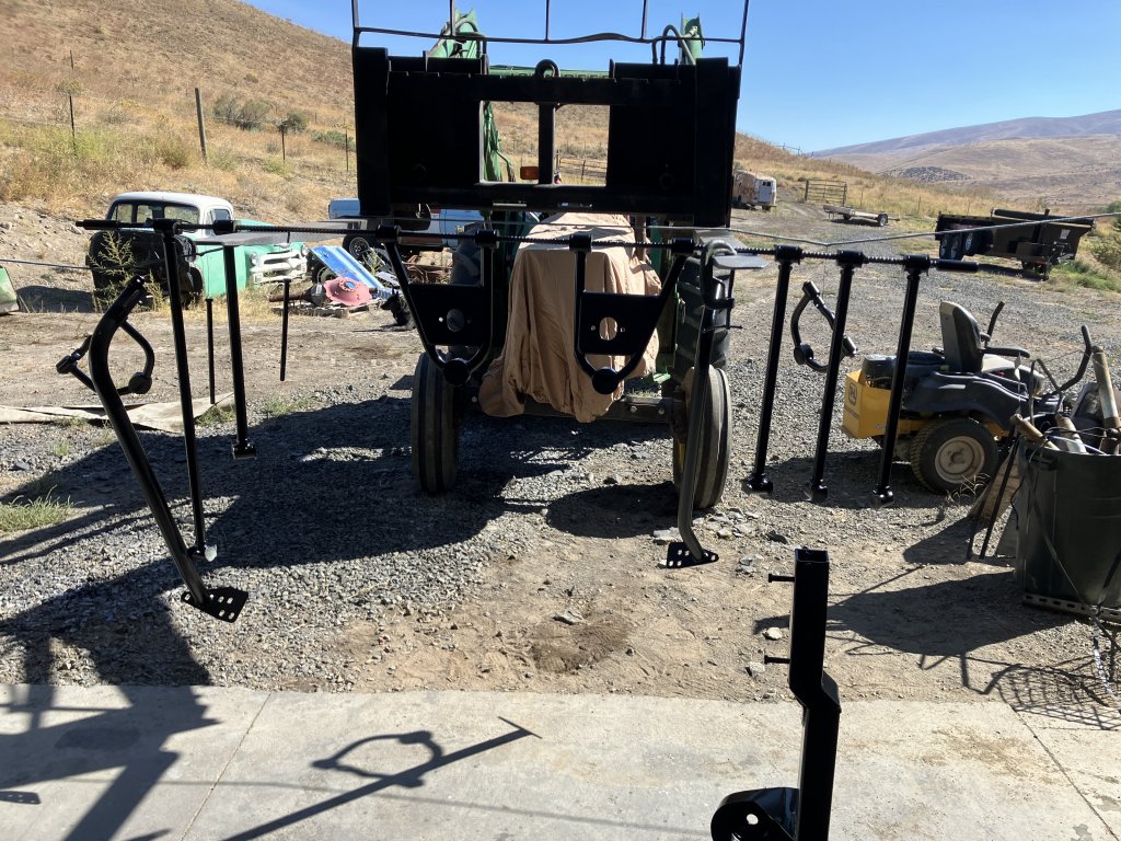

DTM Lamabase epoxy primer 40 on everything first let it dry 60 min. and then used magnet satin gloss frame paint. 9 “ W/ 3:89 gears. Parallel four link, mustang ll W/ dual adjuster, shocks disc brakes all the way around

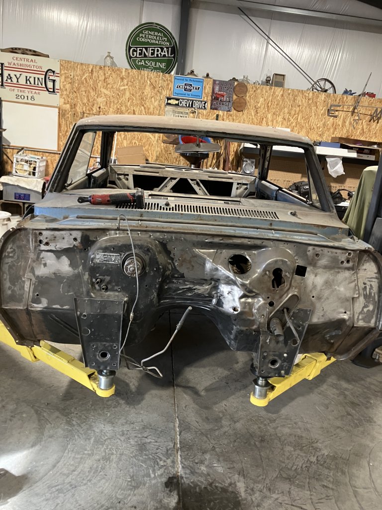

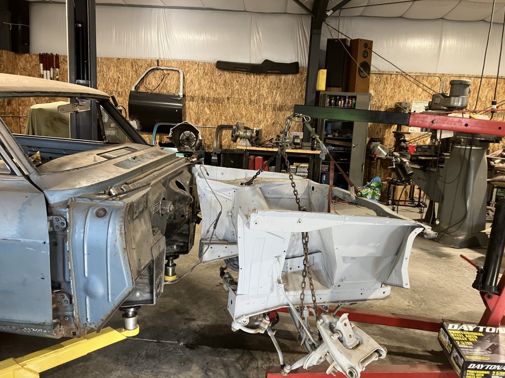

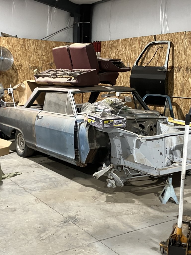

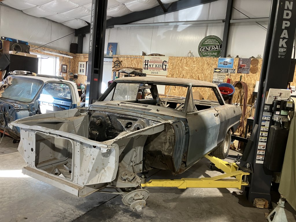

Well, it has started. I finally dug the nova out of the corner of the shop and started yesterday on dismantling the front end. Got it off. Got everything out underneath just have a couple small holes in the pan on the passenger side easy fix everything else is pretty good. Here’s some pictures to show the progress right now. I’m just going to clean and paint the engine compartment before I put the front end on. I sure hope Perry is happy with me.

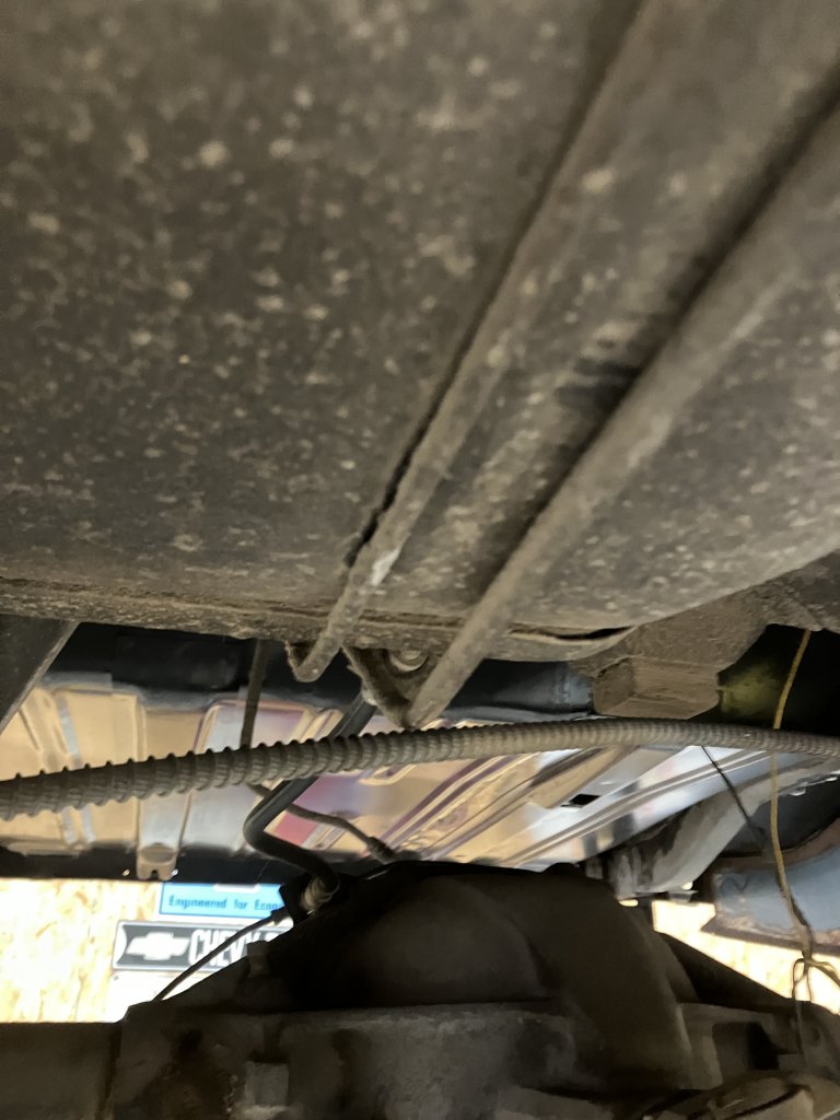

I had previously done most of the bodywork. My goal is just to preserve what’s there stop the rust paint everything. I will rinoline after painting underneath for protection.
