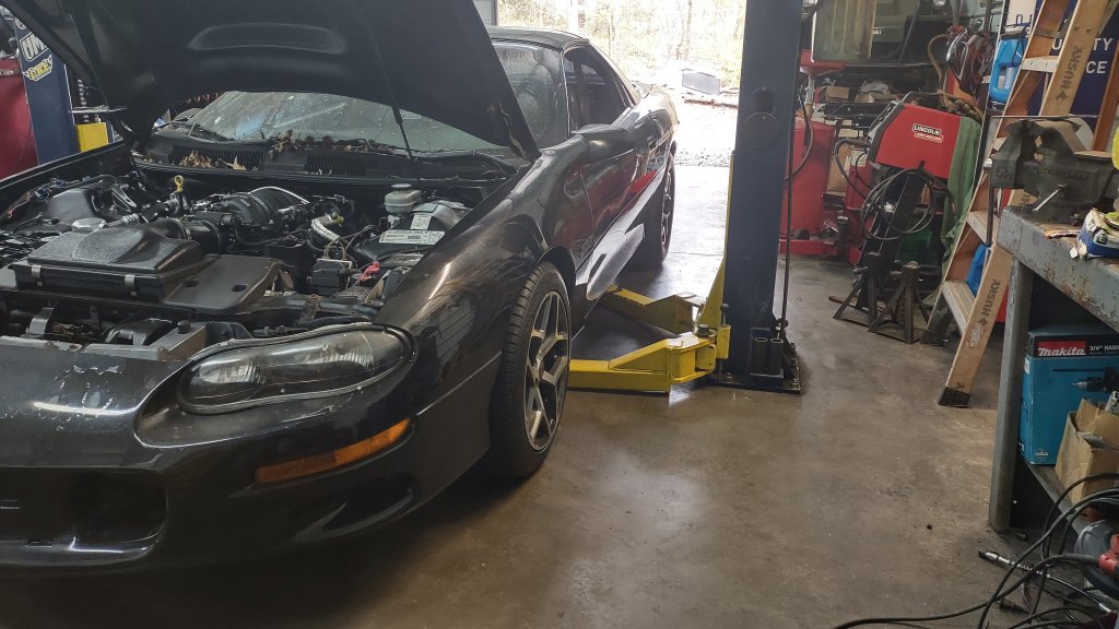

What head, cam and intake you plan on doing on the ls1 ?
My 2000 Z28 6 speed car puts down right at 500 rwhp on a very stingy 48 inch drum dyno. Thats on a factory 799 head caating on top of a LS2 bottom end with a cam motion camshaft. My goals is 10s all motor.

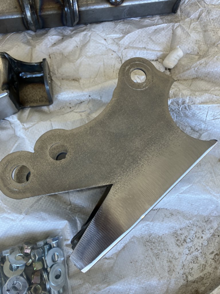

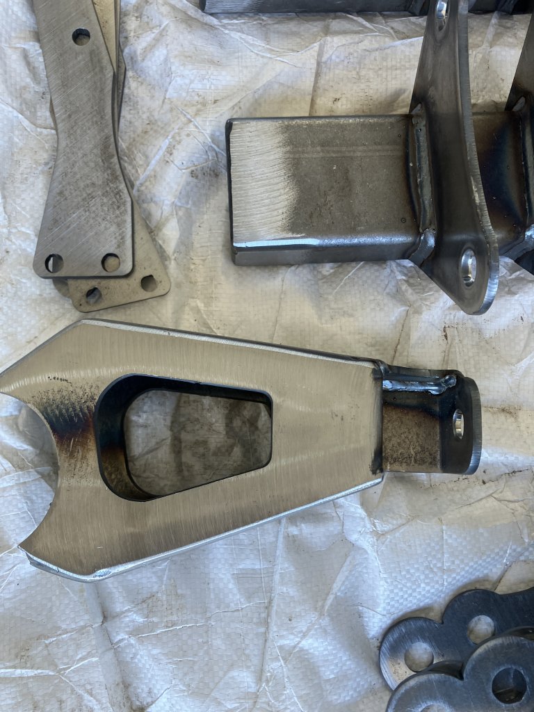

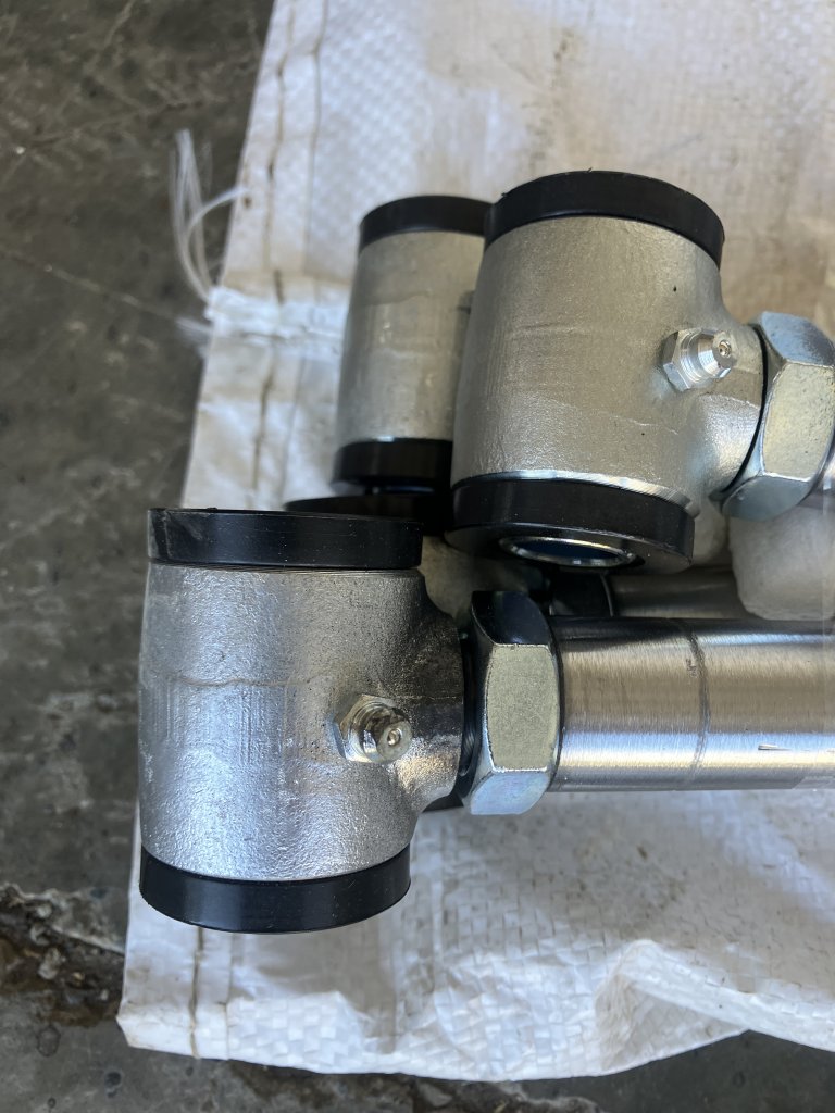

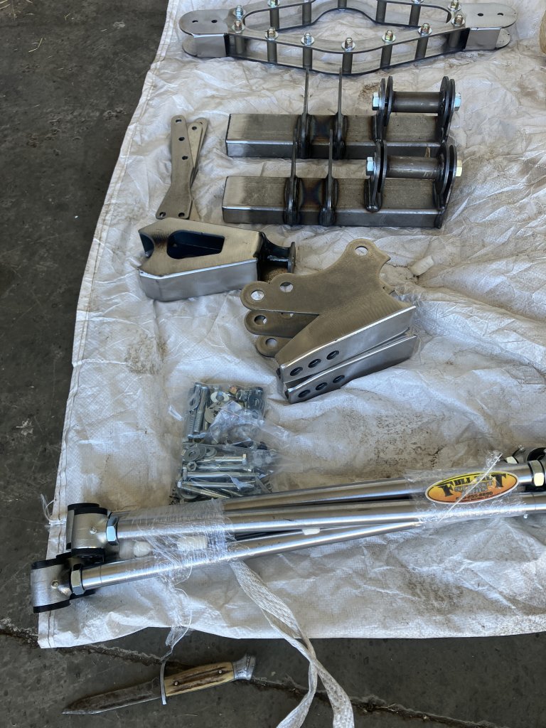

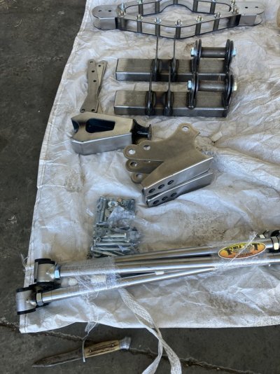

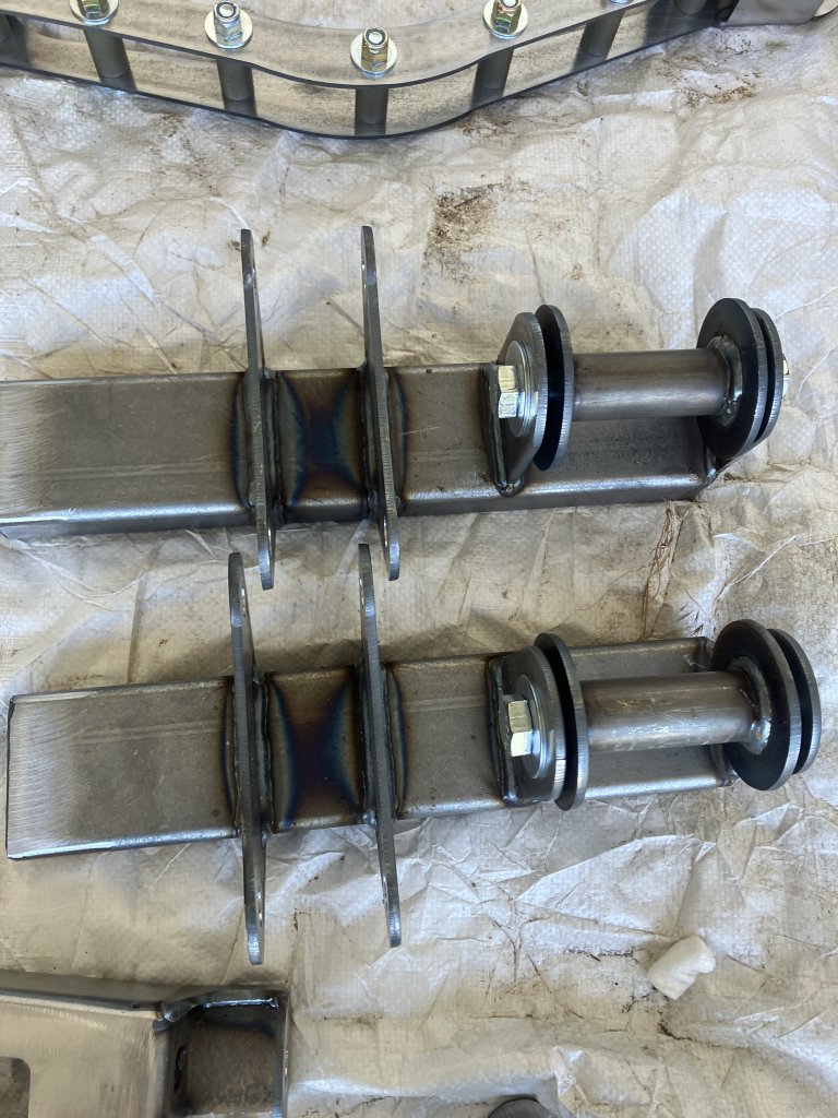

Here is the sub frame connector kit from Full Tilt, and looks very nicely done.
Here is the installation video:
