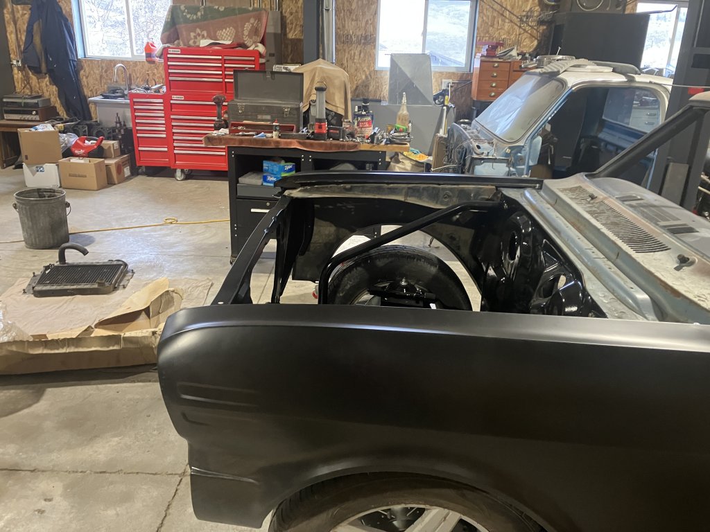

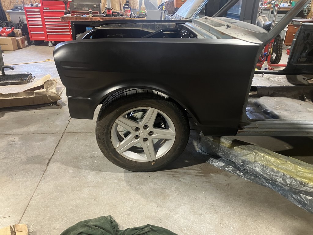

AMD Core support, very nice and the packaging was fantastic. This is just clamped on, but it makes it seem more like a completed car.

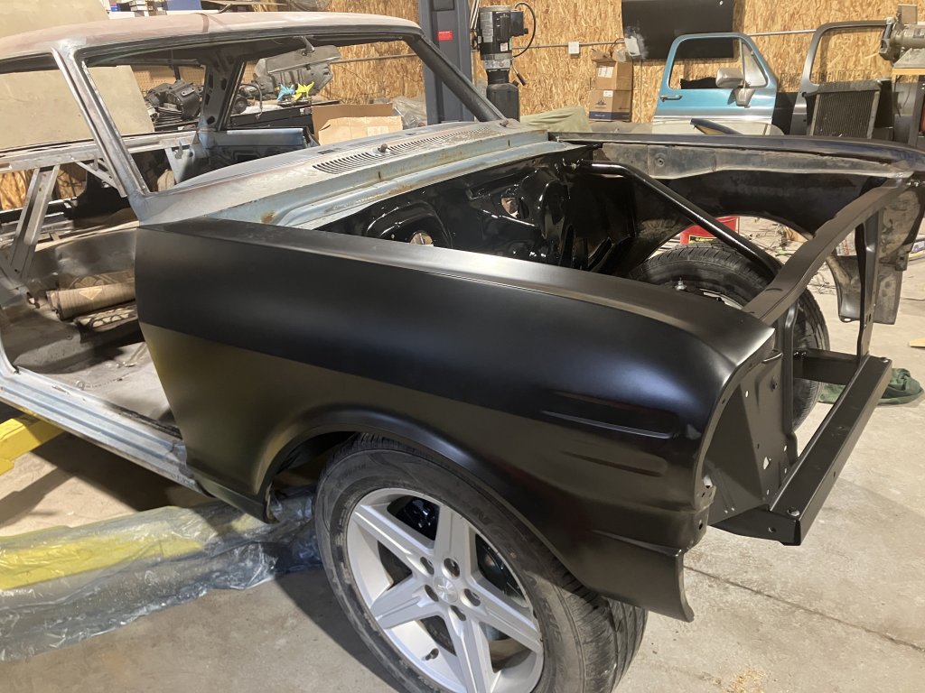

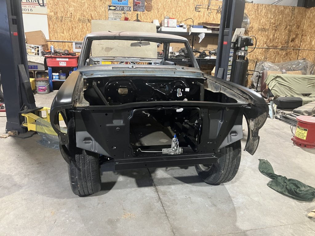

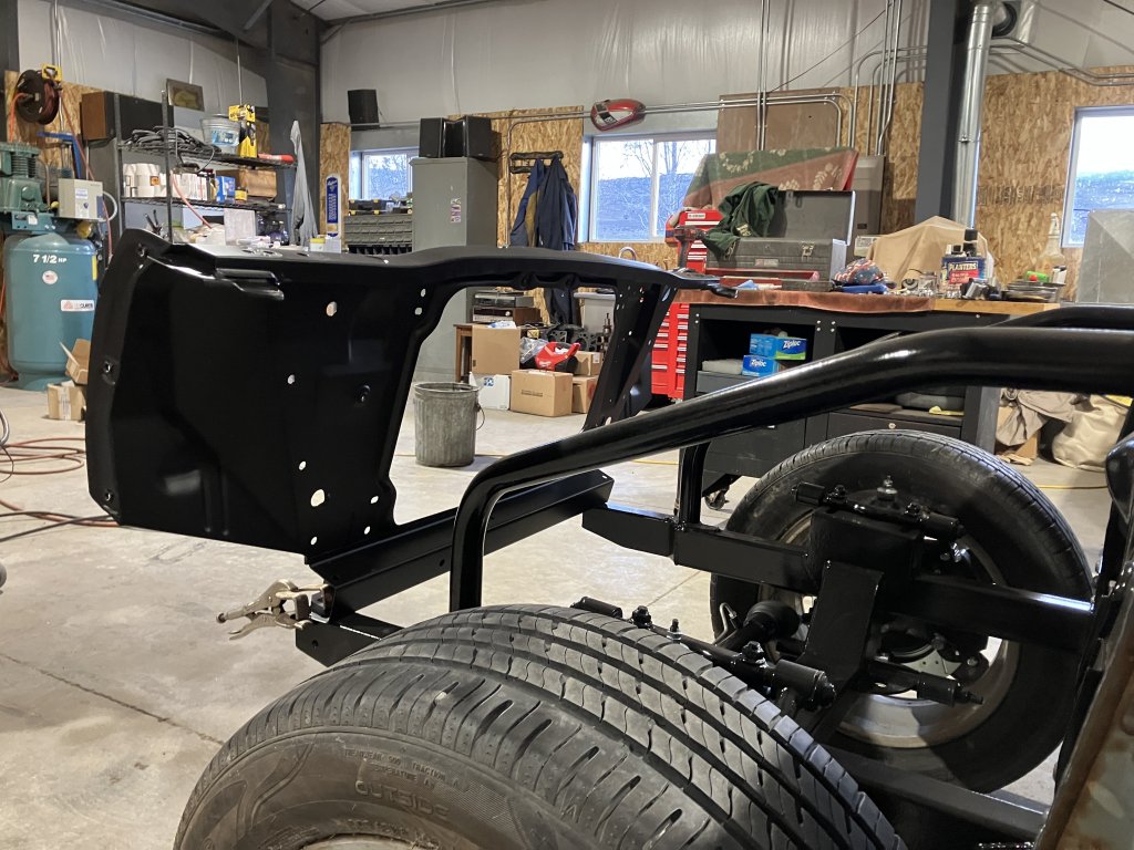

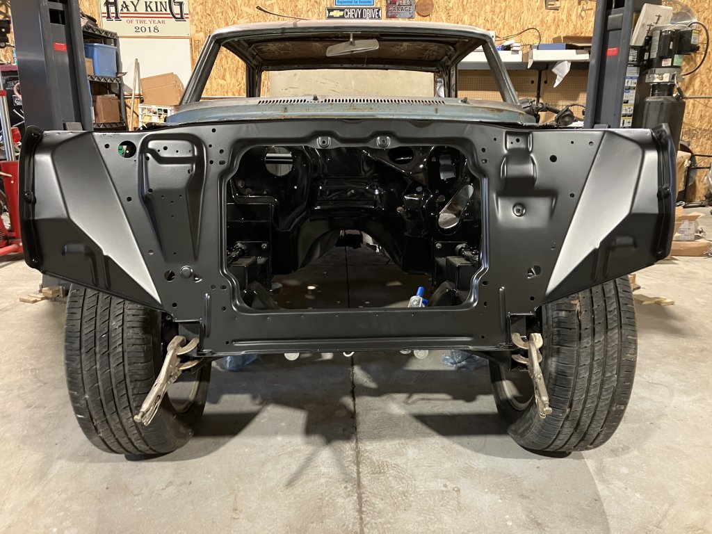

Starting to look like a car

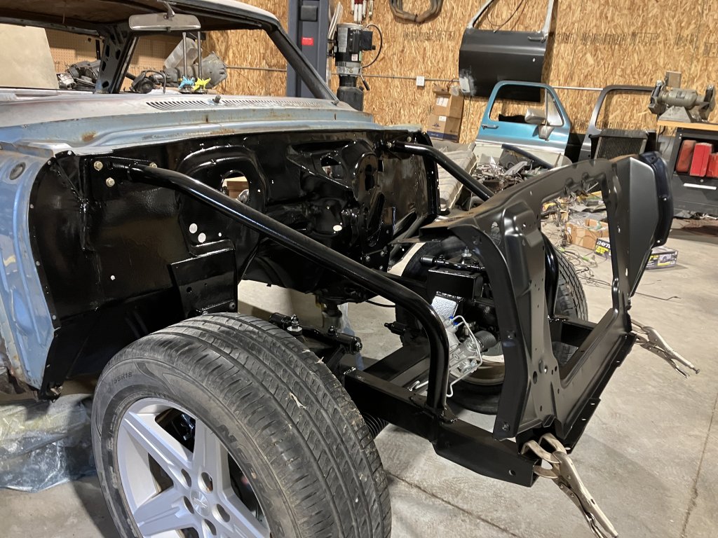

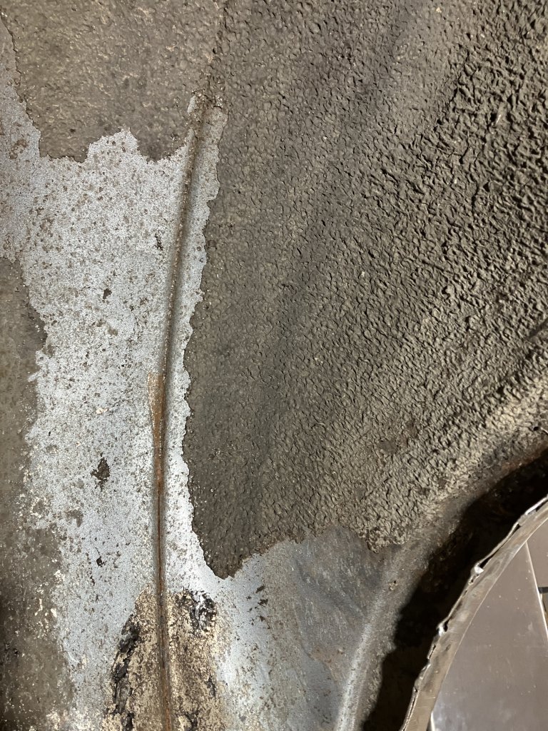

Back half a car is now got all the old under coating off. It’s all on me now. Next is wash until clean, then alcohol everything then seam seal, epoxy primer and raptor line.

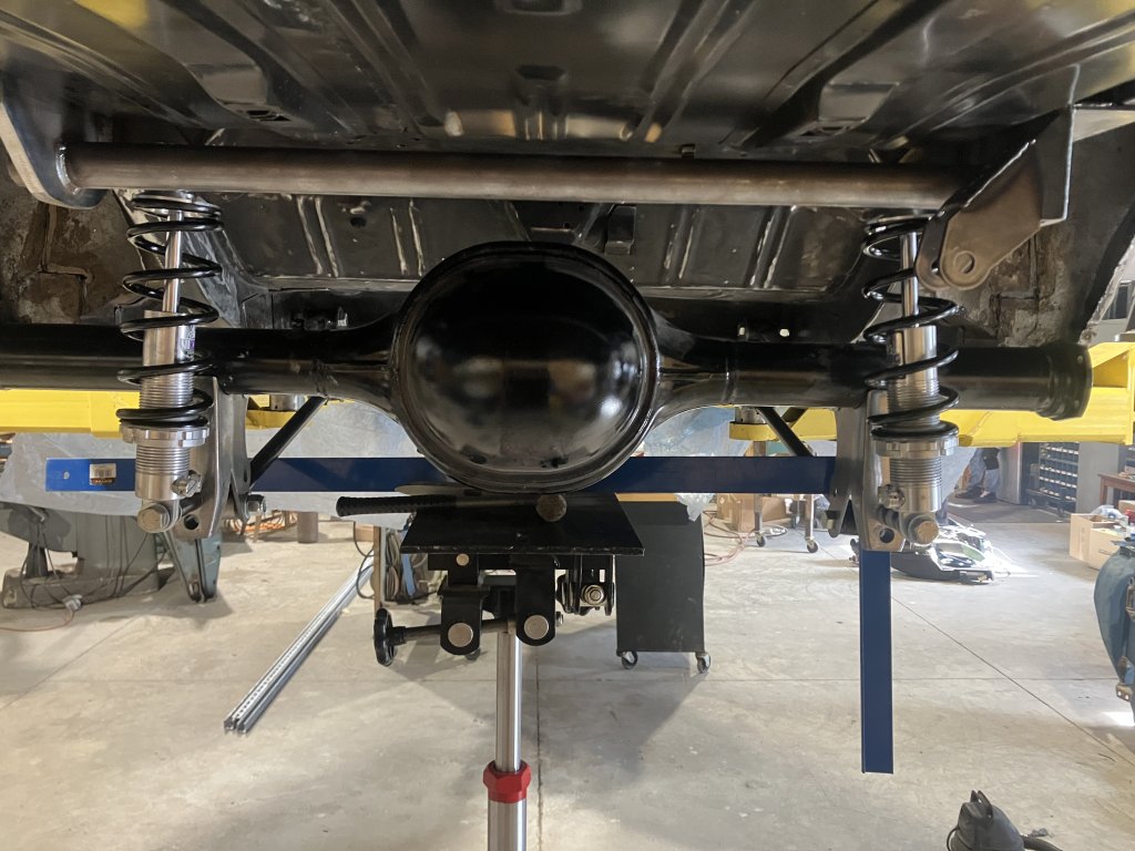

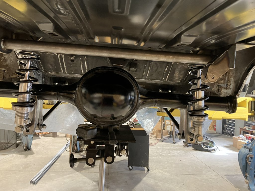

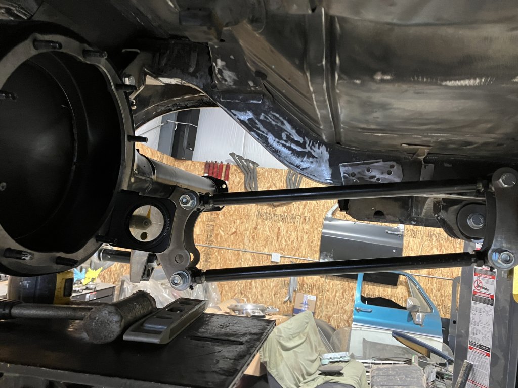

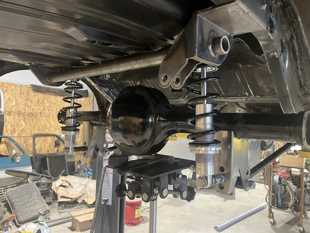

Well, getting caught up with some of the spring work so up to the shop at least got the rear end kind of hanging in there it’s not welded or anything, but it’s exciting. Hope to get up there in the next day or so to get the rear end all set up and welded then it’s raptor line the car, paint the suspension.

The one thing Ford did right.Hard to beat a Ford 9 inch. And the advantage of a drop out 3rd member for quick gear swaps too.
35,125
43,703
Very true. The quick gear swaps are expensive though, since it includes another carrier, center chunk, etc.
47,813
10,939
It's not that bad. You can usually find a good used drop out 3rd member ready to roll for cheap. What we did in the race days, we take ours build it with our 4.57 or 4.88 ratio with locker or posi to race, then pick up a cheap used 3.07 peg legger for like $100. We'd install the 3.07 drive South 2 or 3 hours to the track of choice, On jack stands swap in the race locker unit and race all day. Then swap it back to the 3.07 ratio to drive home and leave that in to get back and forth to work for the rest of the week. Come Thursday night, put the 4.88 back in it and be ready to go the street races Friday night after work, a couple hour nap and then be up til daylight racing and stabbin' cooter. That's what life was like then. If you was lucky, you got to keep the cooter for the rest of next week and let ole girl stay at the house and cook and clean while we worked on the cars. Yeahh, some of them girls got around, and I think we all got our chance to take some of them for a ride for a short time, til we passed them off, or they left and moved onto the next fast car. All you needed was a fast car and... anyway, yeah drop out 3rd members were nice. One of my buddies, he carries his 12 bolt in the back of the El Camino. We'd have to do the whole rear end swap, but we did. He had the 3.08 peg legger 10 bolt, and the 4.56 locker 12 bolt. I liked dropping 3rd members better trust me.
3:90 Detroit position, just right. Fast off the line, but still cruse at 80 out west in Idaho, where Jan and I are moving. Not to close to IdahoVette though….
I had that ratio in a 62 Chevy pick up. I broke that rear end about 10 times but I sure loved that ratio. Just like you said, a good all around ratio. Back then the speed limit was 55, so it worked real nice. I could easily do 65 on a truck tire with a Muncie 4 speed but yet low enough with Muncie and unlimited stall, Rev it up to about 3000, side step and dump the clutch and you're off and running !!! You just never knew when the rear end was going to break. Was it going to break on launch or slamming 2nd? I knew once I got into 2nd, if the tach didn't fly to 8000 start floating valves, I'd finish the race. :lol:
