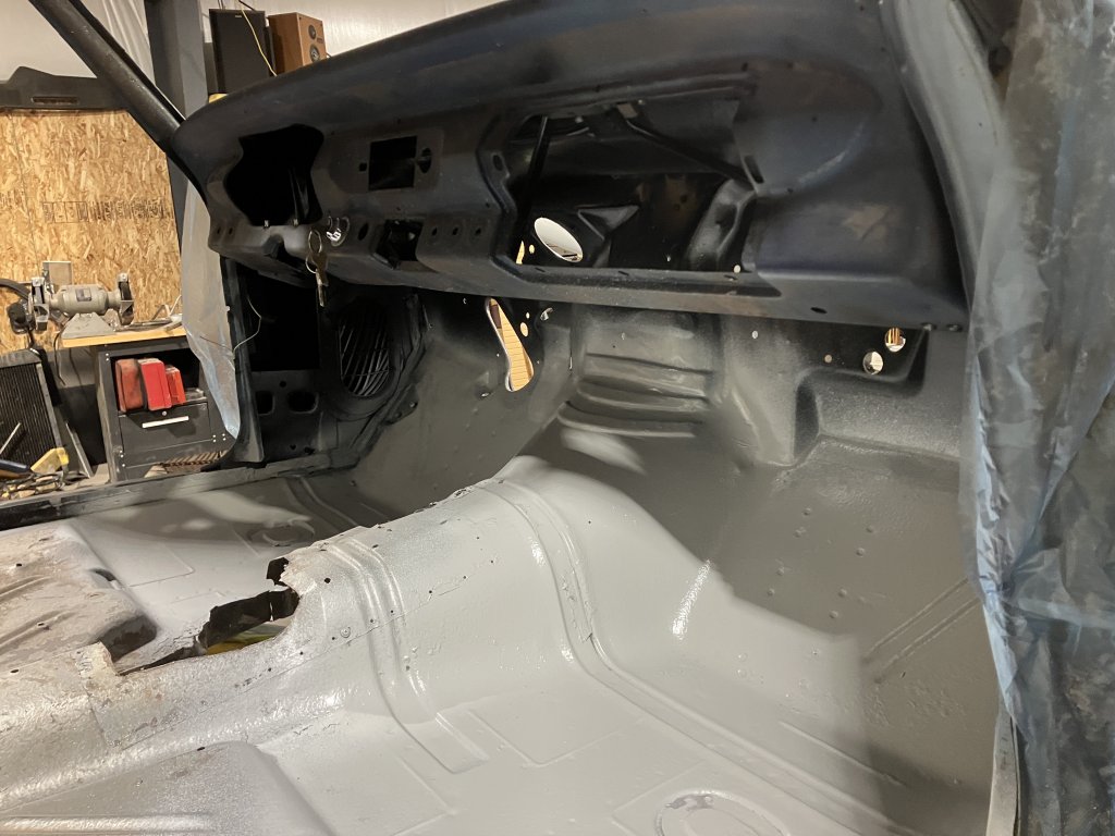

Masked and cleaned again then primed. Using PPG lamabase epoxy, seems to stick good. First coat used 1/4:1 medium reducer for a sealer, second coat 1:1 primer, activator. While you don't need to sand, I will be doing seam sealing, and filling a bunch of spot welds with bondo. then sand smooth and top coat.

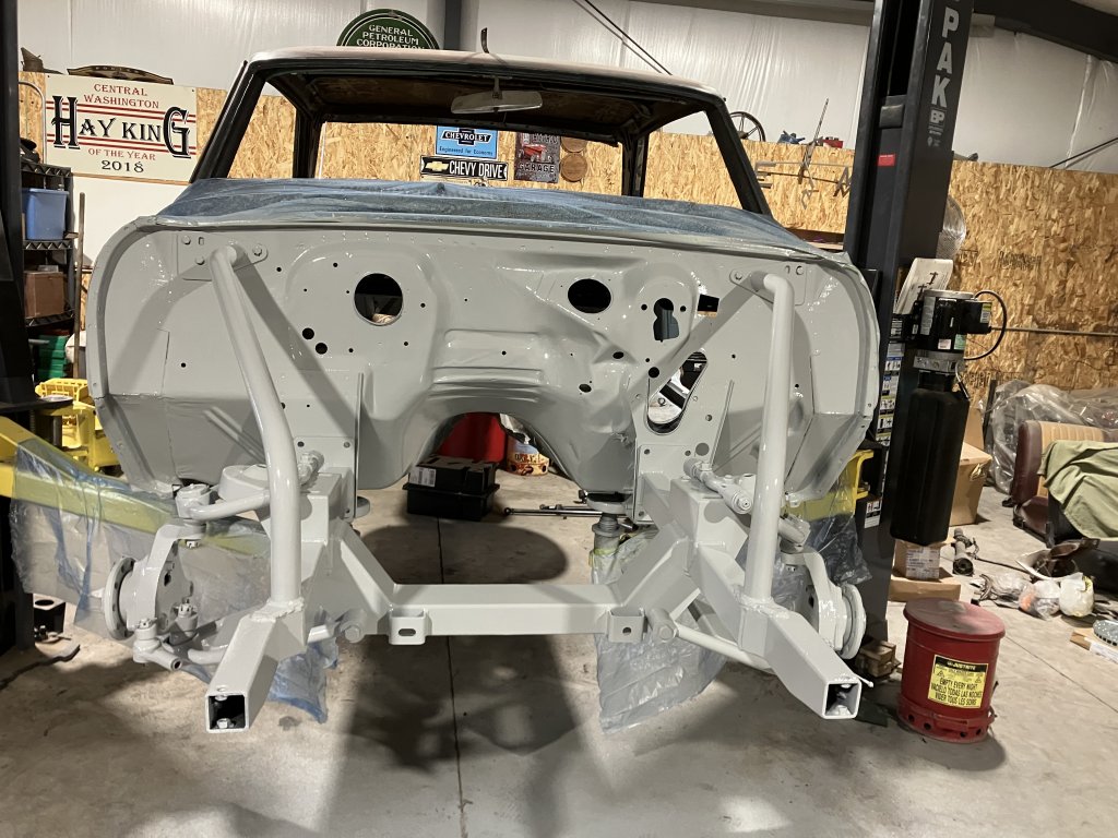

It is a wonder these shoe box cars lasted as the craftmanship is lacking. seam gaps, holes where two panels were attached......anyway I am fixing all that as I am going, seam sealing welding, patching you get the drift. Still a long way to go, but getting paint on the car after 15+ years is very encouraging.

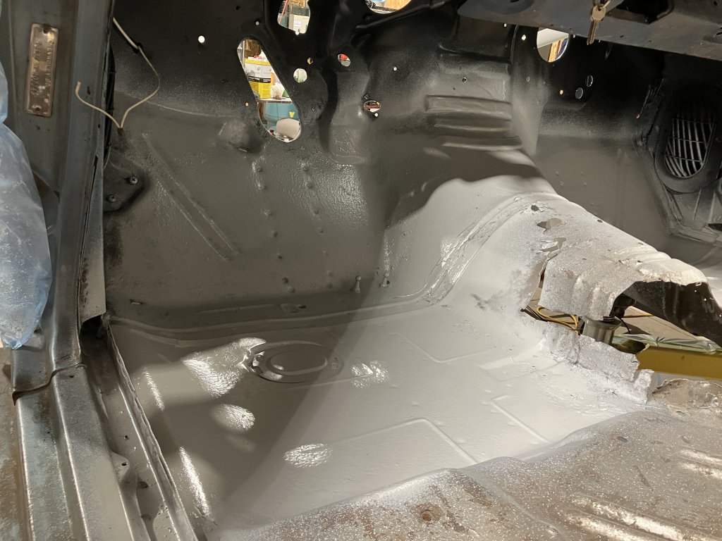

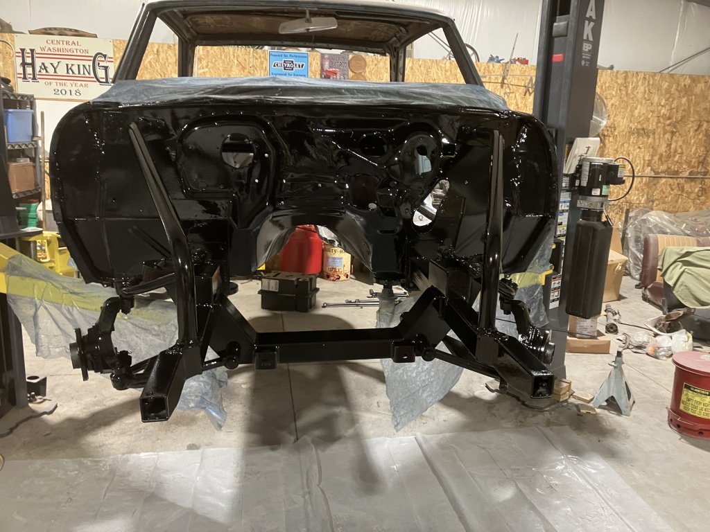

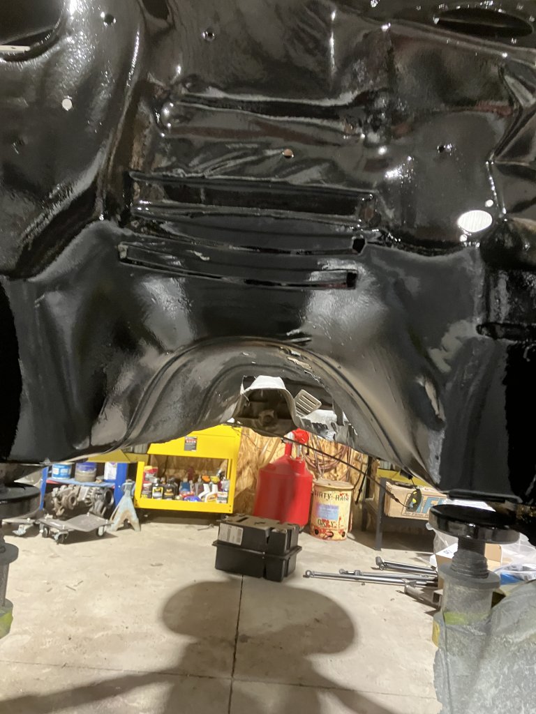

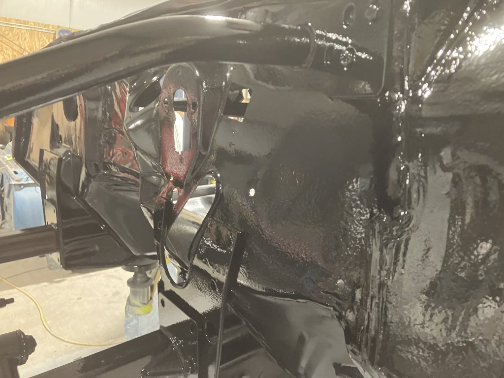

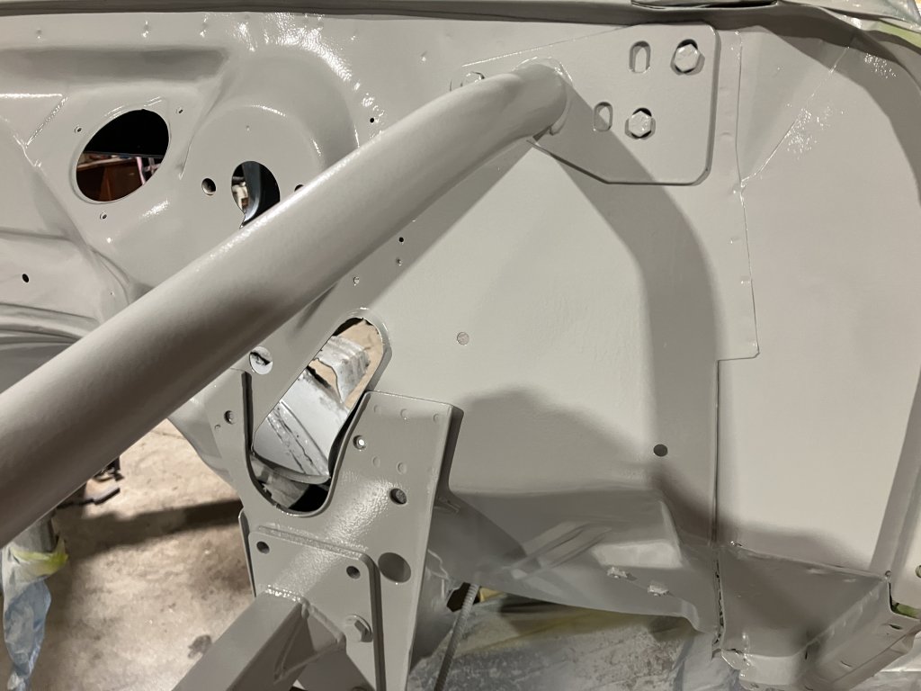

Got er done. Two coats black then two coats clear with flatter. Never used flatter, it goes by weight. I do have a scale that weighs in grams, so it was easy. Just look at the chart they give you, and pour that many grams in. This was a two stage clear, so clear, activator, flatter. The shop reeks. I will go up tomorrow for a peak. I sealed everything on the firewall, much more then the pics I posted.

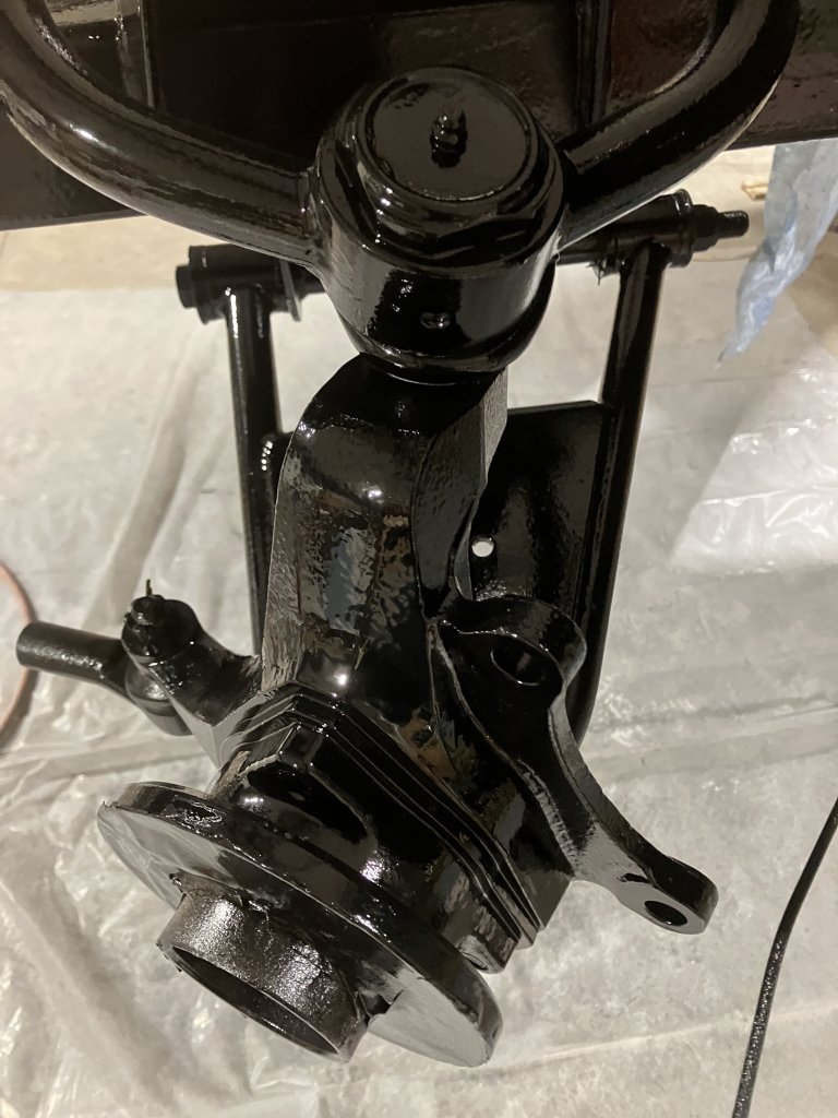

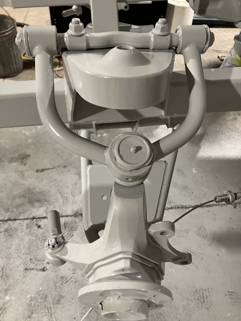

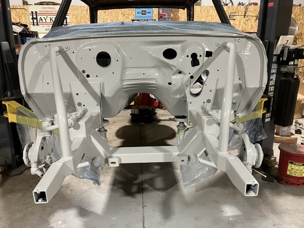

I just sprayed in the shop..............tomorrow will tell the carnage/overspray. I have the heater set @ 75 deg., as I am using a medium reducer, or activator. I need some more primer, so will get some tomorrow as that is town day. I want to do the roof next, as that will be a day job, and it looks like not to much fun. I will demask tomorrow, and maybe finish the front suspension as then it will be a roller. I still have to remove all the original suspension, and then clean, primer, raptor line the underside. There are mods to do as well to fit the suspension in, and I am also cutting the bump stops out for more tire clearance. More boby work, but not bad. Later

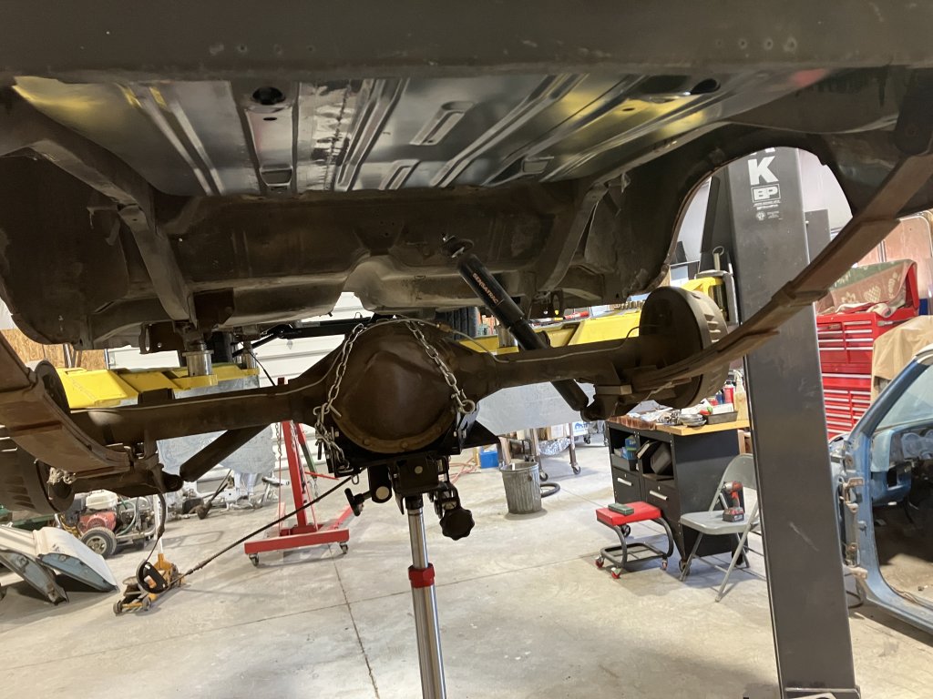

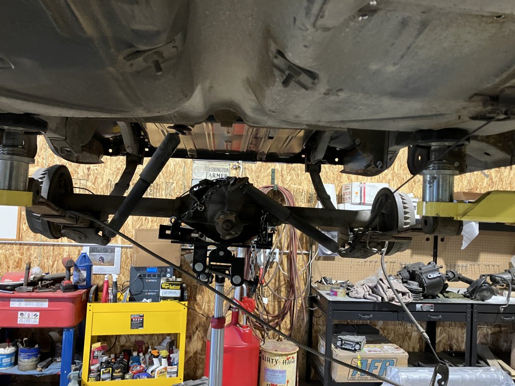

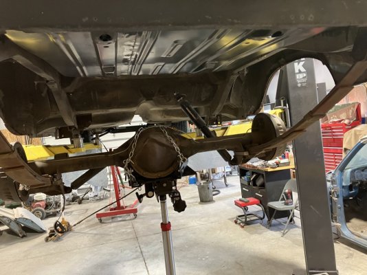

Got the old 8.2 and the suspension out, not to bad being by myself, the trans lift is very helpful.

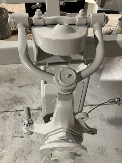

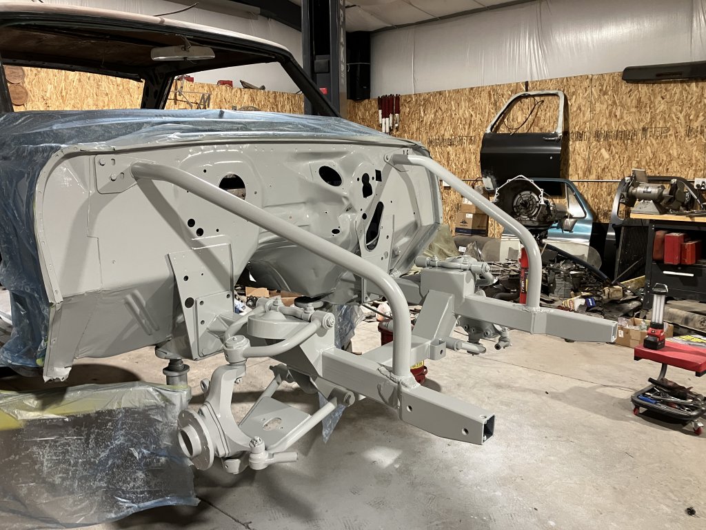

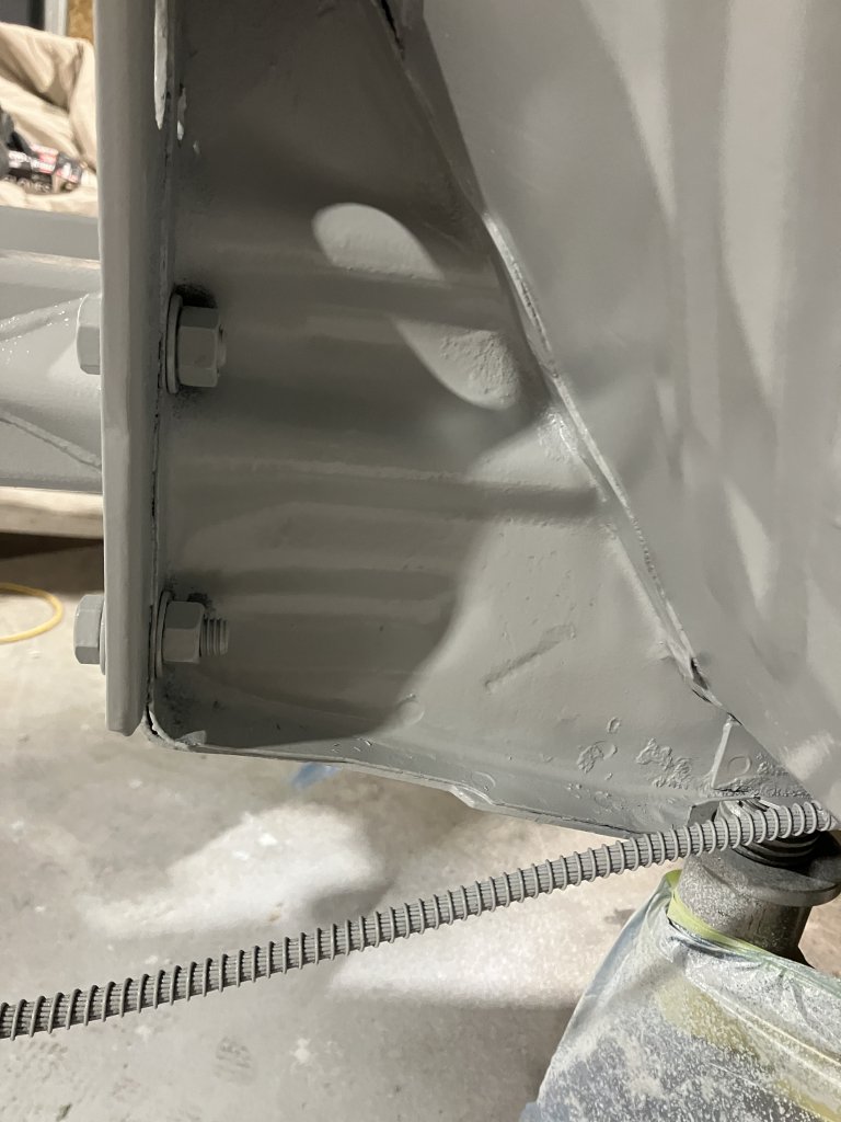

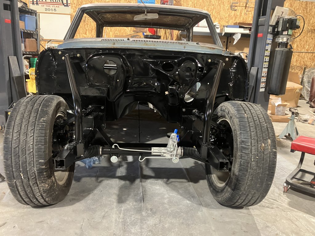

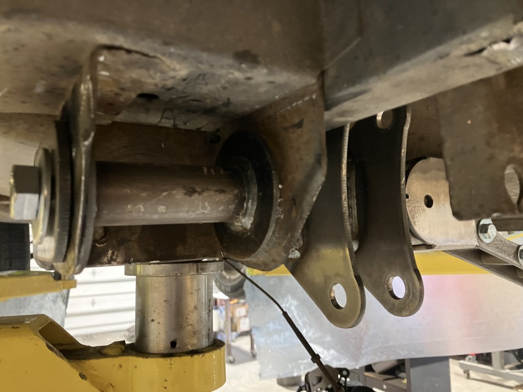

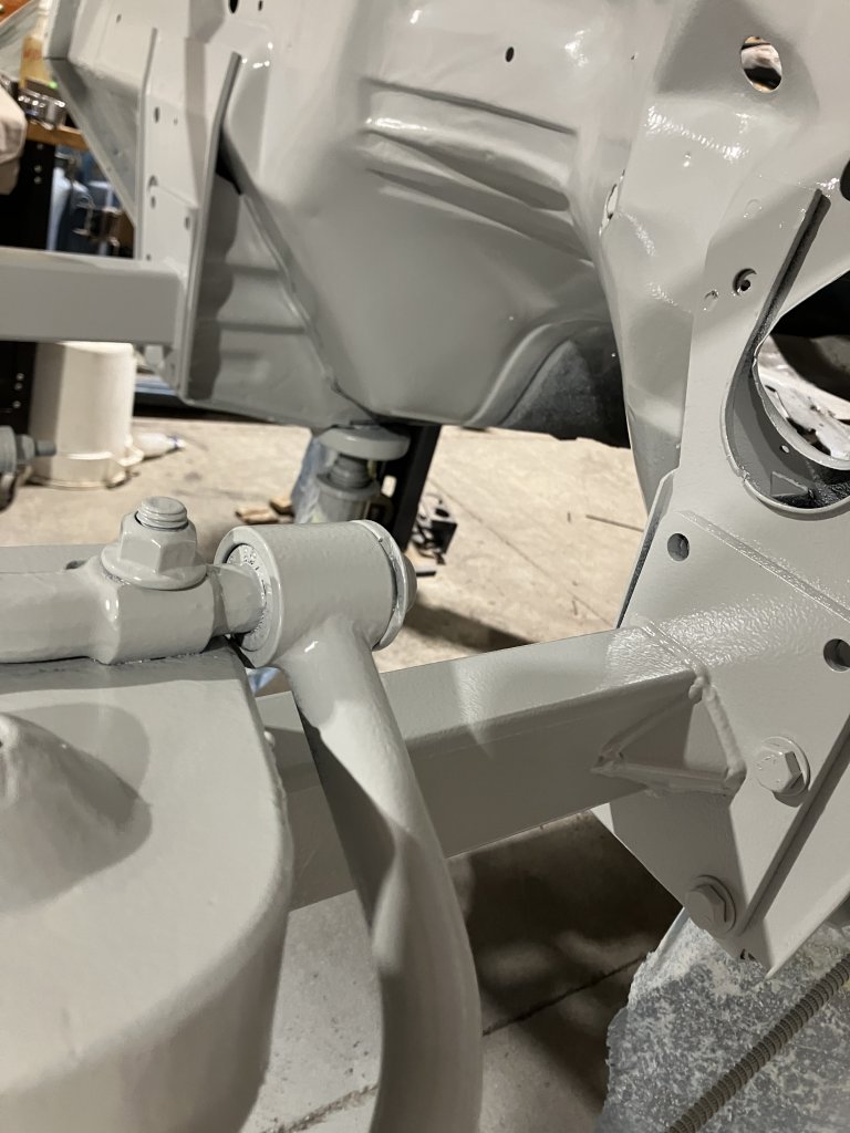

Today cut out anything I don't need, much cleanup, and had to modify some big washers to fill a hole where the front leaf springs have a 2.44 dia. hole on one side. I did not get them welded in, but got them to fit. Everything is clean where the new suspension is going in, the sub frame is surprisingly wimpy. Tomorrow I hope to install drive line loop and shock mounts. I also bought a new front core support from AMD, should be here in about a week.

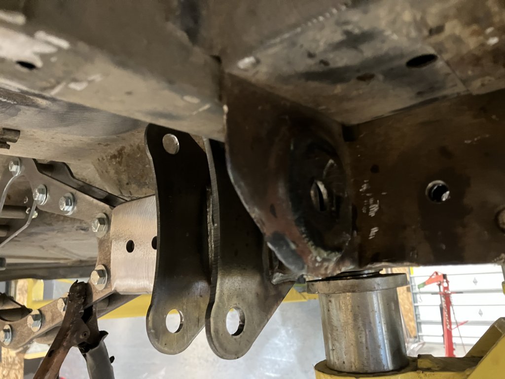

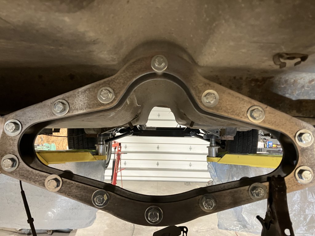

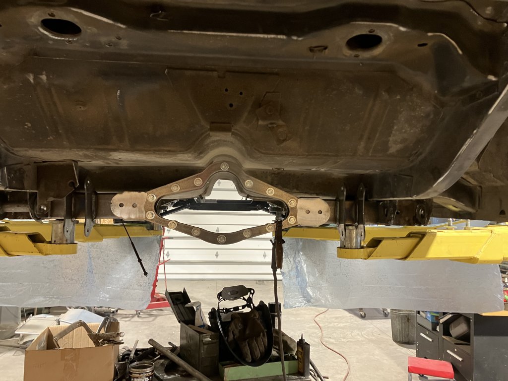

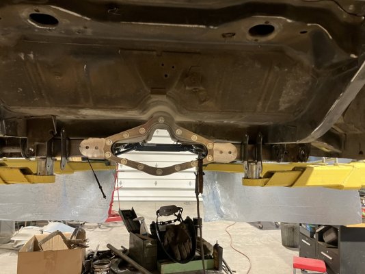

This was a major P---er, but I finally got it in. This driveline loop also has provisions for the four bar setup, and shock mounts. Now that it is in, I will finish welding it in. Also didn't help that the wire in my welder got messed and wouldn't feed. If you ever had to take a spool out, well yeah wire everywhere. However I got it working properly, really love my old Miller 175.

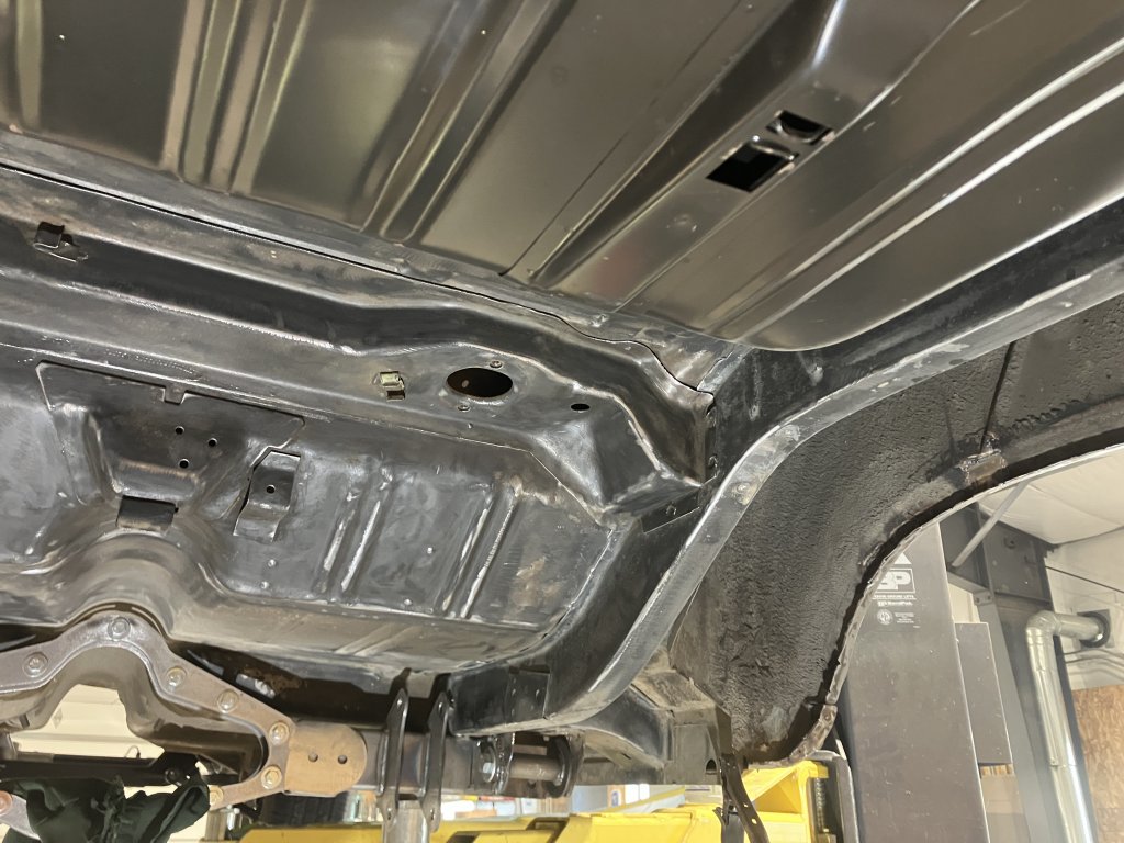

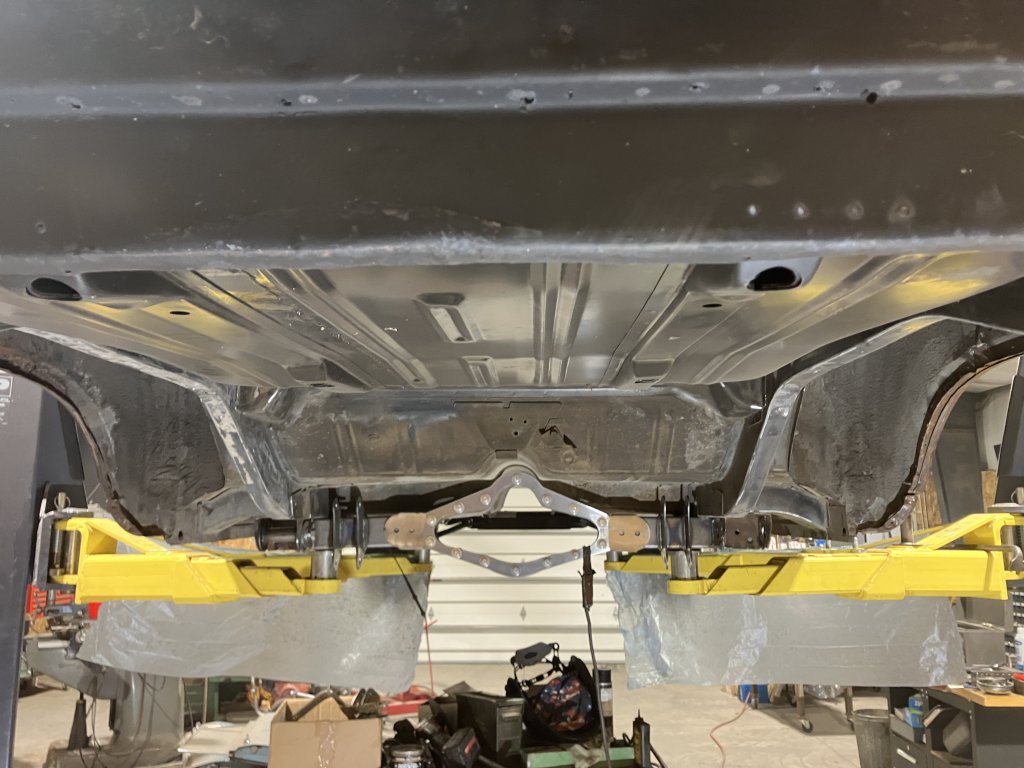

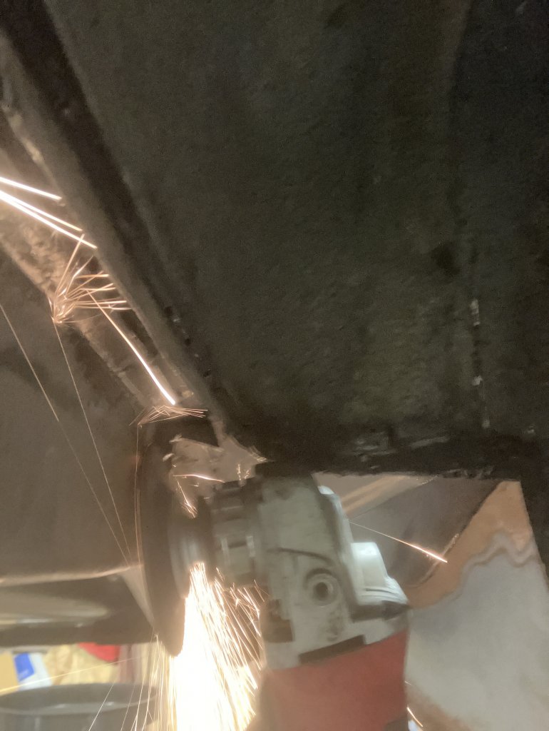

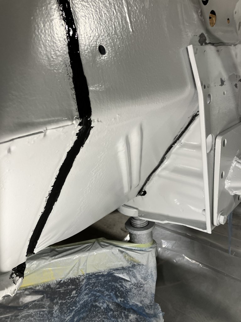

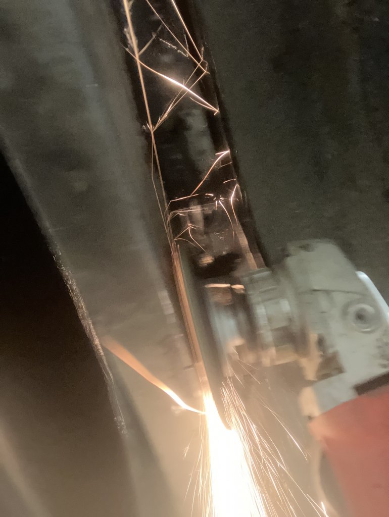

Another dirty day wire brushing and welding in the bottom of the fender. Tedious, but looks good. Almost have the back half clean enough to wipe down for paint. I need to do much seam sealing, got most everything sanded and deburred, hate cutting myself on a car, so I smooth and radius everything under there. This will get Raptor lined after Epoxy primer.

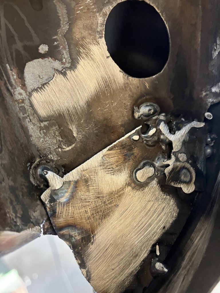

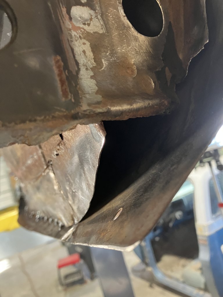

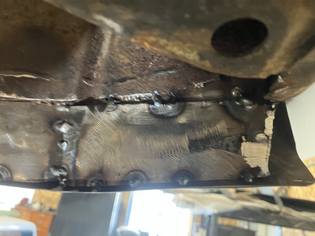

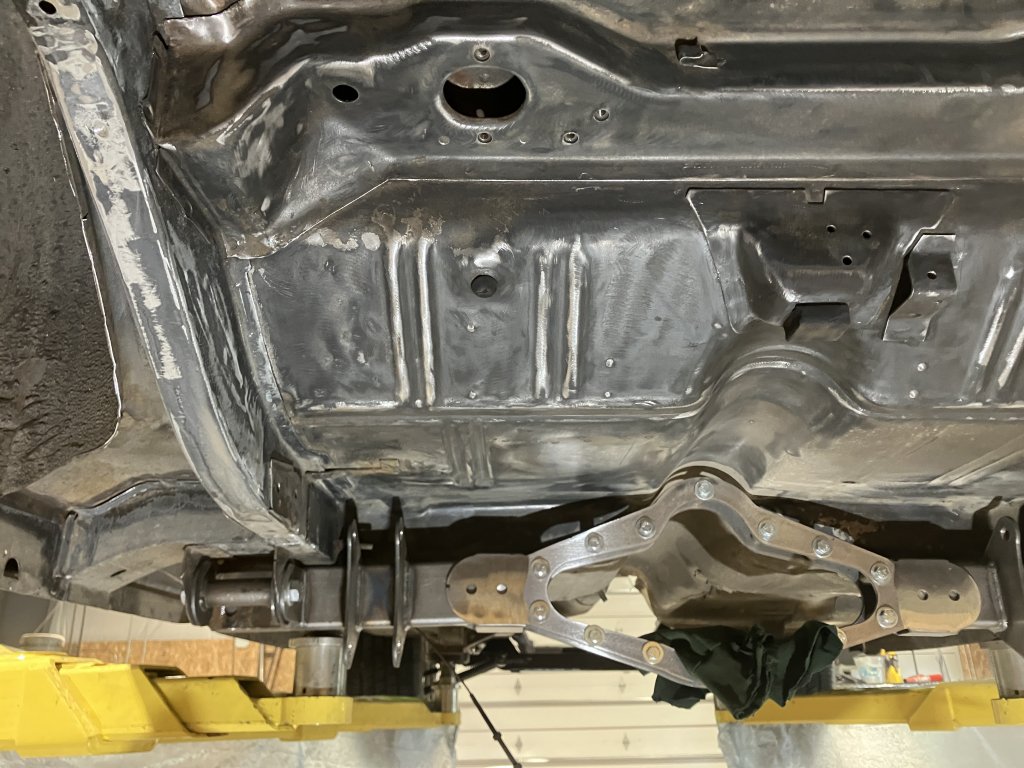

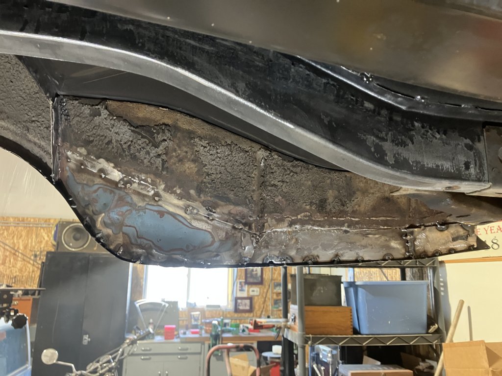

Had a hole, this is the repair, not pretty, but solid and sanded. Again this will be Seam sealed and painted, rhino lined. That completes the back half. Still lots of parts to go on, but got the yucky stuff done.
