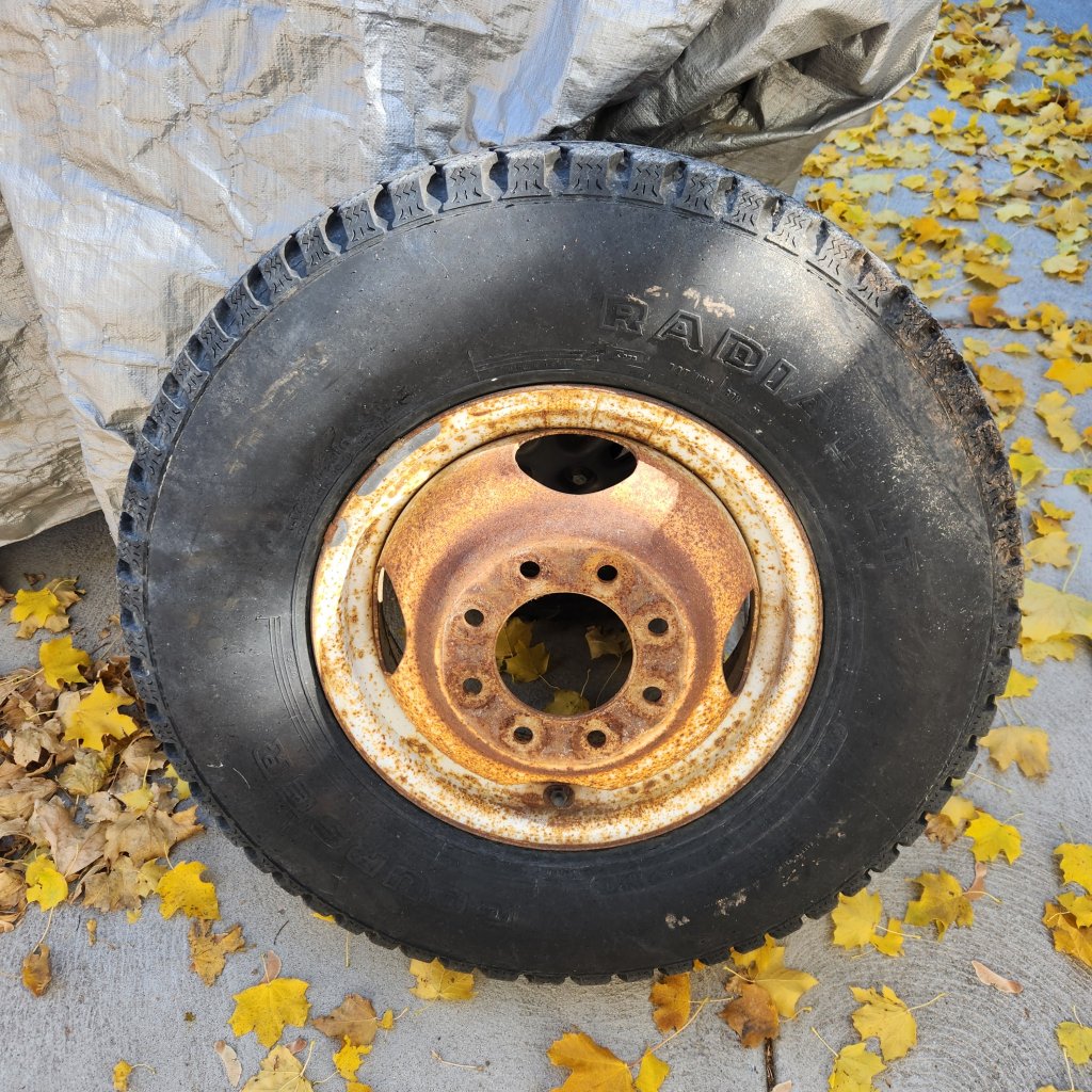

My 1980 GMC k 30 dual wheel truck came with 16-in rims from the factory, tires for this 16 in are getting harder to find so I thought of upgrading to the 17 in, the problem is GMC went to metrics and finding a set of dual wheels that will fit that can be a challenge but I found that Dodge did not go to metrics on their bolt hole spacings until about 2018 so I found a set of 17 inch rims off of 2010 Dodge 1 ton dually, the bolt patterns are the same as 1980 but the center hole is a little larger so my only concern is will these rims center themselves on the hubs when I bolt them down or do I have to do something different? I appreciate all your help and advice!

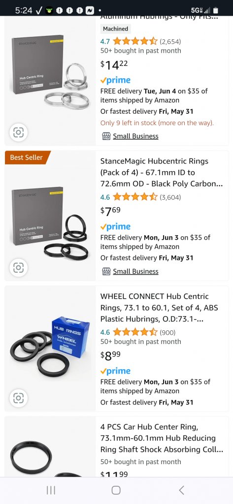

Thank you for your replies, a lot of good information. They make hub centering rings all the way up to full size adapters, some of these rings are made out of the tea grade aluminum some out of polycarbonate.

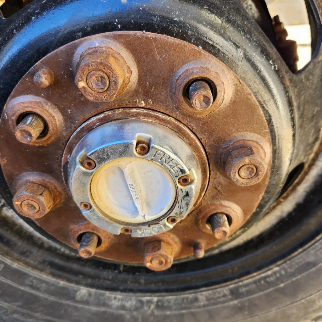

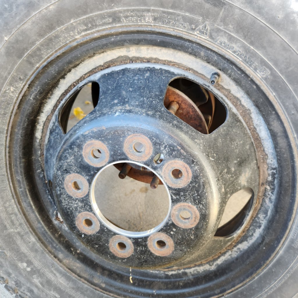

Update, I bought a set of hubcentric rings for my 1980 GMC dually to mount 17 inch wheels from a 2010 Ram 3500, so far so good

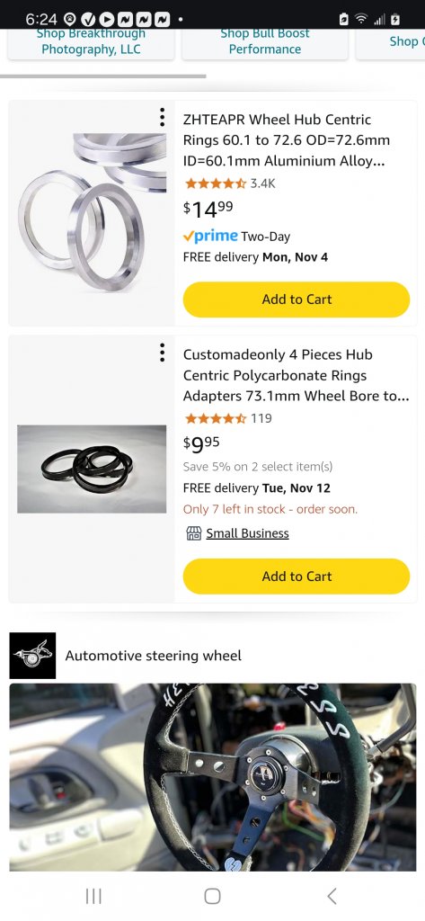

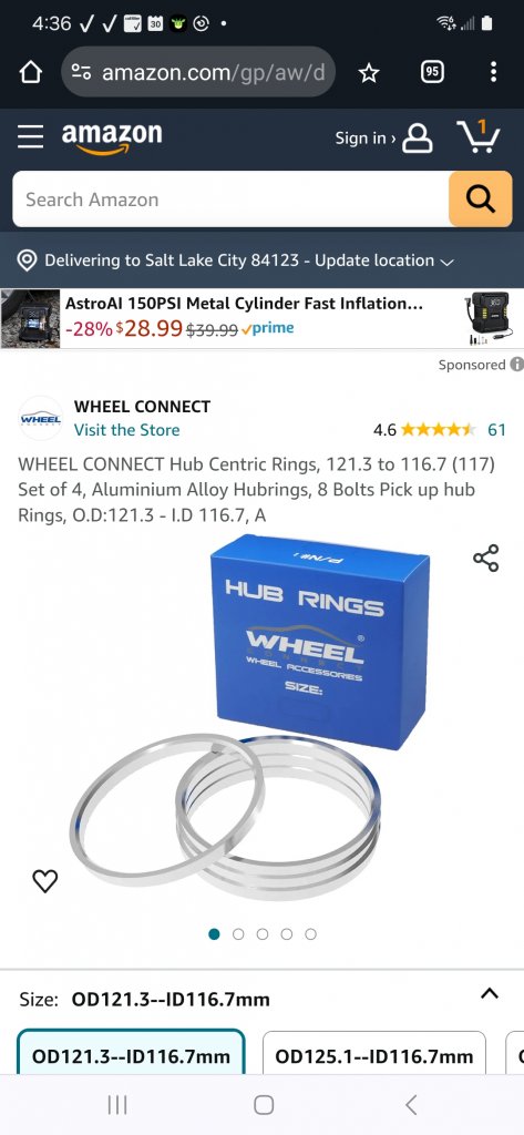

I bought those rings off of Amazon, they have many different sizes made out of different materials.

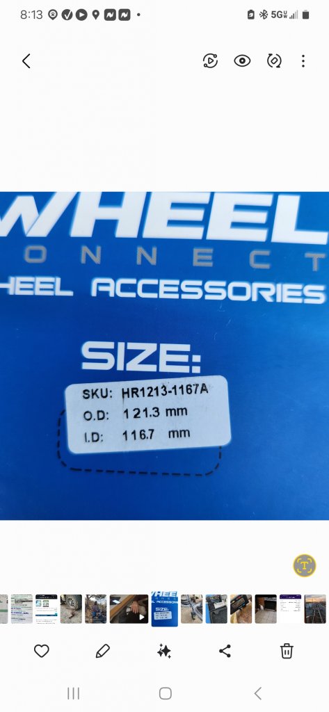

On a side note they fit snug inside the rim, the outside diameter 121.3, mm but they fit a little loose on the hub, 116.7 mm inside diameter. When I measure the hub diameter of the original rims it measures out 115.7 mm, maybe this small difference won't matter?
