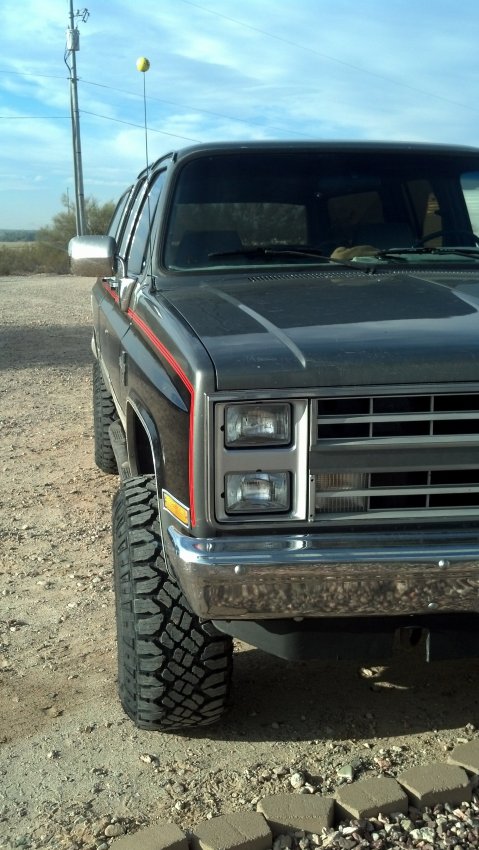

Yes the front axle is a little wider and the front fenders turn in a little also. I would try the 14" wheels first, before buying spacers, they are going to stick out A LOT. They should clear pretty close with a 4" backspace.
This is my 33x12.50x15 on a 15x10 wheel with a 4" backspace. Yours will stick out 4 more inches. And a 13.50 really should be mounted on a 10-12 wide wheel its going to be really stretched on a 14" wide.
I have a Rough Country 2" lift and these tires were a hair from rubbing. With 4" more sticking out you'll need 4" of lift or some fender trimming.
