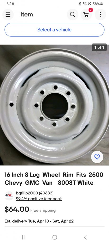

bought a set off ebay from a guy that blast and powder coats them. Think I paid around 75 each...I'll find his site for ya

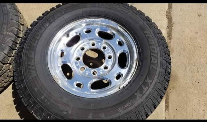

I know I'm going to catch hell for this, but will these fit on my 84 C2500? I know they are Ford rims but I like the slotted look. I need to restore my factory 16" steel wheels and was wanting to go with these as a temporary setup. Maybe add some white letter tires if they are available.

I like those too but no.. they will not fit, those are SD pattern. That's what I have on the front of yellow. Her front axle is from an 04 SD.
