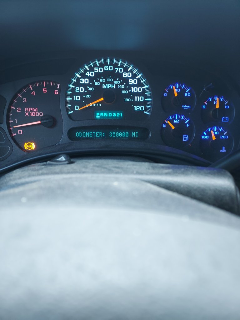

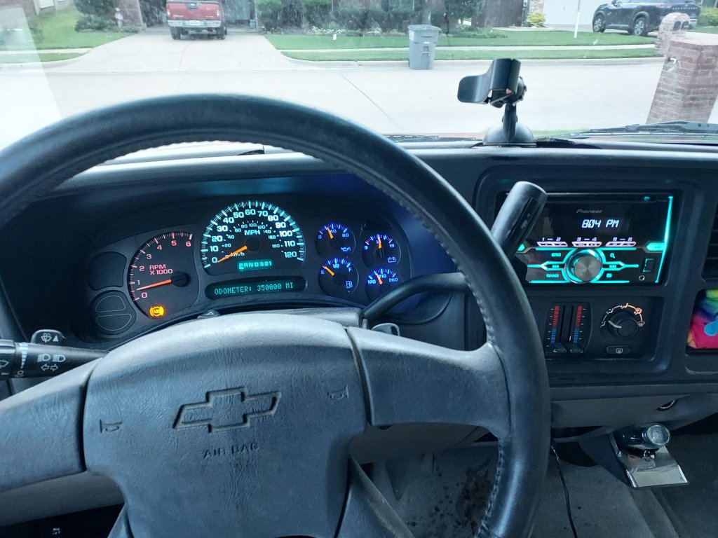

Well, reached our goal of 350k, but she's done. Transmission fine, engine smokes on startup and went through huge amount of oil in a day. I don't have time to rebuild my daily work truck, so sold it to a mechanic who can and searching for a new used burb.
Celebrating the ride, and looking at issues like trans I may have on a newer used, lol

350k, not bad, not bad at all.

350k and needs rings or something already? They just don't make them like they used to, huh?
(And sometimes, thank goodness)
Pat her on the butt and send her home.
6,955
25,673
Dang, that's a bummer. But 350k on any engine is awesome, that motor didn't owe anyone a thing. I just went through the rebuilding the daily's engine thing and it took me quite a bit longer than I'd hoped, don't blame ya a bit for selling her off
