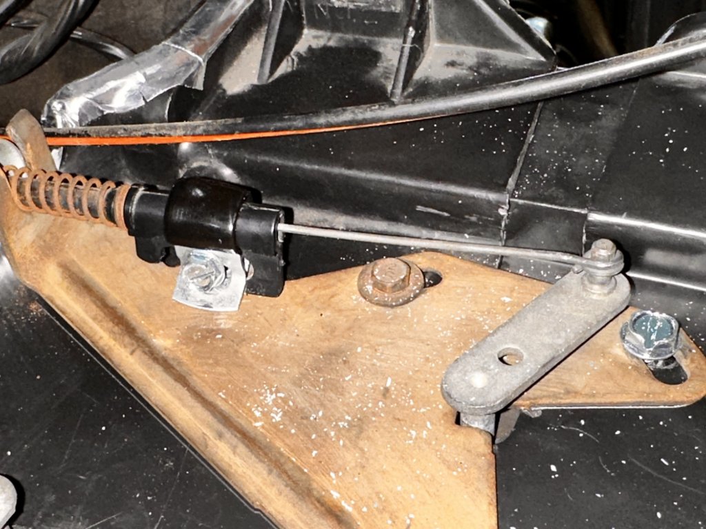

Any thoughts on how to repair this heater box? Was held on with two short lag bolts at the bottom from inside the truck.
And the plastic tab that holds the spring/cable is broken off.
Anyone epoxy repaired, or maybe there are replacement tabs/reinforcements you can buy?
I ended up using an Adele style clamp from the hardware store. Still not finished with everything, so not sure how it’ll work long term. I have the heater box mostly back in and the cable seems to function correctly.
