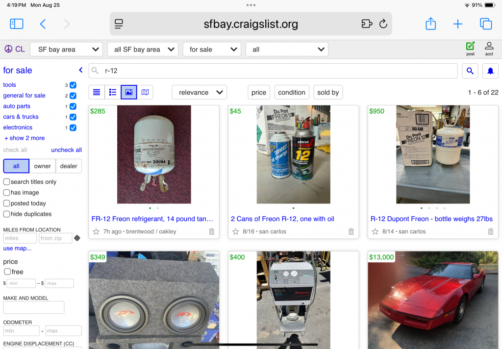

R-12 still available, check Craigslist List, a little pricey.
Freeze12 and FrigC are NOT R12, they were replacements
