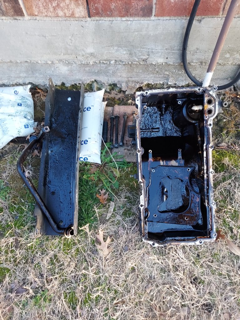

She's got alot of miles...
I put 5.5 oz of seafoam in oil to clean up, and ran for 100 miles. I had a lifter making noise and it bandaided that. No noise immediately. Replacing oil pump o-ring and gasket. Oil pressure been low, but not dangerous, well sure didn't help (lifters).

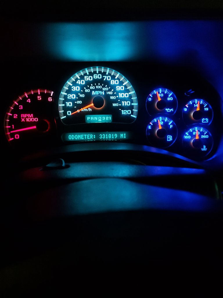

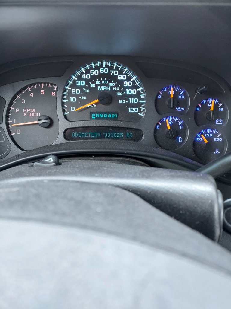

Well, no. Upon start she gets that 38 to 40 PSI but once warmed up to temperature I'm back down to 20 psi at idle so she's just worn out unless I want to mess with oil pump. Opinions?

Is 20 at hot idle bad? Maybe try a thicker viscosity of oil?
Well, it's not good. Have some lifter noise when start up, briefly.
Thought about thicker viscosity, but if it's harder to get into hydraulic lifters then that's not really helping make sure top end is lubricated.
Just worry about lifter collapsing or bending, throwing a rob.
Silly really, she's got 332600+ miles. Worn out. An amazing engine.
4,620
15,289
Man I wouldn't even worry about it, keep trucking. If the compression still checks good and isn't making alot of noise on start up (some lifter noise or piston slap, I would call completely normal and I've had that on several of those NBS trucks with half that mileage), 20psi hot is fine. That motor is far from worn out.

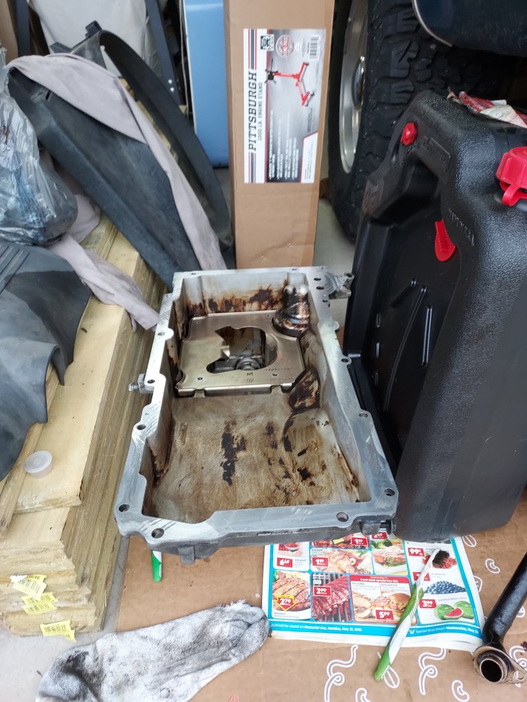

Just an update for those curious. Burb hasn't growled at start-up for awhile. I think after that seafoam clean-up, and been using Rislone since oil change has slowly helped lifters. Just fyi. Oil pressure still a concern to me, but it is what it is. Running pretty smooth engine wise. About 2k-2500k past oil change no lifter noise.

Holy oil sludge batman! Might not hurt to replace the oil pressure sensor, don't know if your era has the screens on them or not. I would imagine if it did it would be clogged up from that sludge!
