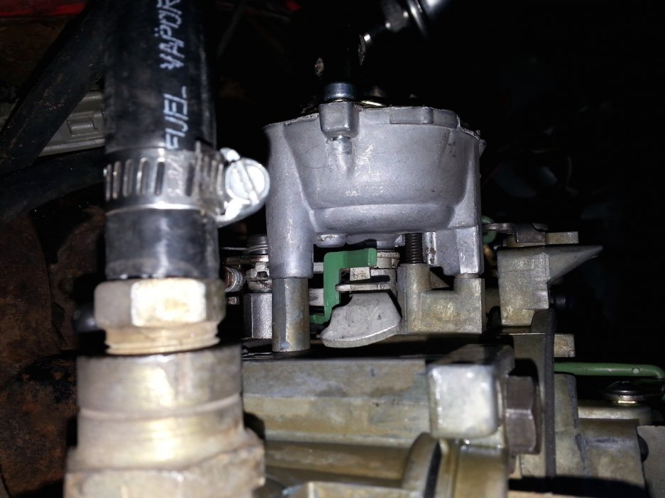

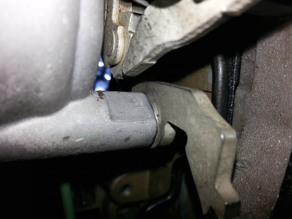

Thought i has this fixed, but i guess not.
Tapping throttle won't take it off, only way to get it off is to push that white cam down.

Pics could help.

And side to side lol. No really both . Mainly a couple close up of fast idle. So anyone can see what the setup

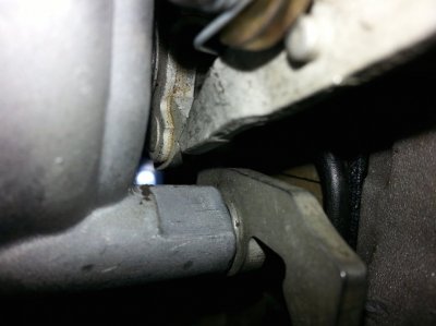

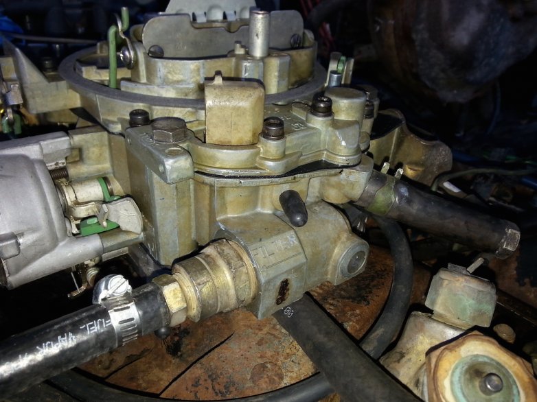

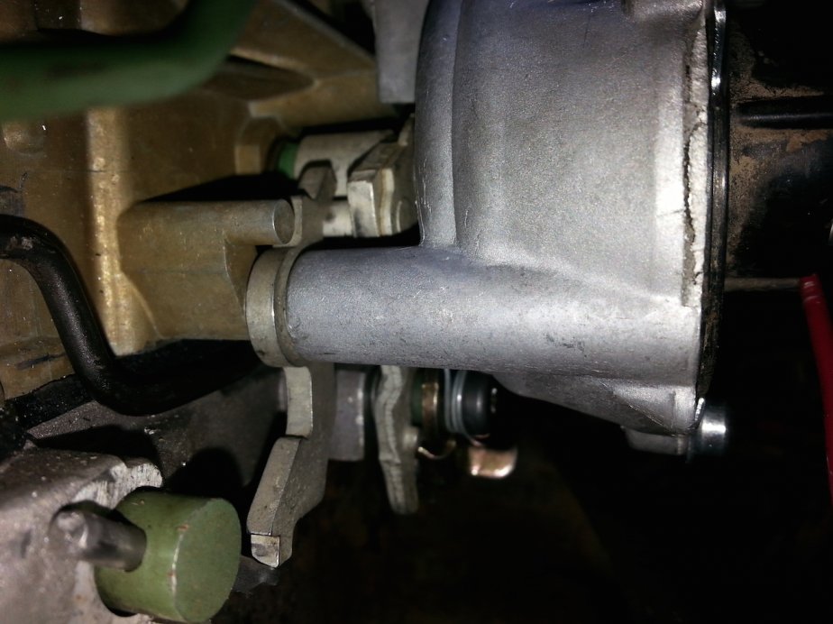

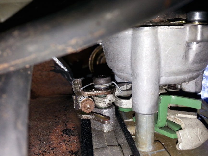

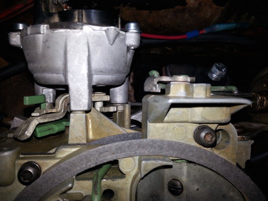

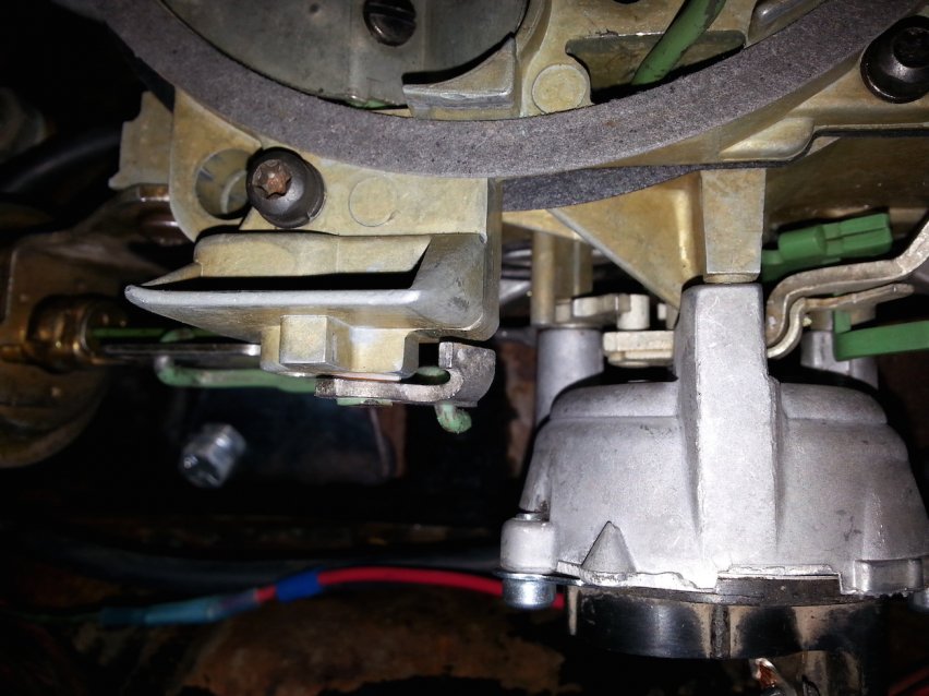

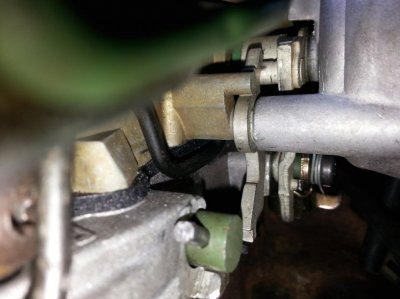

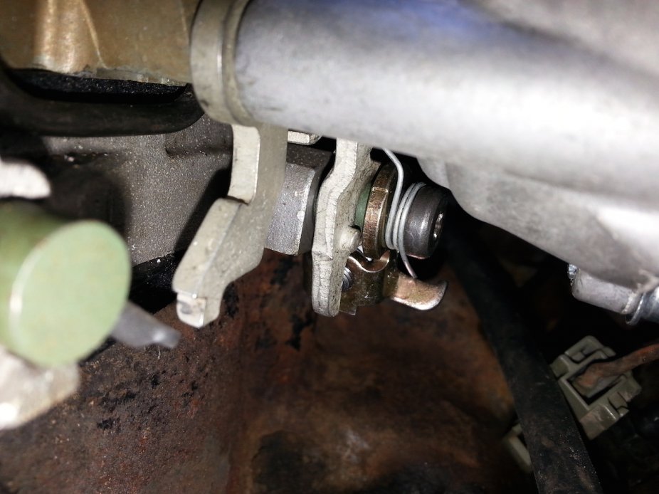

here are the pics with the choke off

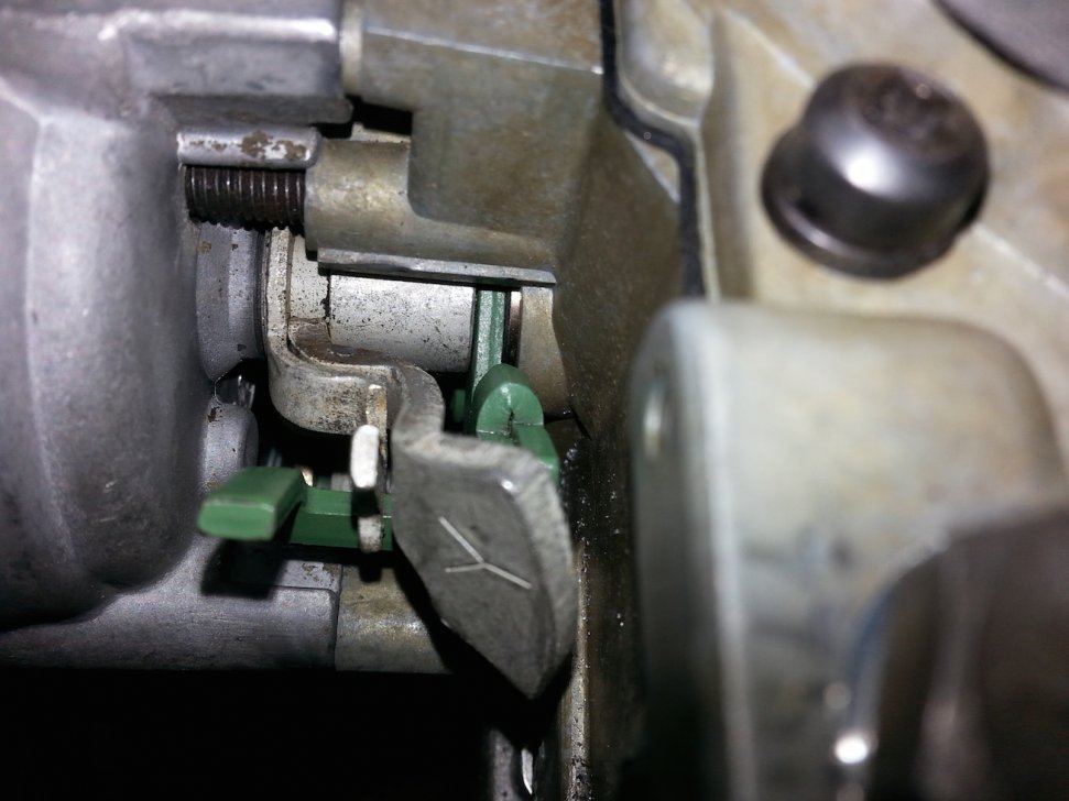

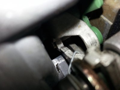

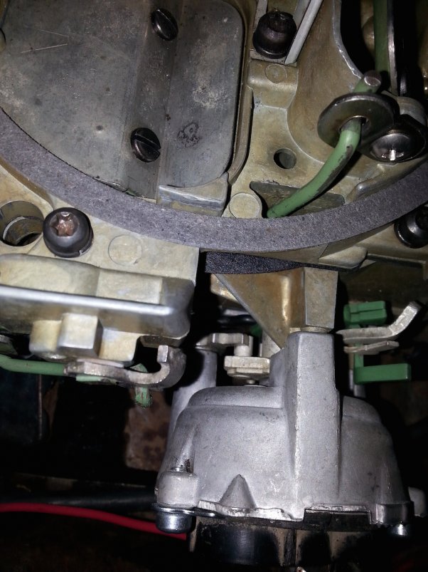

more off

choke off, but this is as far as the cam will drop without flicking it down the rest of the way.
i didn't check the part number on the lower part that actually catches on the cam, maybe i got them mixed up between the 3 step and the 2 step one?

Yup, choke not adjusted correctly. Turned it clock wise and now i can kick it off fast idle correctly. Yay

Glad you fixed it, because I couldn't see anything wrong :)

i couldn't either, even though i have never done this before. definitely learning:)
not 100% sure the choke is set correct, but hey, it works now, i guess we will see what 3 months from now brings:Insane:
