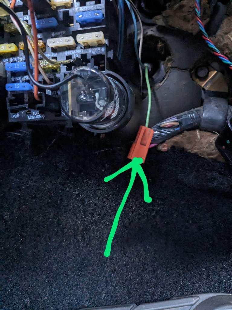

Hey there!
Need to know what is the green wire w/ orange male snap-connector coming from the fire wall into the truck next to the fuse panel??

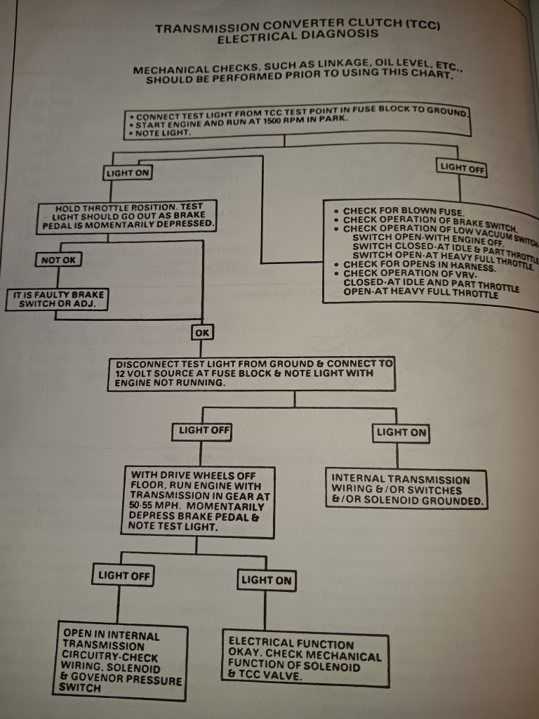

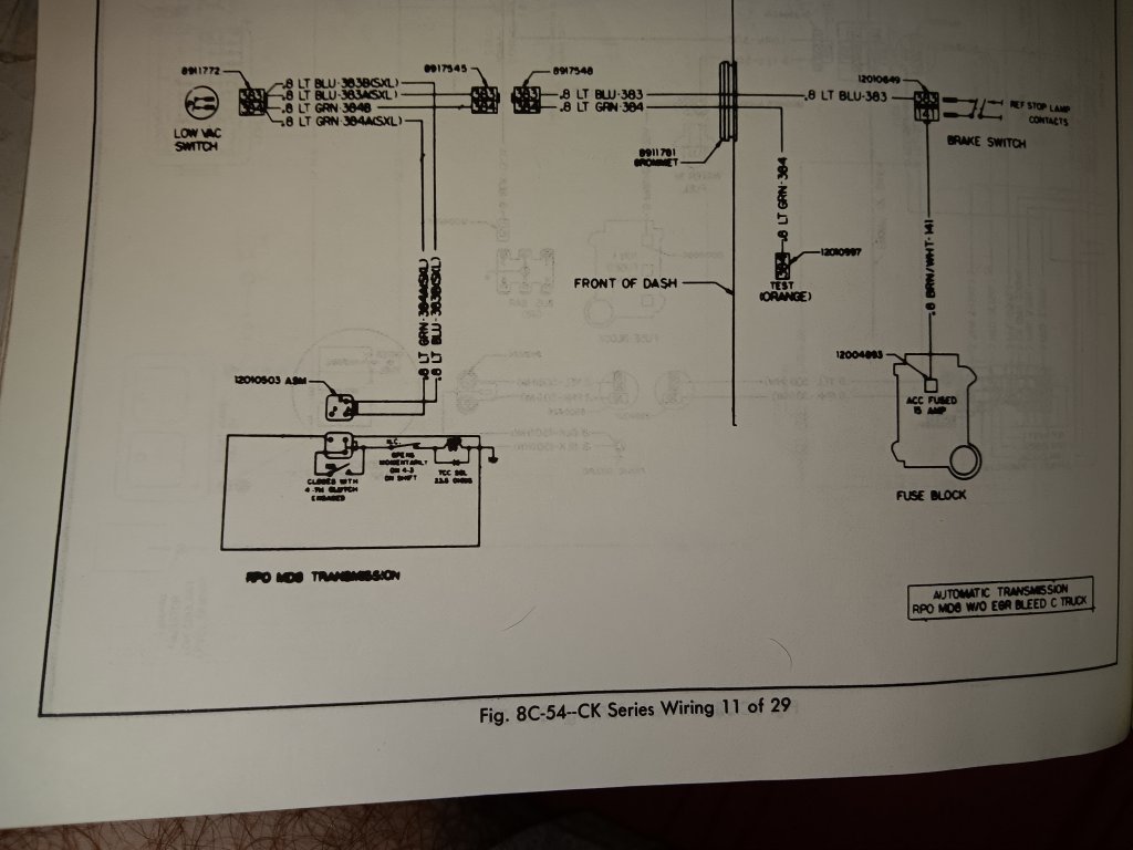

On my 80 that is the test connector for the lockup torque converter (TCC).
I guess that's correct for your 84 as well.
Best of luck!
