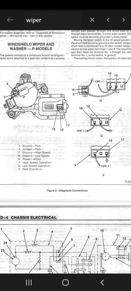

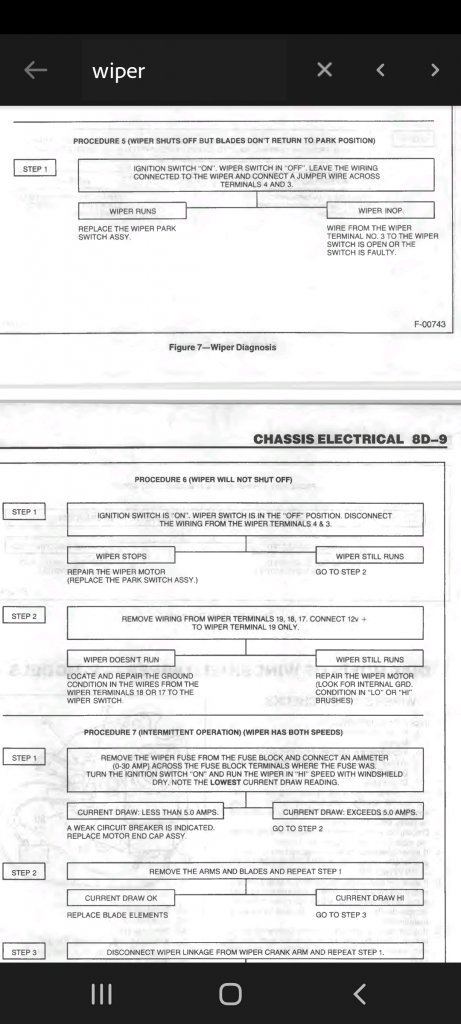

In my attempt to make this old truck great, since spring is coming up and it’s been raining a lot more I figured it’s time to fix the wipers. Ever since I got the truck the adjustment on the stack hasn’t worked, it was on and you could spin it and nothing happened until you hit the end of the adjustment and it was fast until you went back to the beginning, plus hi and lo clicks after that. Recently it’s gotten worse, the wipers no longer park u less I bump mist until it’s back at the bottom. Sometimes it works fine(other than the variable speed) and then randomly it just has on and then you have to bump mist to make it stop. Based off things I’ve read it could be in the stalk, my turn signals aren’t very easy either, you push it down and it doesn’t click smoothly and it takes a second before the dash light blinks, my high beam indicator on the dash also rarely works(rarely use high beams so doesn’t effect me that much, also unrelated to the wipers but it’s all connected to the stalk. ) but it could also be the wiper motor and the park sensor stopped working. Usually mist will return to park if you get it atleast half way up or so, kinda have to hold it a second to get it to take off the full travel on its own. I’d like to replace the stalk if possible since the chrome is peeling anyways, I don’t have cruise or anything and everything I’ve seen it’s just kinda a pop out and pop in new one? I’m not the greatest at wiring and stuff but I have recently purchased my own multimeter so I can test plugs and see if everything is getting the correct voltage when it should. I just need a point into the right direction so I can stop relying on rain-x on the windshield incase my wipers don’t come on one day lol.
