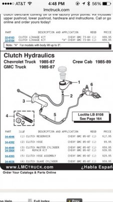

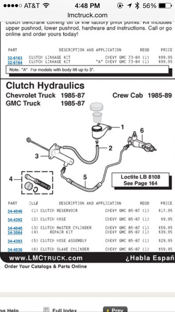

I'm looking for some information on which year GM introduced the hydraulic clutch to replace the old mechanical style in C/K Trucks? I want to find a set of pedals, slave cylinder, clutch cylinder and bellhousing to upgrade my mechanical setup.

Ah ha! Excellent. Now I just have to find a set of pedals and a bell housing. The clutch pedal return spring under the dash broke and I have not been able to find another one.
Would an aftermarket sheet metal bellhousing be the way to go if I had the choice? I have a mild 400 but not outrageous power and abuse.
