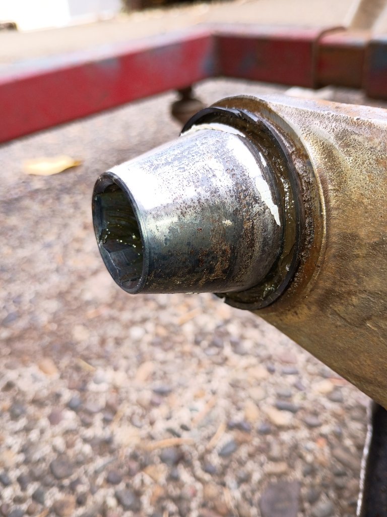

I just tore down the '89 K30 Dana 60 and found the upper kingpins to be slightly tarnished, or a bit of very light pitting on both sides, the area facing the center of the truck. Never driven this, it's from a parts rig. I can run my finger across the pass. side and it's undetectable, the other side is a bit rough, but still only affecting maybe 25% of the pin. I've got 2 opinions on this, and both say it's probably a non issue. I don't want to take it apart again, so would like other opinions. Do I leave it alone, and reassemble, do I replace just the upper pin and that's it? Do I replace the upper pin and the nylon bushing? ... which appears fine. The lower pin looks perfect, and the bearing feals fine, but I haven't removed it.

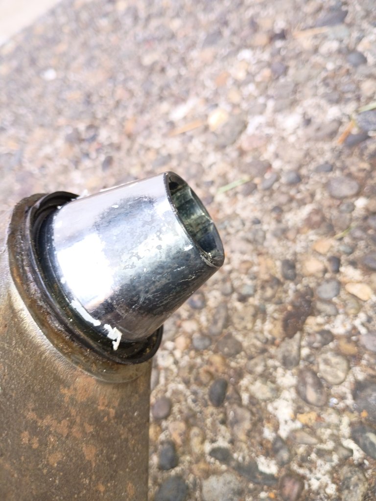

Here's pictures, as it's tough to address without them.......

I faced the same question only a month or so ago. I decided to leave them. I mainly looked at the 600 ft lb torque standard and the amount of damage (one of mine was slightly grooved) and figured (also based on some advice here) as a part time use truck it would be ok w new bushings.
Mine:

The surface in the one pic looks fairly rough but it’s not heavily grooved, etc. If it was a toy / weekend warrior type truck I’d run it. If it’s a daily driver I’d fix it.
35,426
44,736
Worst case, bushing life will be slightly shorter than with new pins, but bushings are easy to replace.
Exactly! WAY EASIER than 600ftlbs. lol
