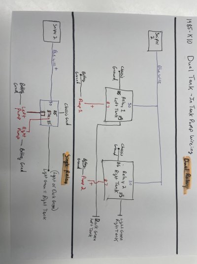

I think maybe I've got it now, does this sound correct?

Terminal 86 gets a switched constant power as long as there is power on 86. Power out is on 87a when 86 loses power,power out switches to 87.

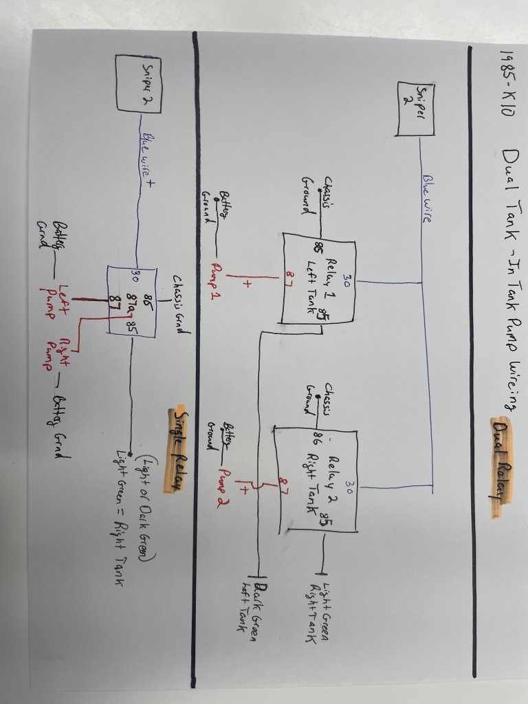

I think I sent this too you before. Use the dark green and light green wires as triggers for the relay. I think I actually have the left and right reversed in this diagram though. I think light green is left and dark green is right.

Go with the 5 pin relay. Toss the selector valve and wire it into your switch. Pin 30 constant power to pin 87a which should be wired to your left pump. Pin 87 to right tank. Pin 86 to ground. Because 87a and pin 30 are connected internally

Pin 85 to switched power,left out of the above post,without it the relay does nothing.It would just be a junction block. And I would not eliminate the selector valve.

Thats up to you. I switched everything to in tank pumps, because at some point im going to throw in a holley sniper 2 kit

Intank pumps is great, same way I'd go,but losing the selector valve is not a good move. That's okay you'll find out.
