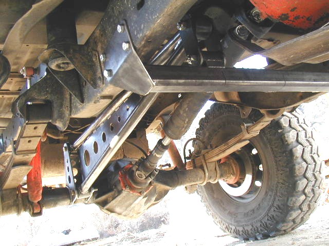

this is what i am thinking though, it should have the flex i need/want and fix the wheel hop

It's worth a shot, that design look's like it's not a total nightmare like some lol.

Looks like it's overkill, I like it. But I think the thing could be made with less height at the axle and do just as good.:shrug: The thing is to get no movement at the axle end.

yeah, the brackets in the kit are pre made, but for the price for all the bushings, johnny joint and axle tube pieces i could live with it, overkill? probably, but id like to be able to actually launch my truck, or not burn out 8'' at a time
