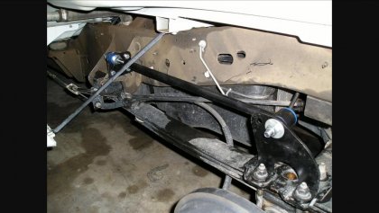

I could see somthing like this working. I could also see short ladder bars working. I made a set for an F250 high boy and they sure helped keep things planted in the dirt.

There's just something about that to me that just doesn't seem right, I just can't put my finger on it. I'm sure it would help out and you would notice a difference, but not to the same affect as a more common setup. Maybe I'm crazy..lol

True ladder bars that create a triagle are the best bet but The theory behind the setup pictured will offer a reduction in the axles ability to wrap the springs by forsing it to have to push the front half of the spring. There is no shackle there to swing so it must twist the spring more before it can move forward. There actually is a triagle there but the side composed of the spring is flexible.
these are almost exactly like what i have.
this is a link to the ones i have http://www.summitracing.com/parts/tfy-10795
they have helped, but but still not enough

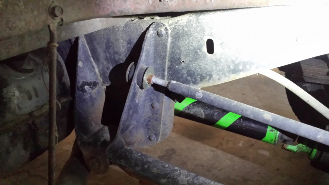

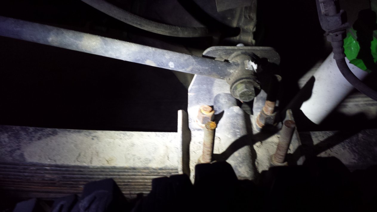

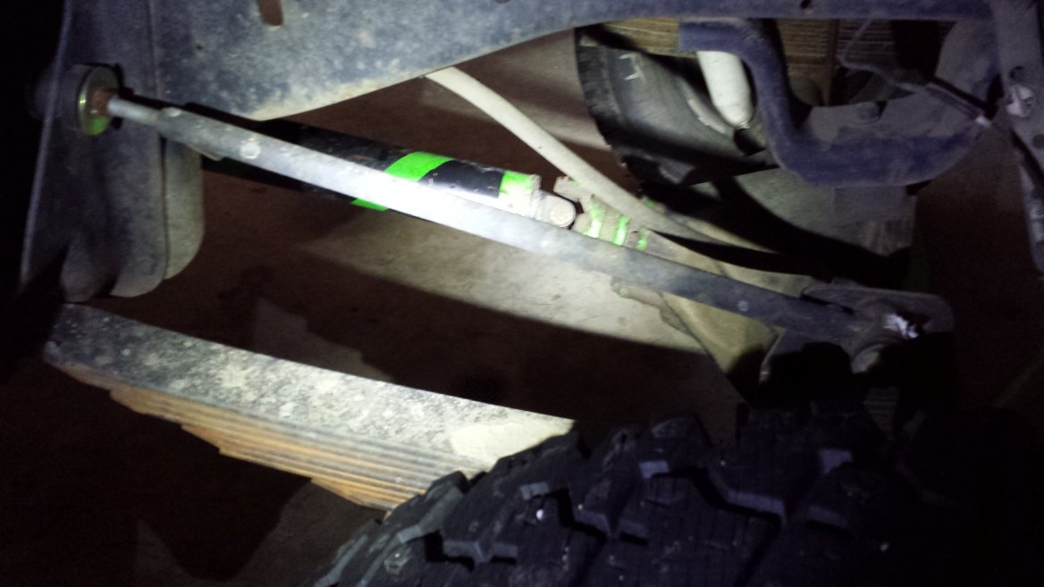

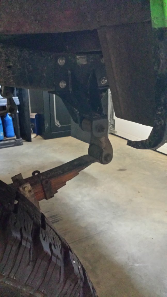

alright i Finally got some pics taken of my rear suspension stuff, i apologize for the cell phone pics
my front mount into the hanger is a little different than the one int he other pic

I don't see anything wrong with that. Those are the same type traction aids I used years ago. They work but they are a compromise. The one issue I had was the threaded end breaking from too much flexing. That end really needs some improvement. Like maybe an eye on the end of the bar with some kind of mount that is flexible instead of allowing the bar to flex inside the rubber bushings. It cannot be a solid mount for vibration and articulation reasons. I'm pretty sure that they built it that way as a deliberate weak point. To make certain the leaf spring did not suffer the same fate from too much flexing at the point of the axle or simply binding the axle housing movement.
What I do see is what I feel is too much pinion angle. That will just get worse when you accelerate and the housing rotates the pinion up (the pinion gear climbs the ring gear). Might think about getting some shims over the spring packs to bring that down some. Might consider sometime in the future buying a real driveshaft too. :) JMHO
i agree, the end of the bar is the weak point, it just has a threaded end welded to the solid bar, at the time, it was an affordable solution, ish. i made some other traction bars, before i understood how everything flexed and twisted, they didnt work, i have since cut them off and patched everything up,
as for pinion angle, yeah, i believe when i put the shackle flip kit on the back, it pushes the back end of the leaf spring down and pivots off the front hanger, pointing the yolk up more, going to do some homework on it and try to figure out what size shim to use.
what do you mean "real driveshaft"? this one has held up, when i had it made, i had them make it out of the thickest sidewall tube they had.
