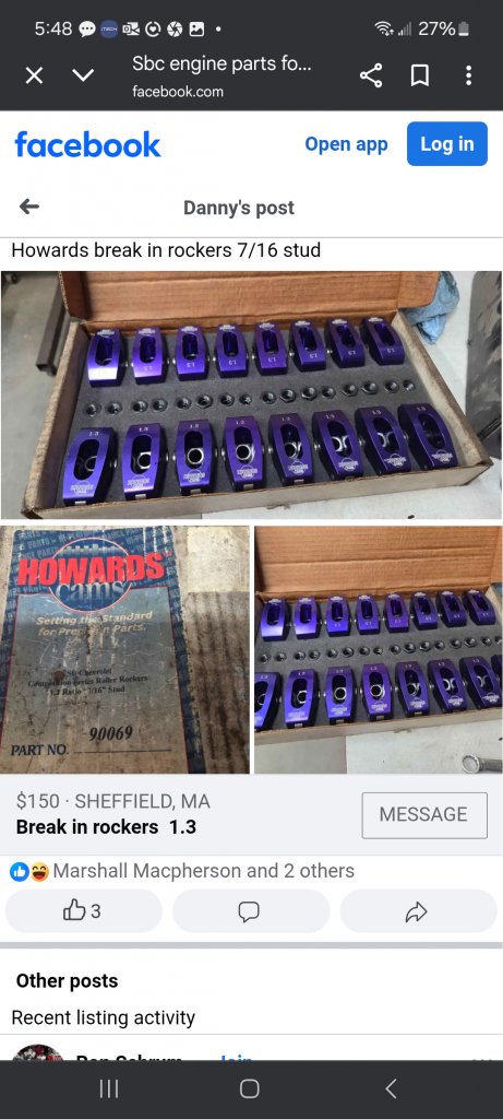

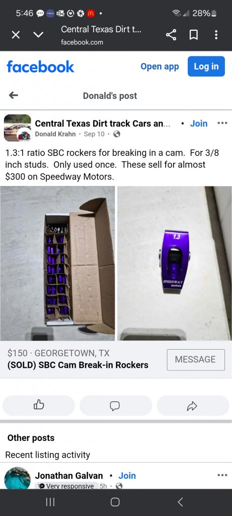

Break in rockers is the easiest route but at 3-400 might as well just go roller cam not everyone has the ability/desire to swap springs even though it is cheaper.
Seems going rate on used ones on face book is $150.00,one of you guys needs to buy a set for your next build then rent them to other members doing cam swaps.
Not worth it to me I've done 2 flat tappets in like the last 5 years everything has been OE roller or retros
