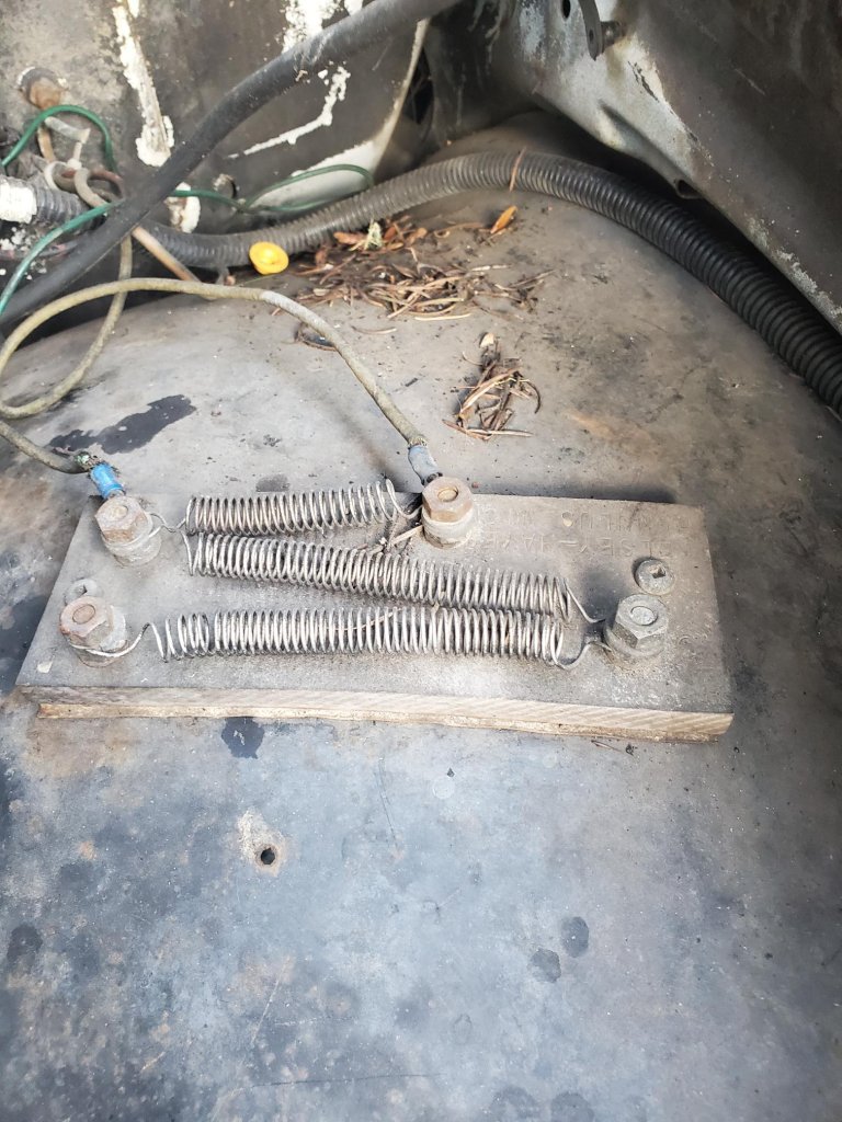

Can someone tell me what this is? It's on the driver's side inner fender well. I think I've seen it before but can't remember what it is.

That is a resistor for an electric brake control. You would see them on the older style hydraulic actuated trailer controller. The electronic type controllers can be dial set to lower braking.
