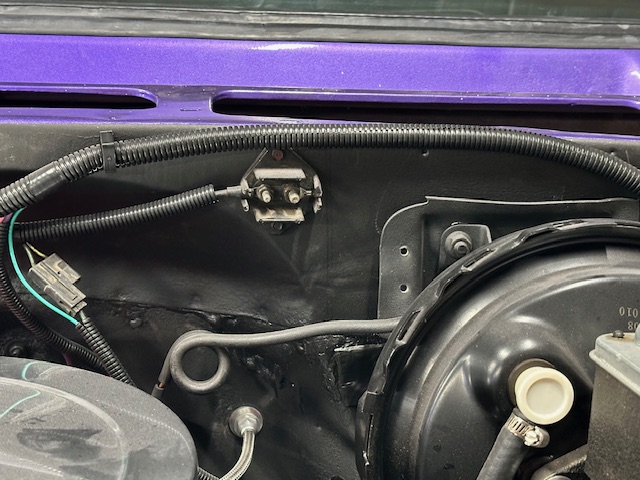

I rewired my 77 K10, but the kit I used didn’t have the new wiring for the AC/heat. I used my existing wire, which is what the instructions suggested. My problem is now the blower motor will only work on low speed. It comes on when the ignition is turned on but will not speed up with the switch. I’m using my existing switch, which worked fine before I started working on the restoration. What is this thing on the firewall and does it have anything to do with my problem? The wire on the left of this thing is part of the AC/heating wiring but doesn’t have anything connected on the right side!I don’t want to start changing resistors and relays unless they are bad.

The 2 stud block on the firewall is basically a power distribution block, it typically doesn't directly have anything to do with the HVAC.

It's definitely a bus bar for power...
Several of the ones I have see though have a wire with fusible link going from the right side down to the bulkhead (backside of the fuse block) on the firewall.

when I removed the old wiring, there was a wire from the right side of this block that went inside the cab and connected to a resistor type connector mounted to the steering shaft. From there, 2, three wire bundles were just laying inside the dash not connected to anything. From what I found searching the internet, they seem to be made for the rear AC/heat on a suburban.

Actually, one fused wire from that block goes to the input side of the HVAC fan relay.

You can run a jumper wire from the 12v supply(red)from the relay to the blower motor. If you get high speed on your blower then, it's probably the relay. Also inspect your resister to make sure none of the coils are burned in two.

I don't think so. If one speed has power, the resistor seems to be getting juice. Whether it is distributing through the various values to give the speeds seems the problem. But no high speed seems its own problem.

Actually, that block provides juice for the high speed position for the blower fan. I’d suggest you also look at the wiring schematics to assist you in the wiring and also understanding it. There’s a red/orange wire that goes to the relay that is attached to the AC box
