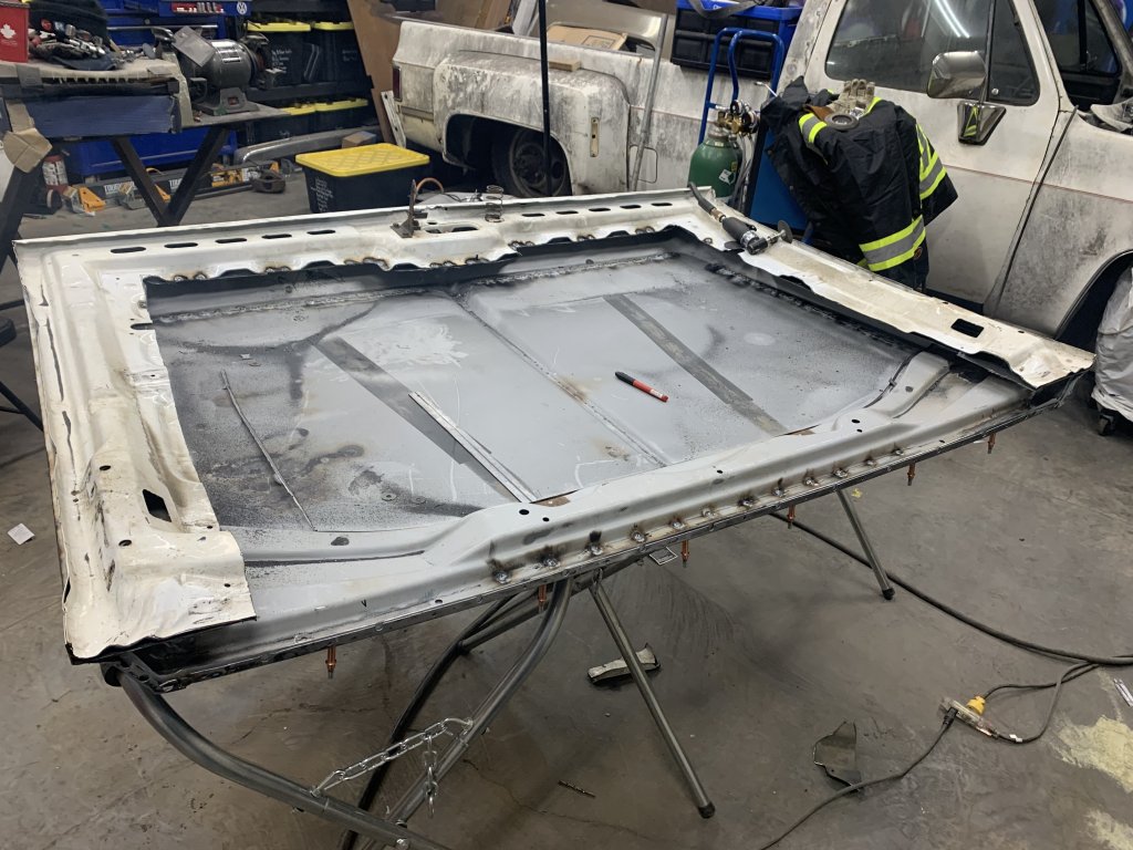

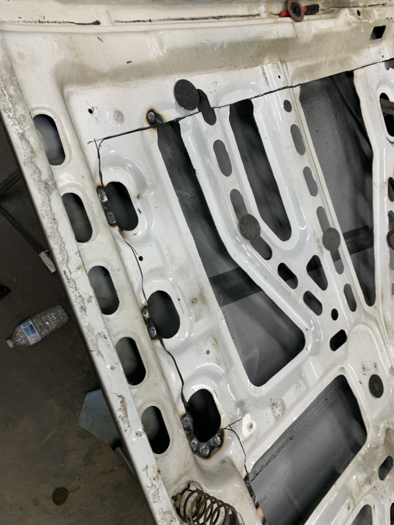

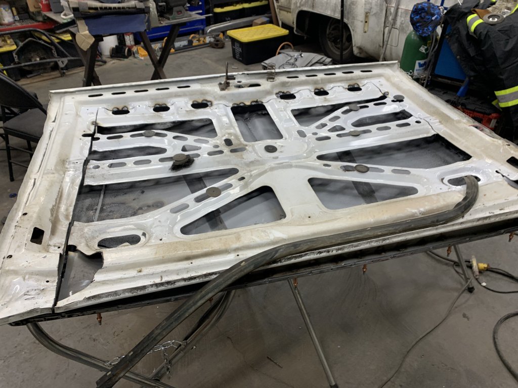

Still doing hood mod, starting the other side now

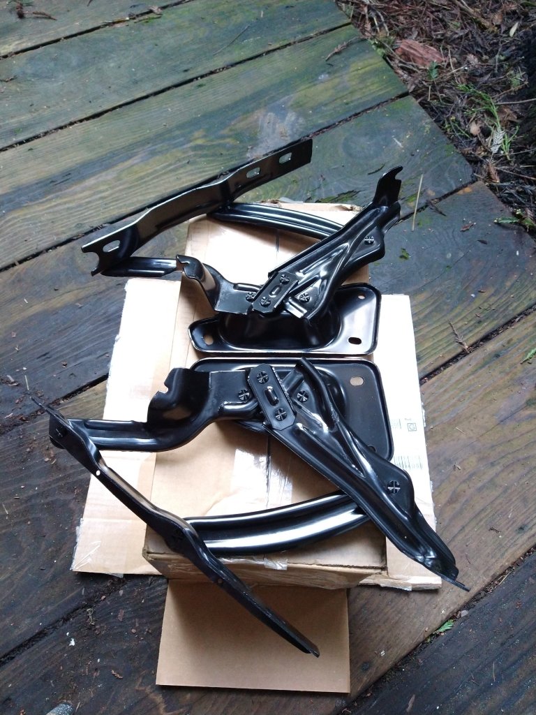

New to the list.. my hinge set has arrived :) was worried they would be robbed in LA lol
Install tomorrow..

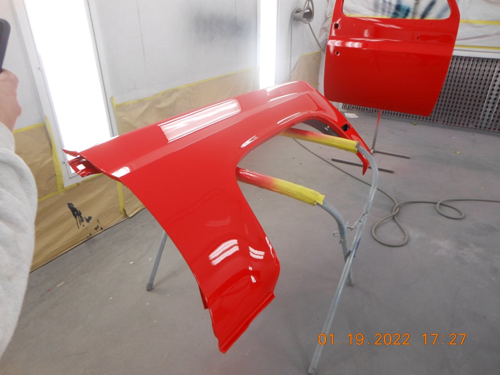

I am winning! The cab is finished, 4 coats of color gm8774 on top of bright white sealer, 3 coats of clear, last coat blocked out with 800 and final clear coat. Fenders and doors, same treatment ready for 800 blocking of clear then the final coat.
p.s. and the chopped studebaker coupe

Good job, looks awesome! The door paint racks did you make them? Picture of the other side plz!
9,559
17,538
Yeah you’re definitely winning! But you’re cheating… that there is a professional body shop!
Jk. Looks awesome!
Question about the clear? You can’t see 800 scratches in the final coat?
I’m not a great painter but that seems like it would telegraph through?
waterpirate
Jan 2, 2019
1,336
3,588
delaware
v10
5.7 tbi
Blocking the clear with 800 just levels out the last of any orange peel or imperfections, makes it like glass. No it will not show in the final coat.
Door racks were custom made to paint whole door at one time. Just stock tubing welded together. Will get you some pics of the feet and arms next week when I am back at the shop.
9,559
17,538
Thanks for the tip. So it's an extra step during paint, but saves the cut and polish after wet sanding the top coat instead. (Assuming I can lay down a last coat without any dry spots, lol)
