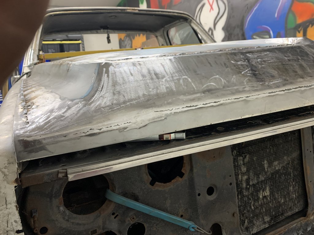

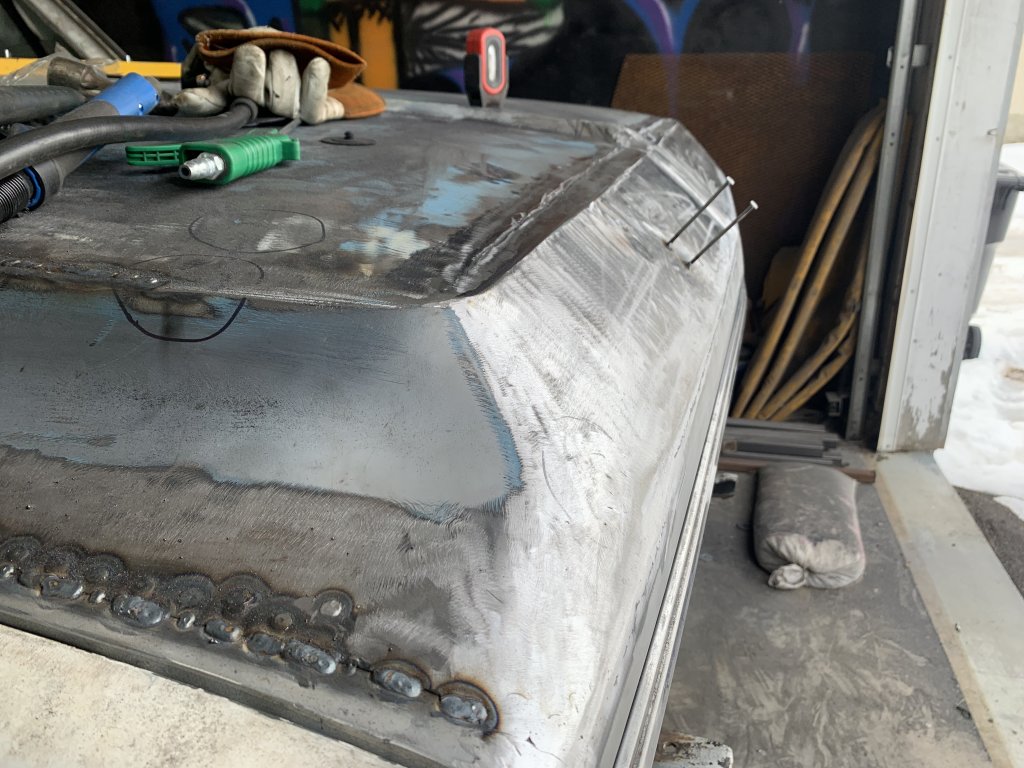

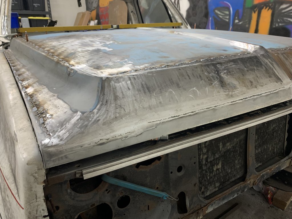

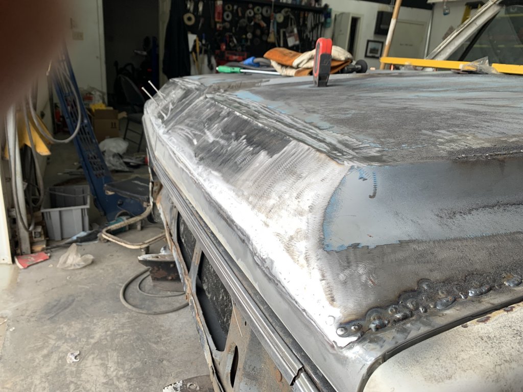

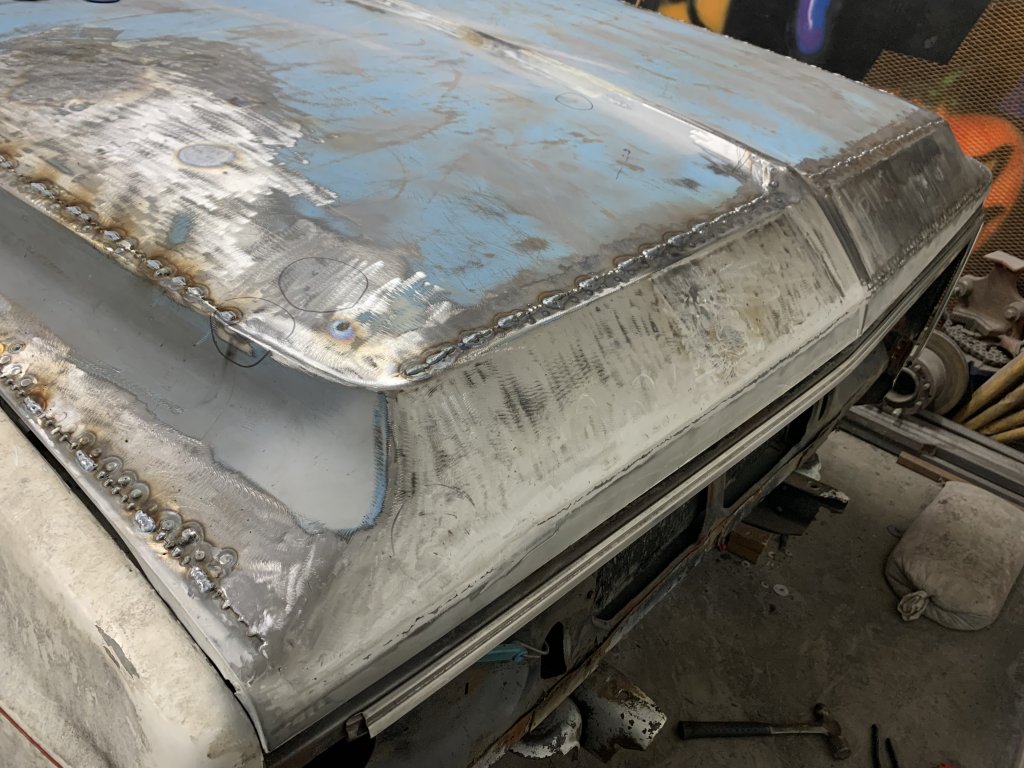

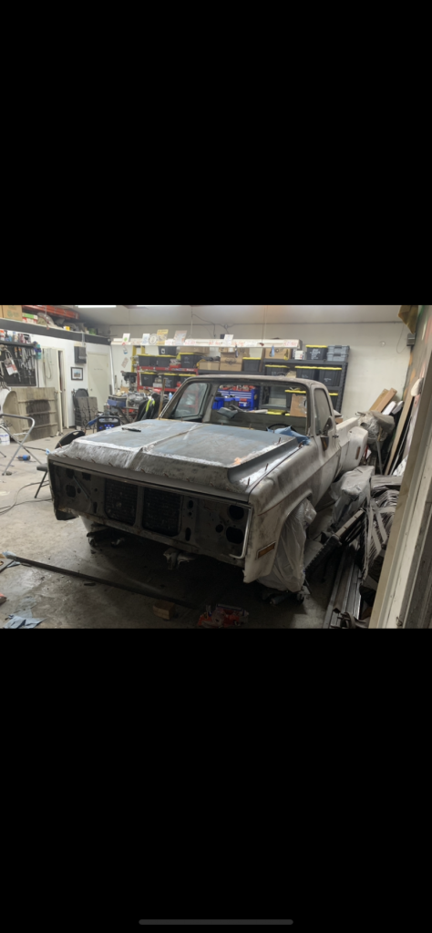

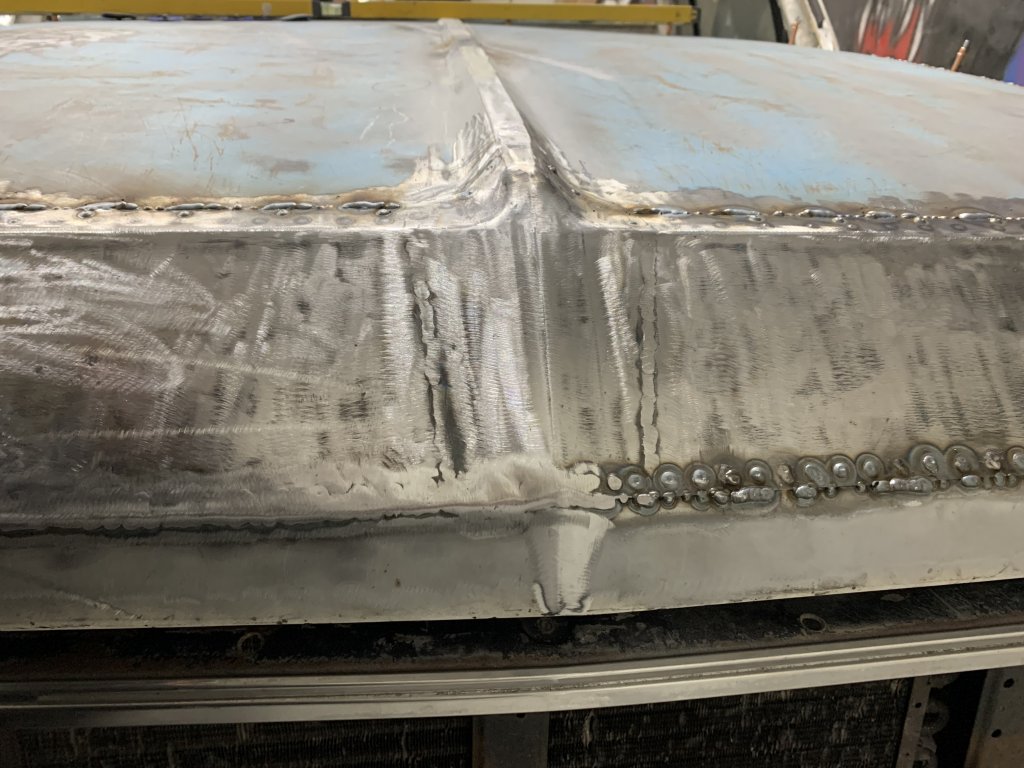

Slowly working the hood mod, It’ll be just a skim of body filler I think…
Is this fictional and for appearance of just appearance? Looked like that would provide a few more inches to clear a taller carb setup as well

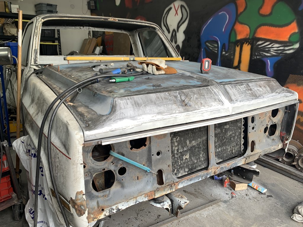

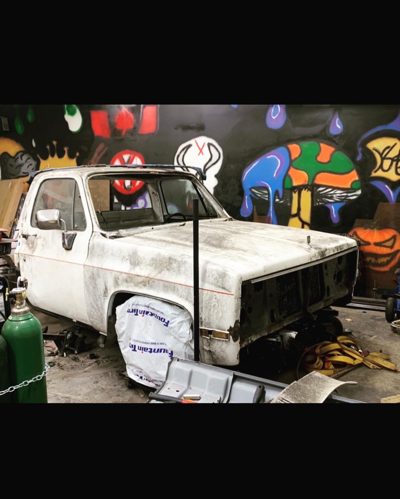

It will be able to accommodate a taller carb setup, but not just yet, I’m 80hours into this mod, had to prep the original structure of the 81-87 hood to be able to accommodate the 67-68 hood shell, it will incorporate the 67-68 rear hood arch support, possibly a portion of the front as well but both heavily modified to fit, I’ll be sure to update as I go and if someone like yourself is interested answer any questions… I’ve got the majority of the build pics on “Stormin Norman” feed
