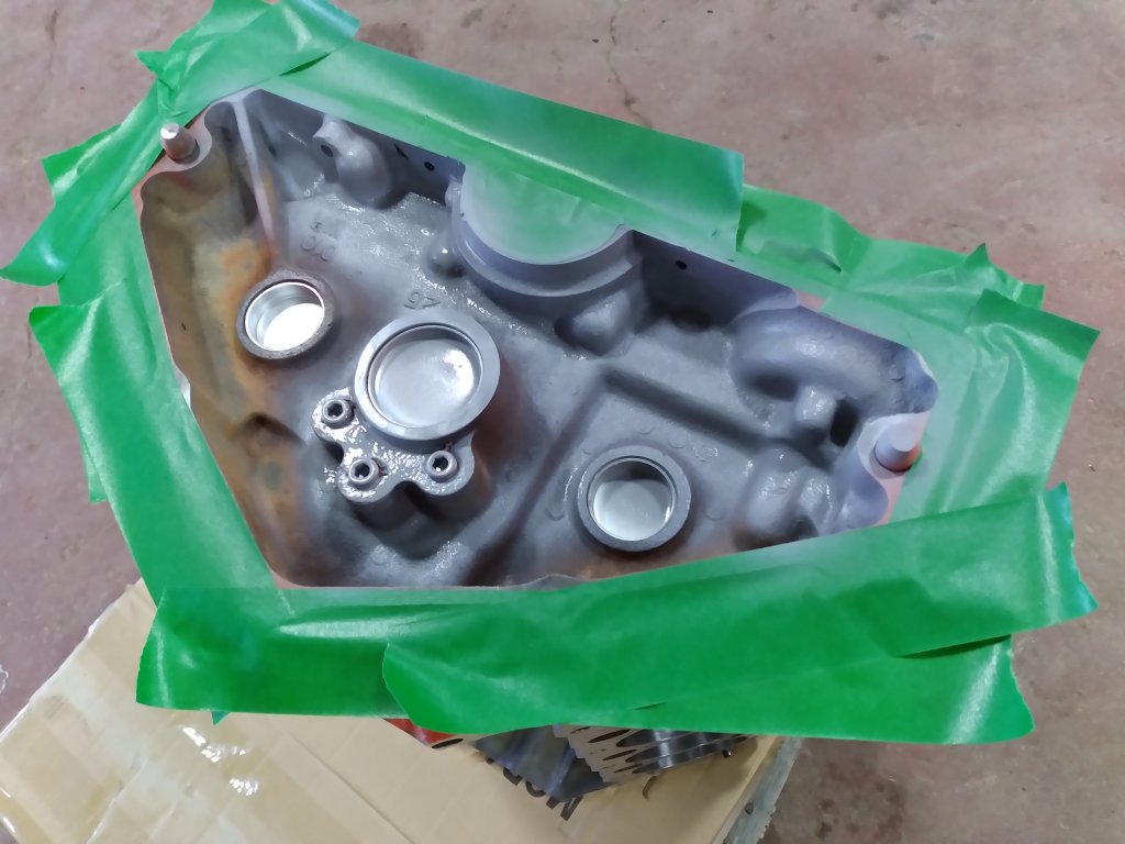

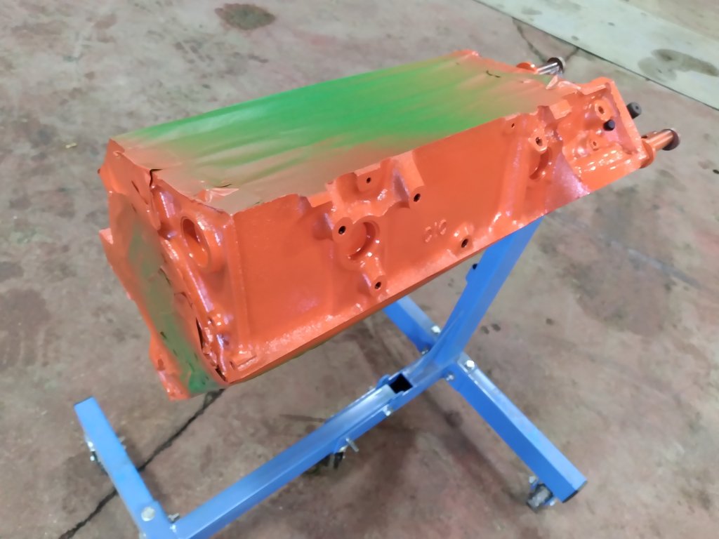

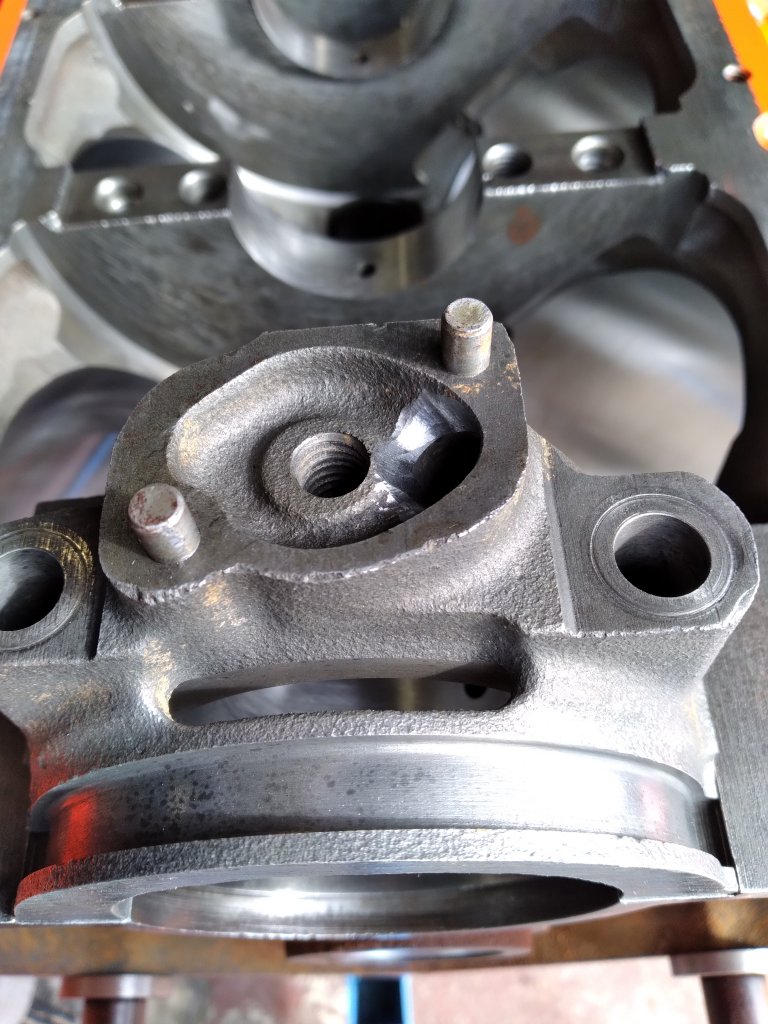

Block is back from the machine shop.
Tanked; fluxed; line bored; cylinders bored +0.030"; decked 0.010" and cleaned again. The lifter bores have been grooved for extra oil to the camshaft; all the plugs are in and the oil hole for the oil pump has been lightly radiused.
Painted Chevrolet Orange (what else?) with VHT-brand paint and painted the inside at the rear of the engine should I ever need to inspect and look for any leaks (there better NEVER be any!)
