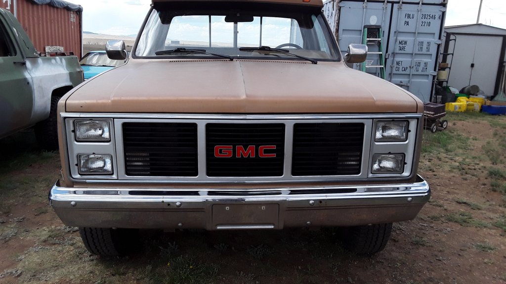

Got my first square a couple weeks ago. Grandpas old truck that hadnt been started in 10 years. Working on getting her running good and small mech things till I address the body issues
