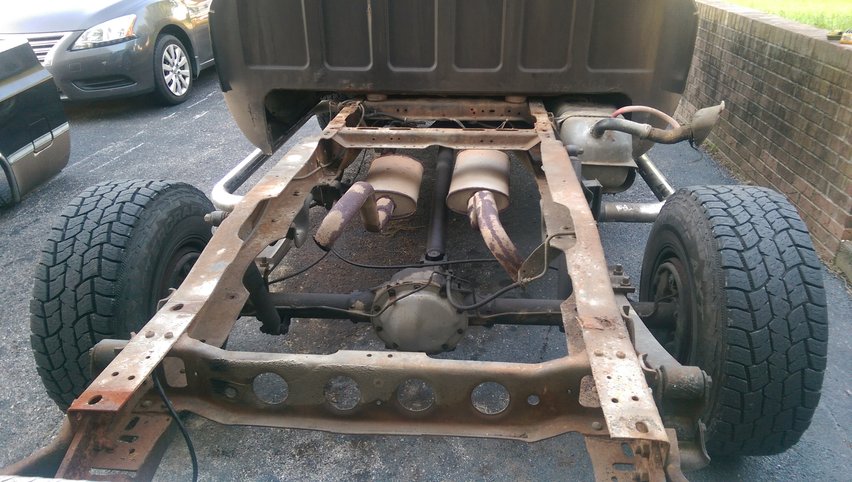

Buddy cancelled fishin trip.....so ive got the bed off to mount the 31 gallon tank this weekend.

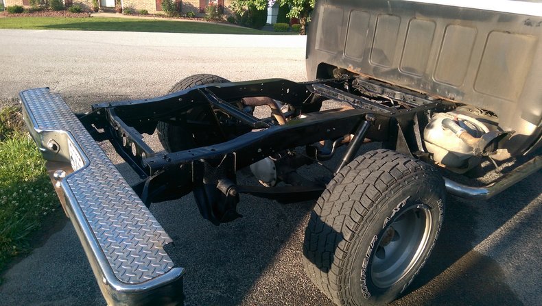

Relocated the rear frame crossmember and welded old tire support in place to stop the tank from rising. I'll install the strap cross member closest to the axle when i go to install. I won't be using it until the 5.3 is in. Current tank is on the passenger side only. I'll run fuel line along the frame if I have time. Waiting for it to dry to put some Harbor freight chassis and grill paint on the ass end. I wanted POR15, but not in the budget right now. LOL it aint gonna look pretty.....but should be better than what was on it.
Do your drill bits a favor, use four bits increasing up to 7/16" when you get drill out the rivets. And drill a few rivets with the same bit before you change it.....saves drill bit change count.
